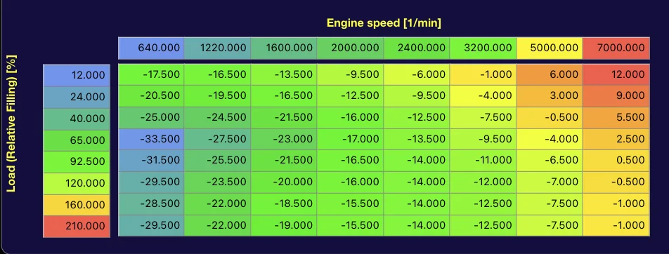

For informational reasons, this the floor for how much ignition retard TC can command:
