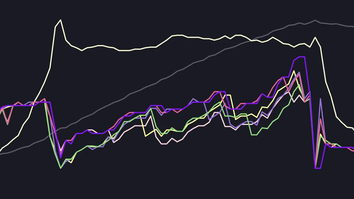

Good morning everyone, finally got the install done and took some initial logs. I would greatly appreciate some input and thoughts on what I might need to start changing. The pulls felt ok I could tell it was not happy with something as it felt stronger overall on map 0. Thank you for your help!https://datazap.me/u/thatpartsguy/2026-supra-6mt-initial-logs?log=0&data=1-4

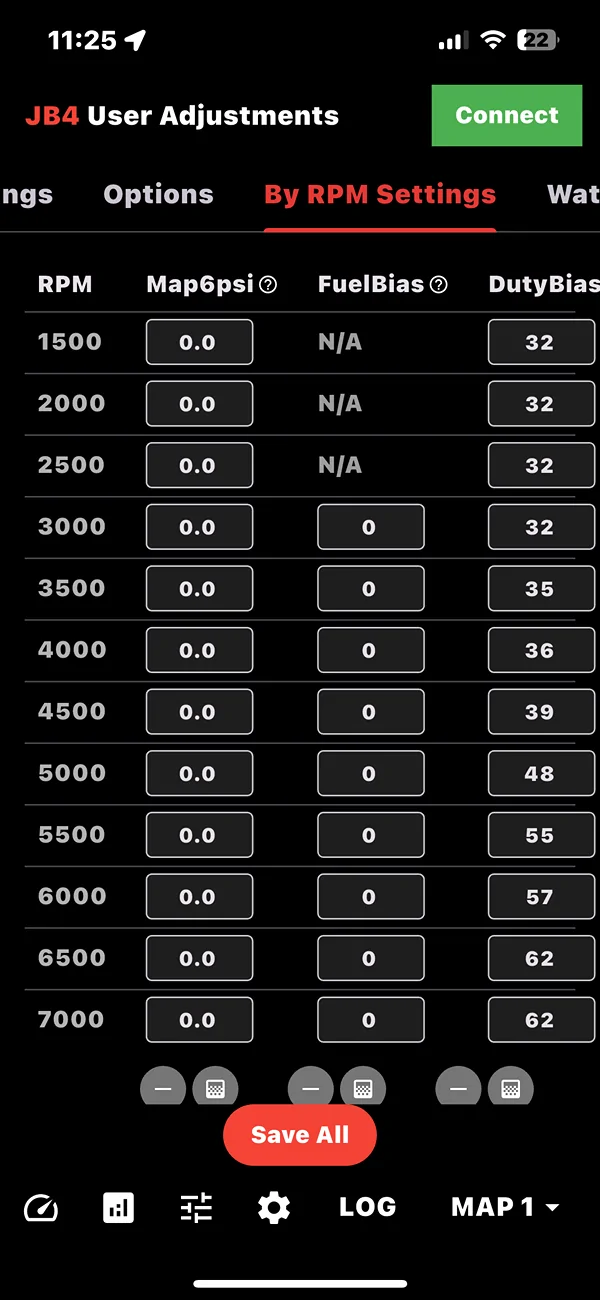

Having a go at it myself I have continued to lower FF and Duty in pursuit of no closures, ECU PSI below 16psi, and Calc Torque below 48
I want to keep chasing ecu psi but is it ok to have such low FF and Duty 3k and lower? Is it normal for the boost to peak then dip so much? It seems like I've taken some steps forward but with not much lower to go on duty and FF I don't know what to do. Since the throttle closures are minor in the most recent pulls should I worry about it? I rarely put my car in a pre 3K rpm Wot situation.
Hot day pull, no throttle closures, ecu psi still high
Map1 FF5 10/10/7/7/20/20/39/48/55/57/62/63
https://datazap.me/u/jtignor/map1-ff5-1010772020394855576263?log=0&data=1-2-4-8-9-13-20
MOST RECENT
Did some more pulls when it was slightly cooler and ran into throttle closures again. I lowered Duty some more and still seeming to struggle with closures and ecu psi.
Map1 FF5 7/7/5/5/25/25/34/42/51/57/62/62
https://datazap.me/u/jtignor/map1-ff5-77552525344251576262?log=0&data=1-2-4-9-13
No longer attempting
Also played with some Map 6 additive to taper boost before 3k rpm
Map 6 3 psi FF10 Duty: 10/10/7/7/20/20/39/48/55/57/62/62 Boost: 2/2/2.4/2.7/3/3/3/3/2.5/2/1.9/1.5
https://datazap.me/u/jtignor/map-6-3-psi-ff10-1010772020394855576262?log=0&data=1-2-4-9-13
boost control isnt bad, you can add a bit more duty to 3500 to fix that torque dip, but otherwise your main issue is lack of octane. Good bit of timing corrections
you can try IAT spoofing higher to see if that lowers the base timing, like 130. or any ethanol/octane booster at all would fix it.

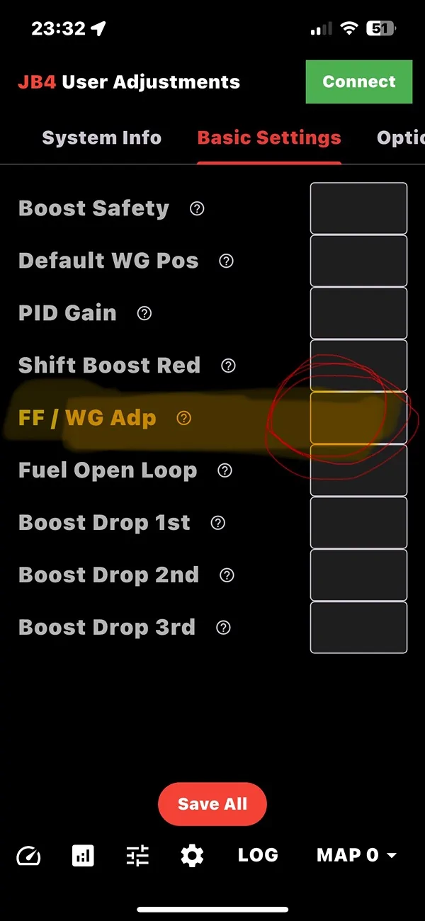

If I change FF in the tuning section does it change globally or just for map 6? Also in your guide you recommend to set boost failsafe at 23 psi, it seems in my settings I can only set it up to 20 psi.
All settings excluding the slider bar settings are global.
I've had problems with failsafe saving a desired PSI as well, try some random decimals like 23.1 or 23.4 and see if it helps.
FF is saved per map, so save it to whatever map you intend to use.
Should allow down to like 21-22 psi minimum, maybe it is an app glitch
