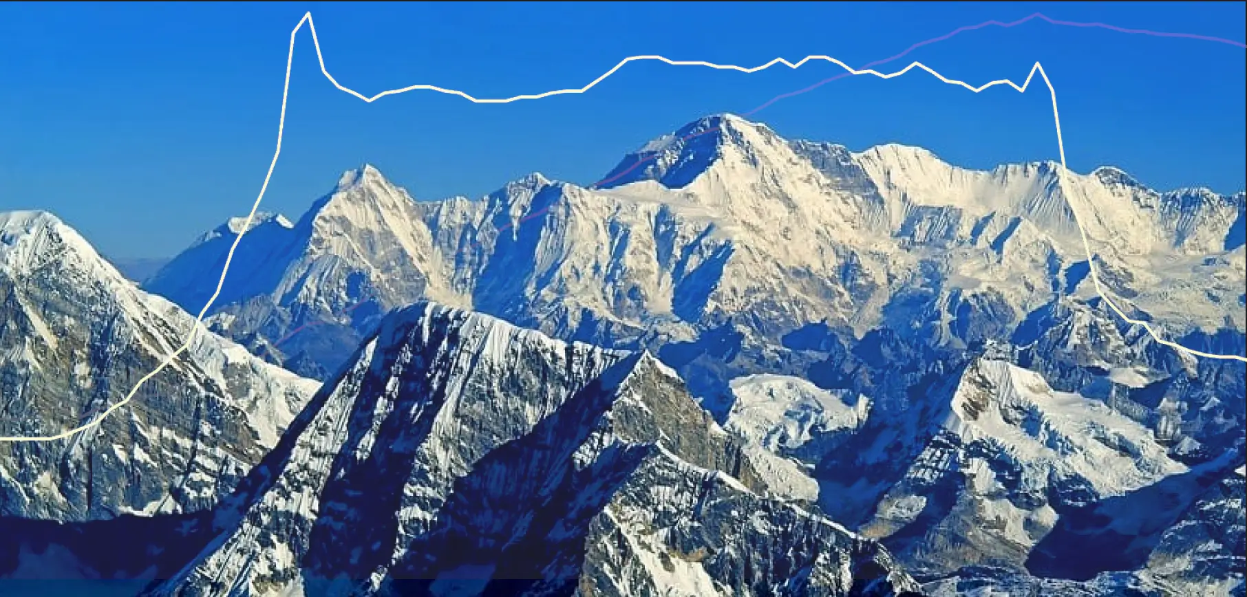

If timing is horrible on map 1, what can I do to improve that? Fuel is 91 and I added VP octanium booster to 93ish, but even if the booster doesn’t do much you would think I get a real 91 at least 😂
Lowering boost on Map 1 —> Map zero 🤦‍♂️
MK5's especially on JB4 respond rather poorly to 91 and octane boosters don't seem to help much.
Burger likes to over-promise a lot given they advertise map 1 as being practically made for 91 (such as suggesting a easy 100 HP gain even though to actually get that much over stock dyno numbers you'd need to run downpipe + E50)
As I stated, either lower boost or raise octane.
JB4 is basically just a boost controller. There is no direct control over timing or fuel. So you have to work within those bounds.
91 will always suck with a JB4 because of this reason. Trying to run more boost with high timing target and almost stoich AFR is just insanity.

Driving 70 miles to fill up doesn't really sound sustainable in the long term. You may need to just build a map 6 that targets +2 psi. Your log has map 1's target vs rpm. Just scale it down.
Won’t do this every week ! Just to check if timing will be better with supposedly better fuel. For science! 🤣
But yeah map 6 with + 2 psi could do it for now

Map 1 is fine to use, corrections are pretty minor. I'd just drop Duty 2500 and Duty 3500 by 5 for those big throttle closures.
Truth, especially on 91 ACN. Targeting lambda 1 with 10+ degrees advance is asking a lot even at stock boost levels. I don't even recommend JB4 if that's all you have. 91 non-ACN is marginal on Map 1 as you've seen.
of course there is the option to IAT spoof at 130-140 which will lower base timing, run slightly richer lambda, but I know how you feel about that ;)
