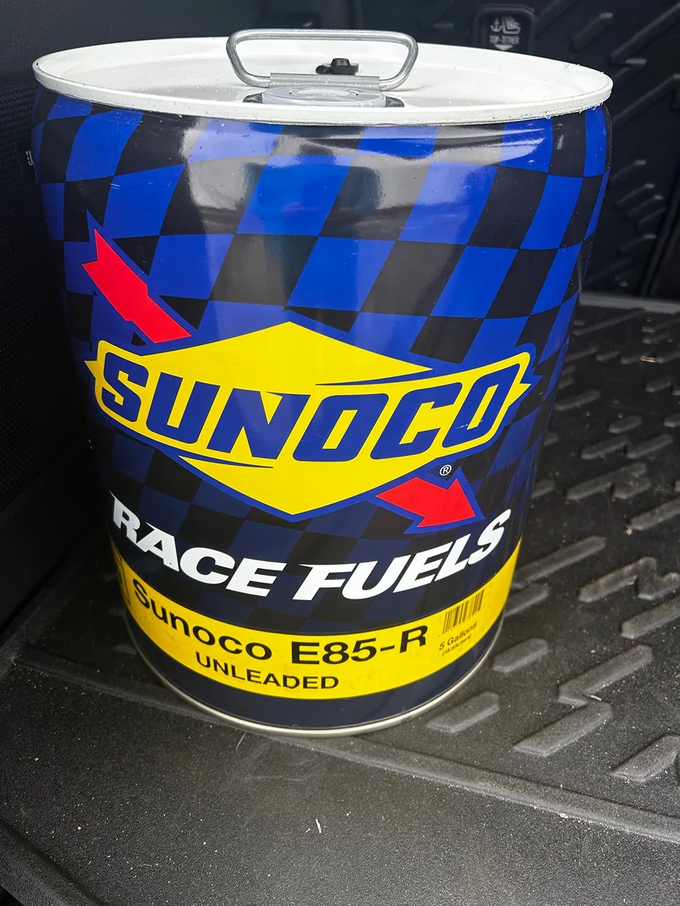

Timing looks great on both logs. You can turn it up more if you want, but personally i would try using slightly less E next tank and try to strech out how often you need to buy e85 cans.

Man I don’t have any merit, apart from buying E85-R to make ethanol blends to follow advice from the guys on this thread, all the merit is for them!
