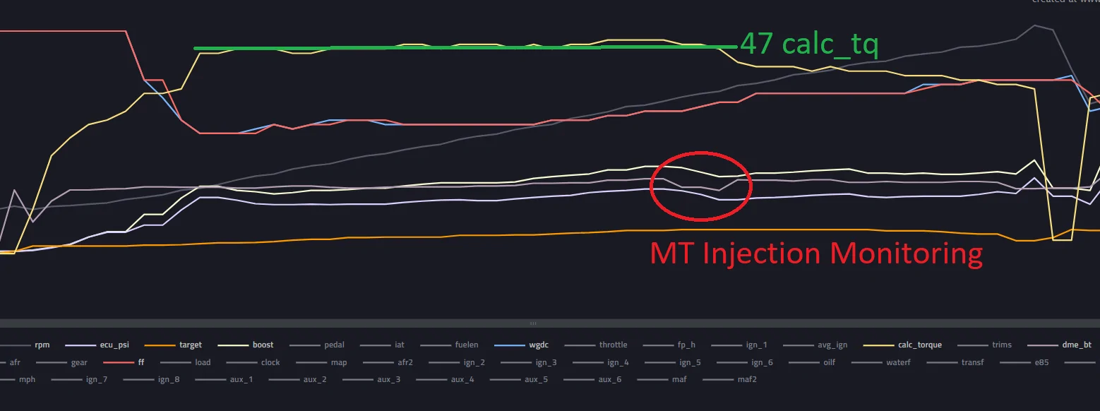

Heres a good visual (i think) of getting MT cars to work right on JB4:
Reduce duty bias until calc_tq stays below 48 to prevent triggering "injection monitoring", where the car will pull boost if it thinks its using more fuel than it should. This car needs a reduction in duty5000.
Too low can cause an underboost limp mode, harmless, but you probably reduced FF or duty by too much. you want as high as possible while keeping calc_tq under 48
