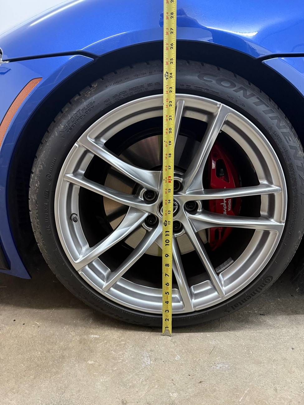

Do you know if the drop is different for manual transmission with the euro spec?
This is the drop for the Euro spec with a manual. From the floor to the middle of the fender is a little under 26.5".
