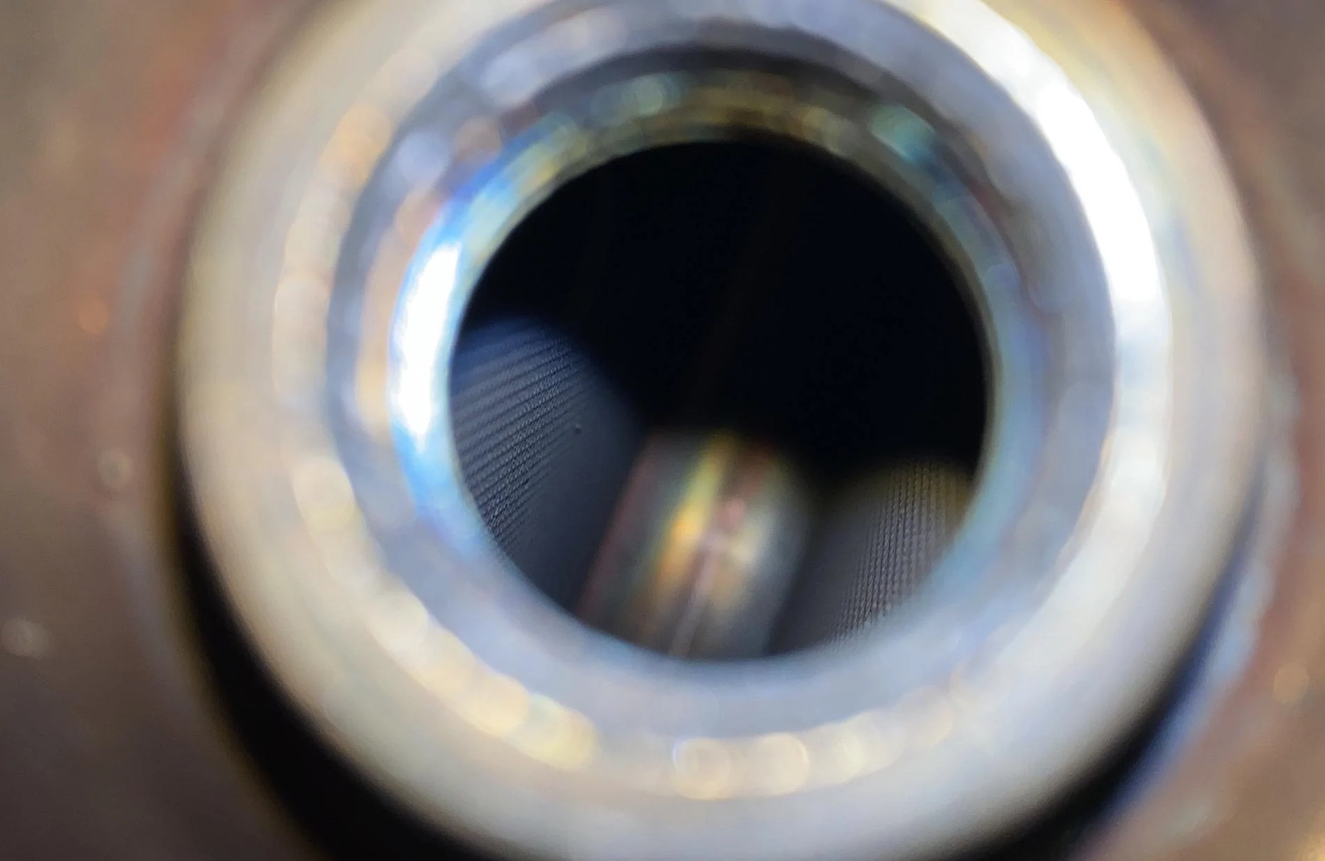

Nah I’m talking US spec cars too. If you look in a stock downpipe, there’s a catalytic converters between the upstream and downstream O2.
There’s also a second one after the downstream O2 within the downpipe body. I figure that’s there to just further reduce emissions even though it’s efficacy isn’t being measured by the ECU?
there is only one CAT in the US spec Downpipe

This is an ME spec Supra with no OPF
You can clearly see two cats as mentioned by @satindragon
Well then i stand corrected. Never opened or looked inside, just figured it was one not split
