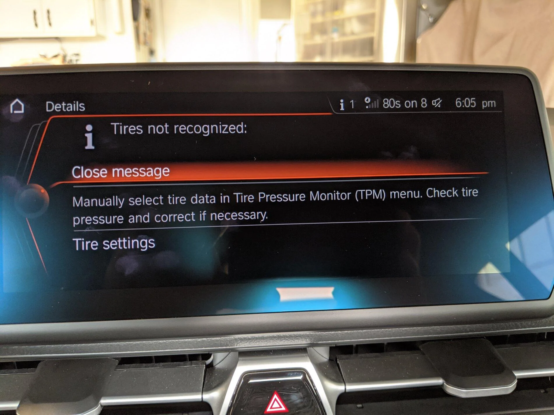

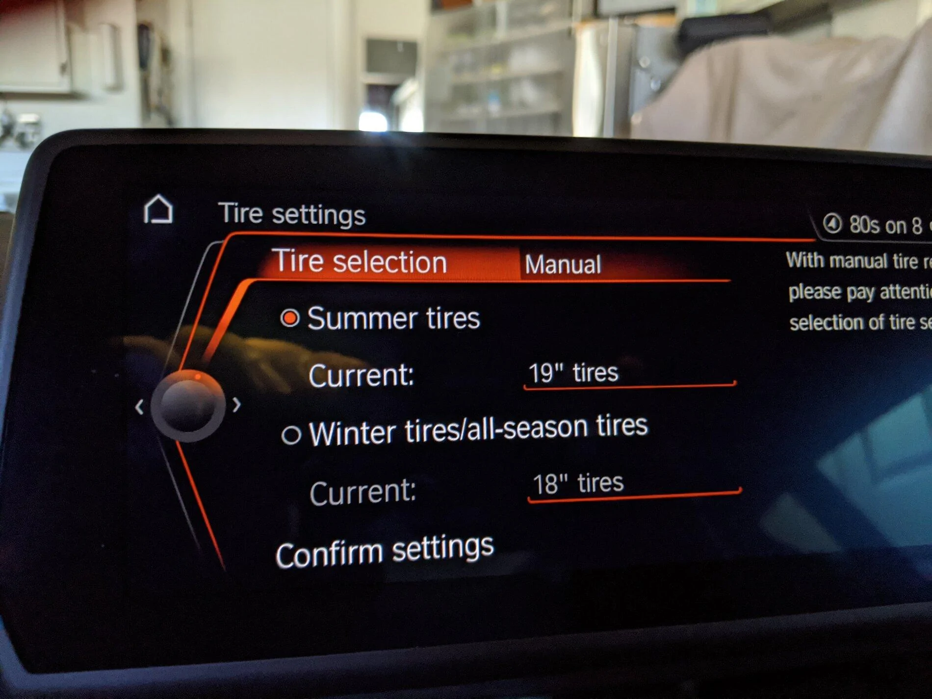

Just happened to me. I tried re auto recognize on the way to work but there was too much stop and go traffic and I don’t think it helped. Manual mode still reading pressure and temp fine. When the message came up I was confused, very random. Will have to look into it later

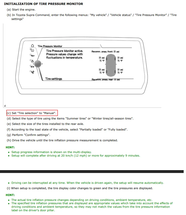

I had to do that when I switched it to LE wheels /w replacement TPMS. TPMS need to be registered /w the car at least once. set it manual, run the reset, and it should be fine.

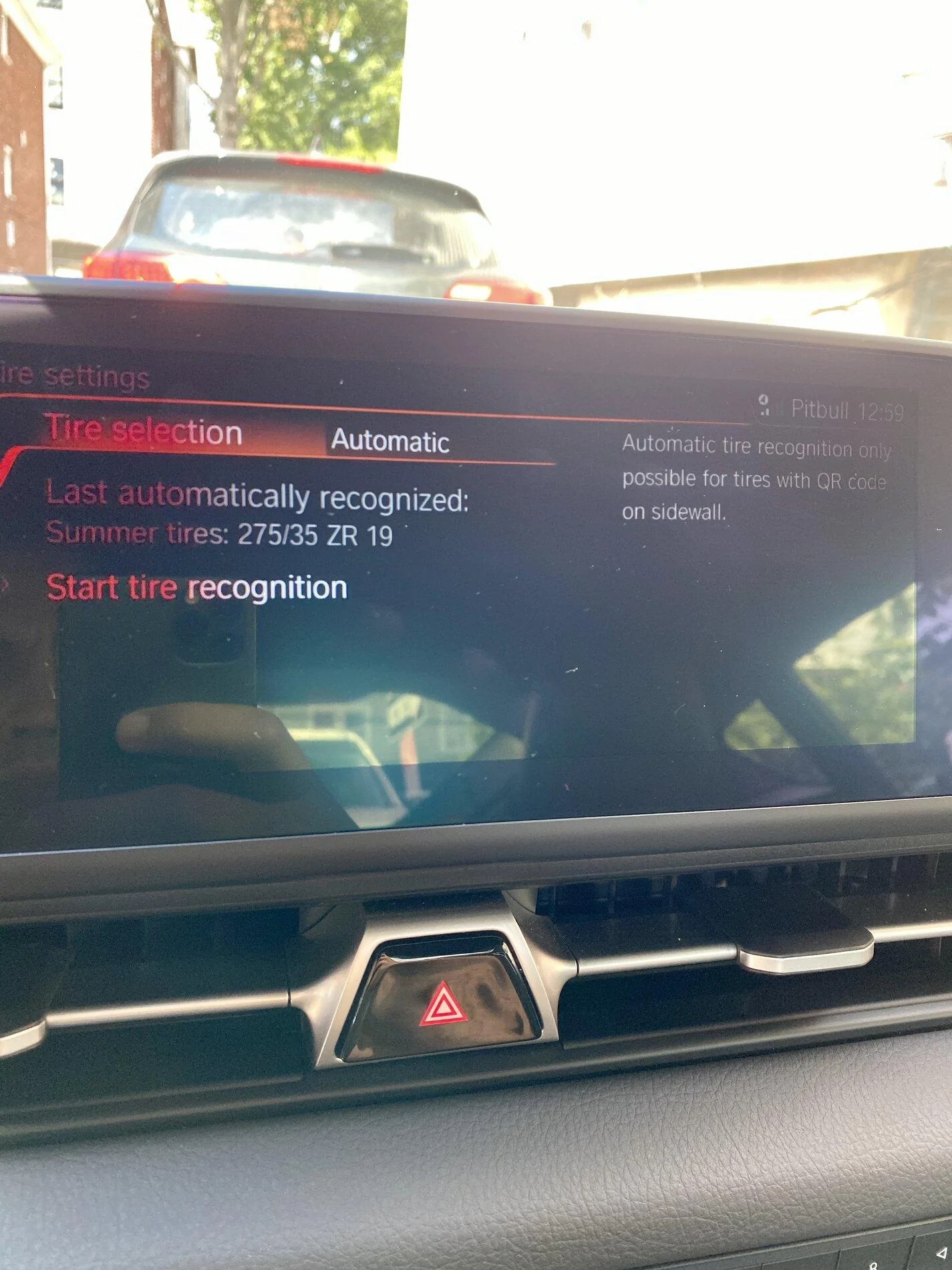

First time I swapped out tires, I almost freaked out. I couldn't get the car to recognize the new tires. Nowadays when I swap them, I just drive on the highway 10 minutes and let the car sort it out. I found out that city driving won't work, it has to be constantly moving, like on the highway for it to work.

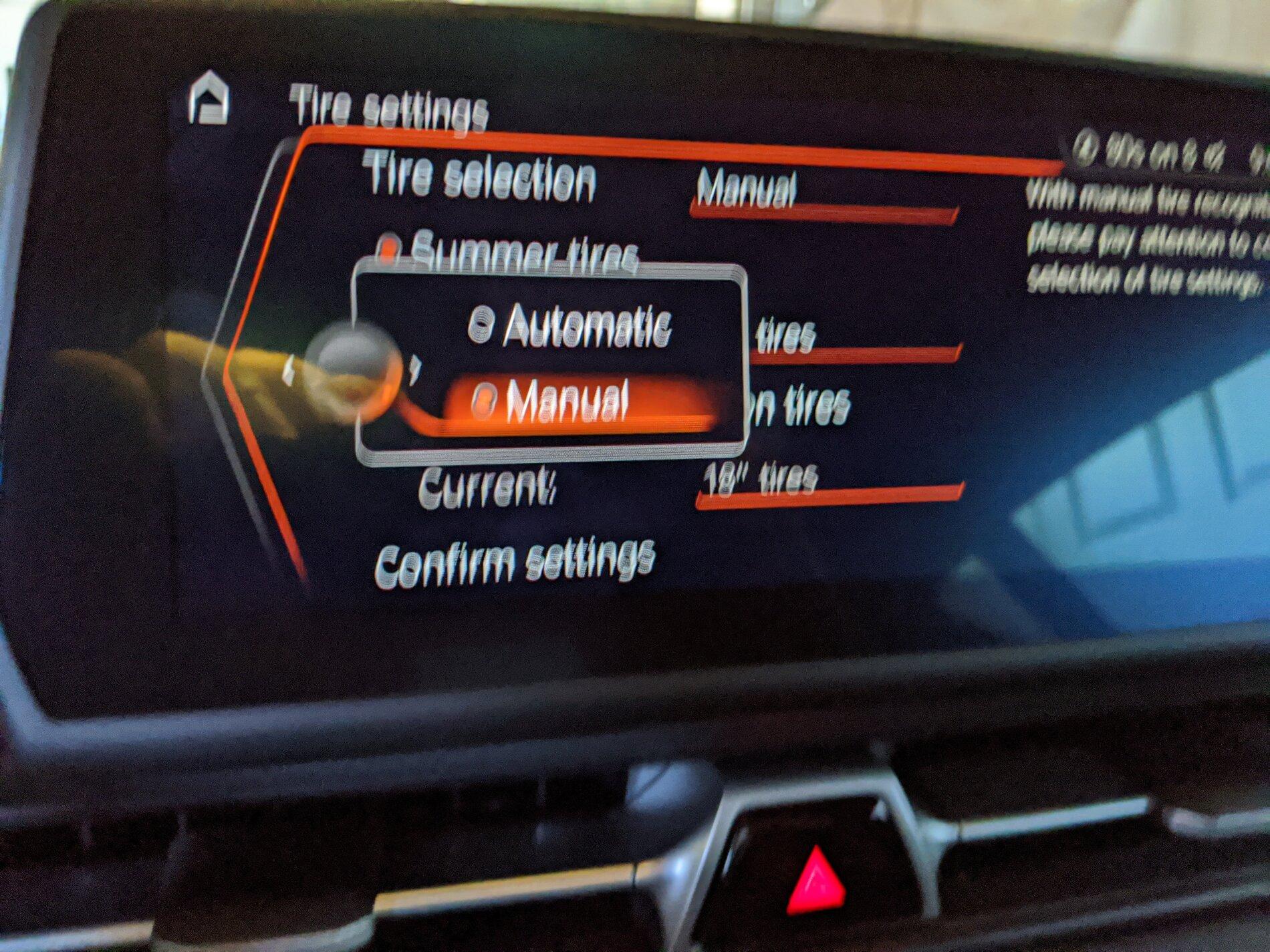

Gonna add on to this thread, so I have 275/35-19 front and 305/30-19 rear, Falken Azenis RT660. Running TE37's 19x9.5 and 19x10.5. I transferred over the TPMS from my stocks to my new setup and I've been getting tires not recognized ever since. It reads my tire pressure, and I have it on manual but hate that notification everytime I start the car. I've done the reset many times and driven on highways, it gets stuck at 99% for like 5 minutes then says tires not recognized. Really want it to be on auto, what's the fix? Attaching picture for clarity.

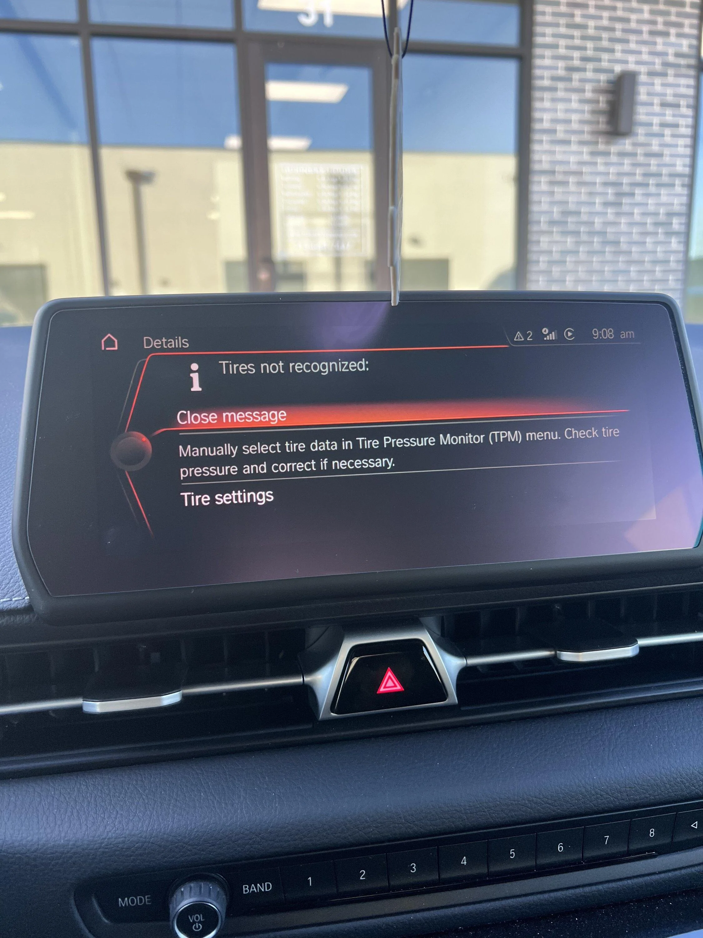

I am also experiencing this rn...battery needed to be jumped because it was cold out/radar took some battery juice and havent driven after my surgery but got in and tried resetting it like 10 times but still not recognizing after stating "Tires not recognized"
I saw this in the service manual and it doesn't state anywhere on how service can set it up for automatic. Any fixes or things to tell toyota service?
