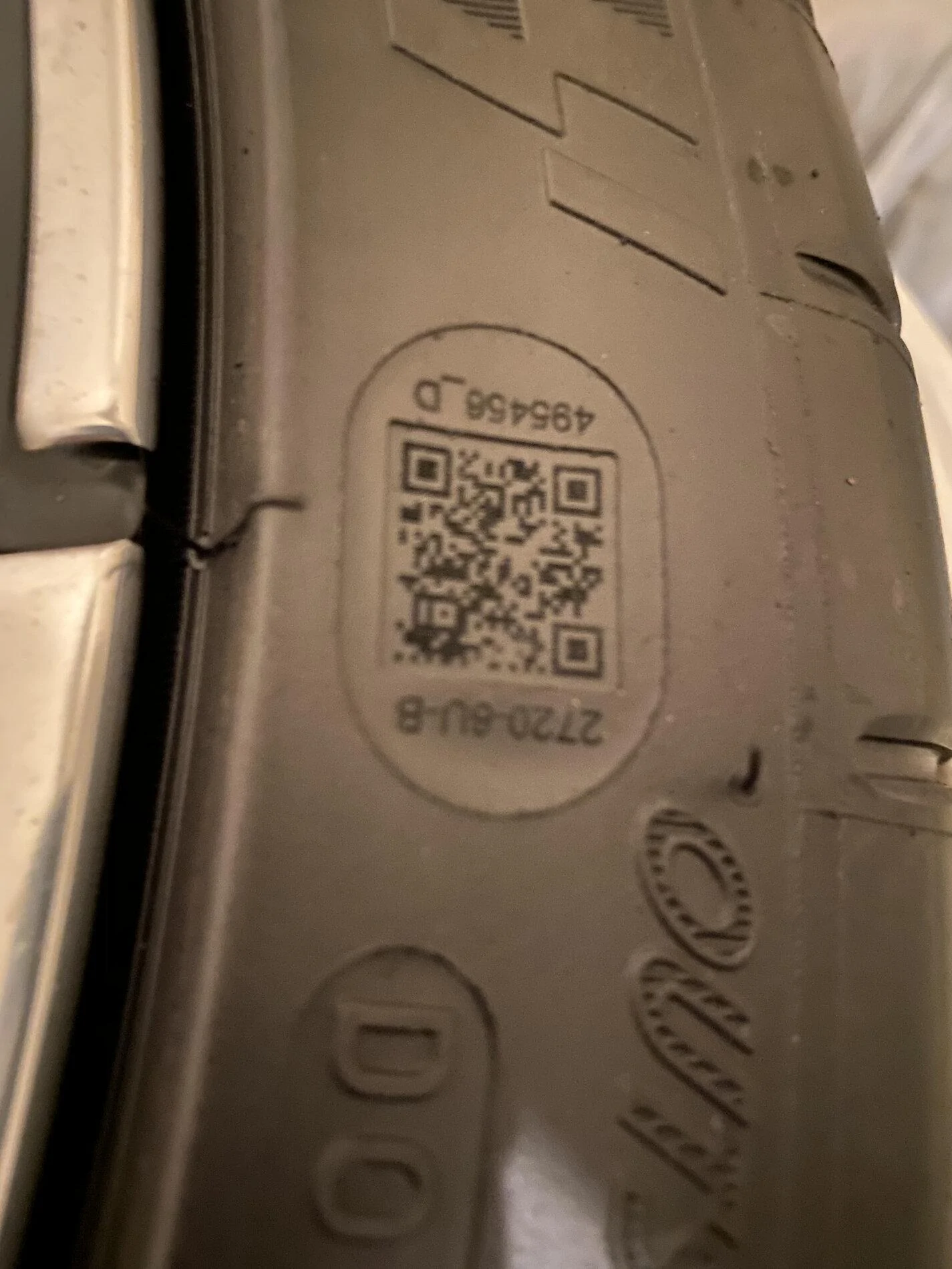

Here is the QR Code from the sidewall on the OE Pilot Sports. We need to see if the peeps running Michelin Alpines for the winter weā€™re able to engage ā€œautoā€ recognition. No QR code on my Goodyear Eagle AS.

Thanks much for posting the QR code. It helped lots to know what I was looking for..... after checking it.... YES, I confirm that I do have the QR codes present on my tires. So not sure what is going on, maybe I'll have to wait until there is an aftermarket RDC tool or meet someone that has one.

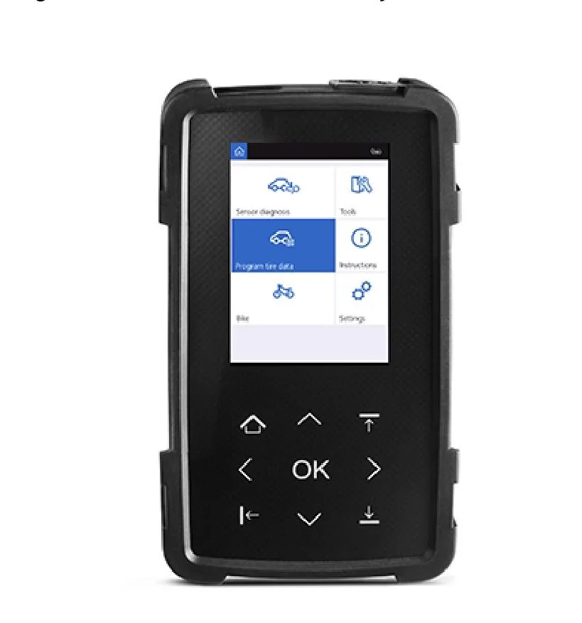

This isnā€™t a TPMS sensor issue, but an eTIS (intelligent RFID Tire) issue. Via the Texa RFID tool, the QR code on each tire is scanned to register the position and pair the RFID sensors to the car. They then communicate with the onboard systems
