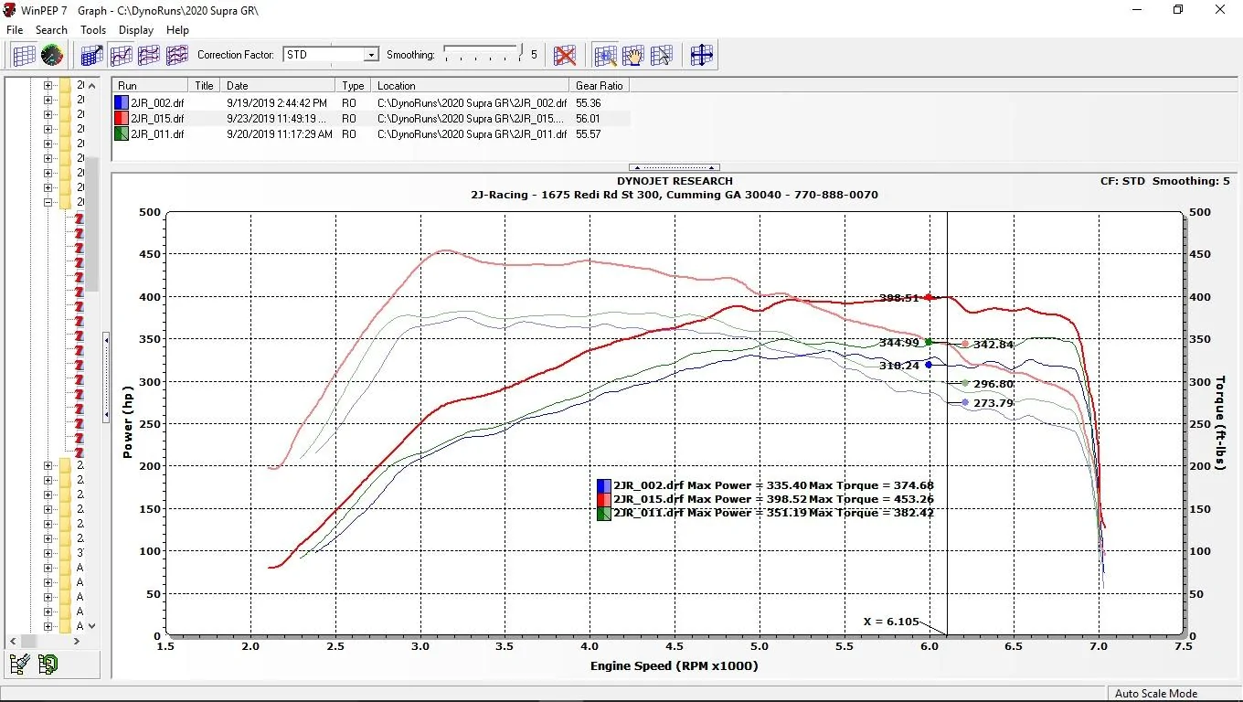

Dyno Results: I know this is what everyone really cares about which is why I saved it for last. We did a total of 9 pulls playing with the different maps etc. But here is the bottom line and the results and a map. This was done on a dynojet, and other factors could play into the numbers such has weather/dyno config etc.
Base line 335 whp, and 374 ft/lbs
Just Downpipe stock map 351 whp and 382 ft/lbs
Downpipe and Tune 399 whp (rounding up) 453 ft/lbs
While I was hoping to see 425ish, and it would be easy to be disappointed the curve seems to match Titans, and the car still hauls the mail and is a blast to drive. So I spent 30 seconds being sad, and every second after with a smile. And speaking of Titan and Ashley their support is top notch.

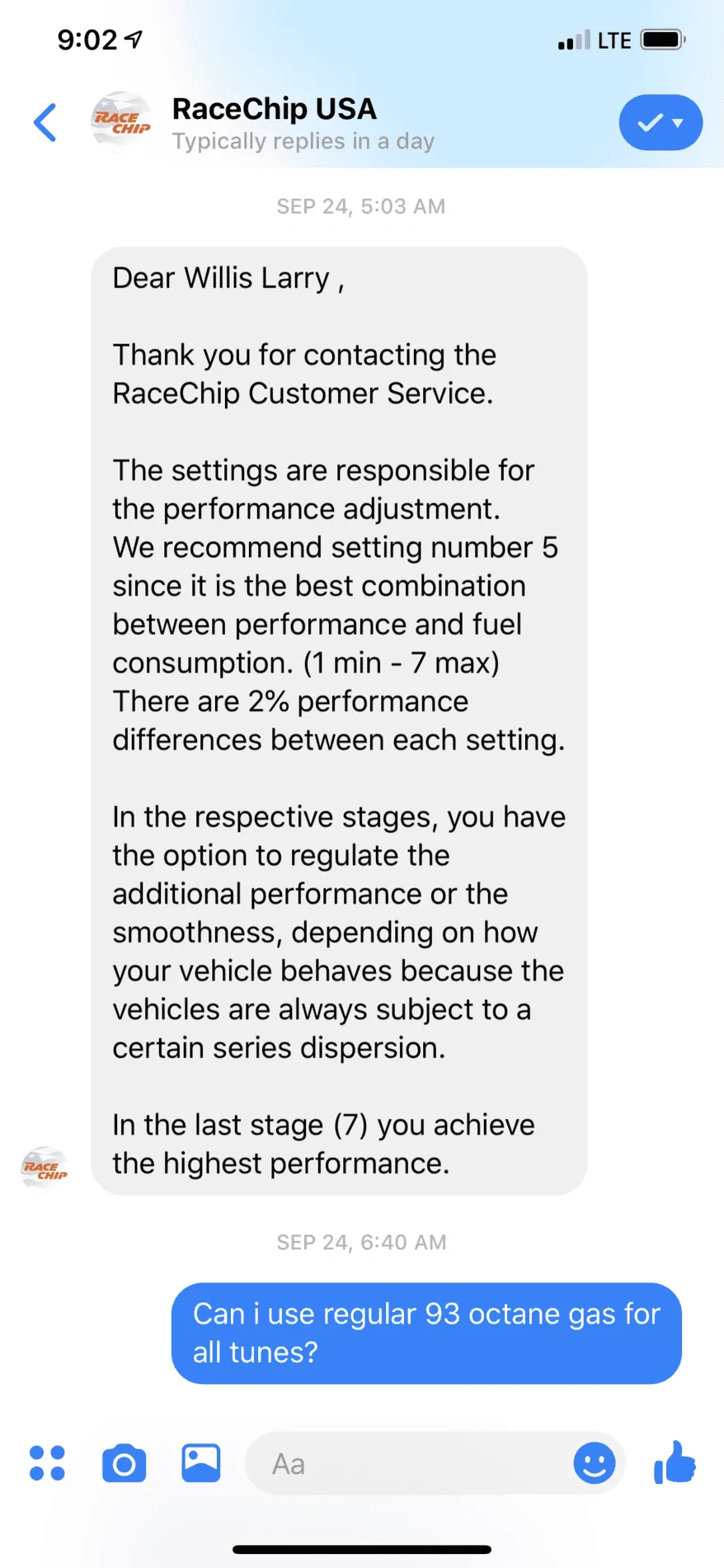

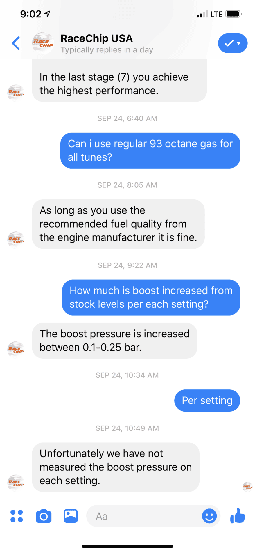

I have this too. It’s similar to the Race Chips piggy back for the B58 BMW cars I would think. I reached out to Race Chips and got some info.
