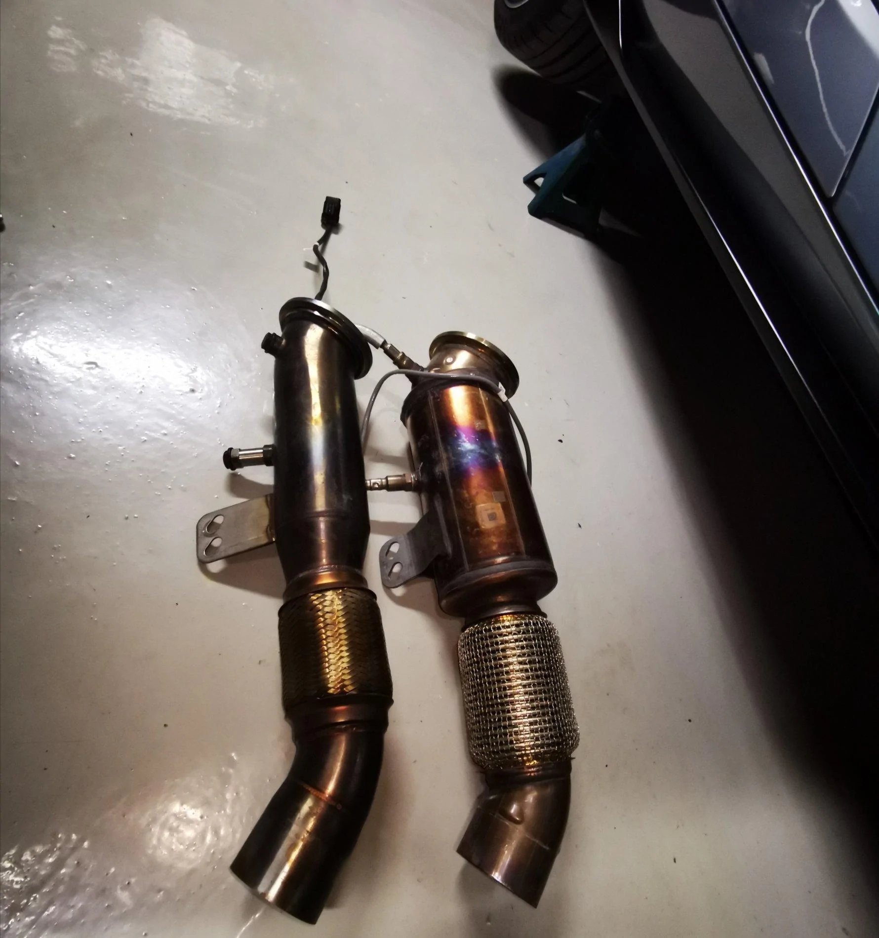

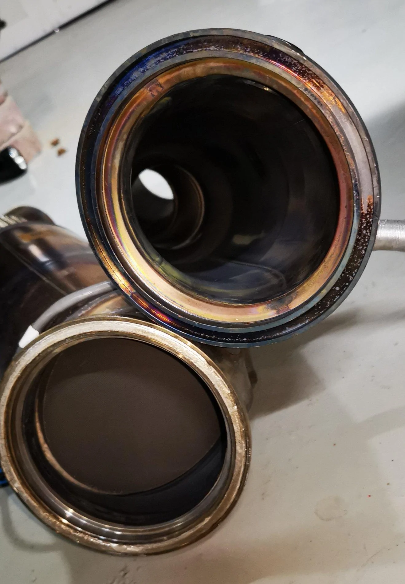

For the sake of sharing photos of both stock vs Titan Motorsports dp. Also the weight difference is massive
