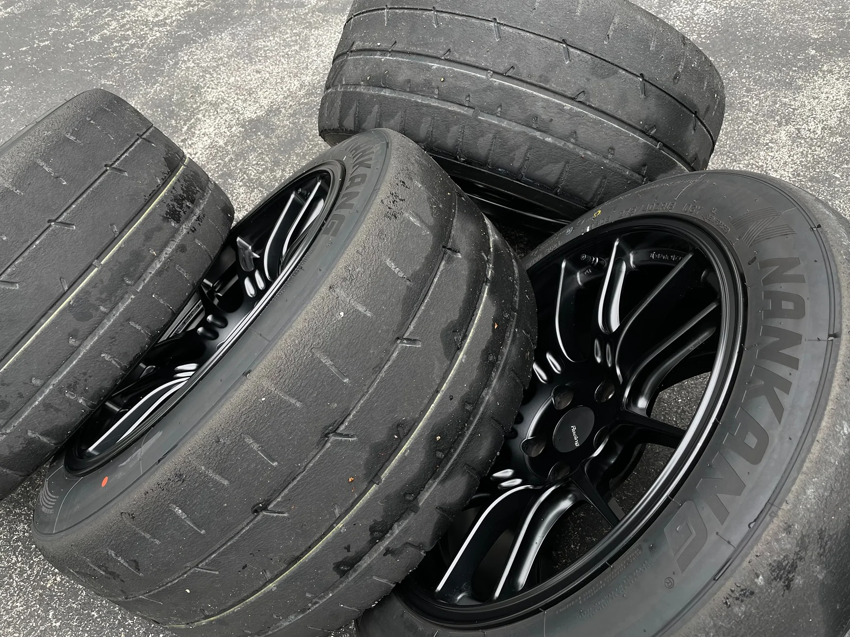

275/35/19 Nankang AR1 on 19x10

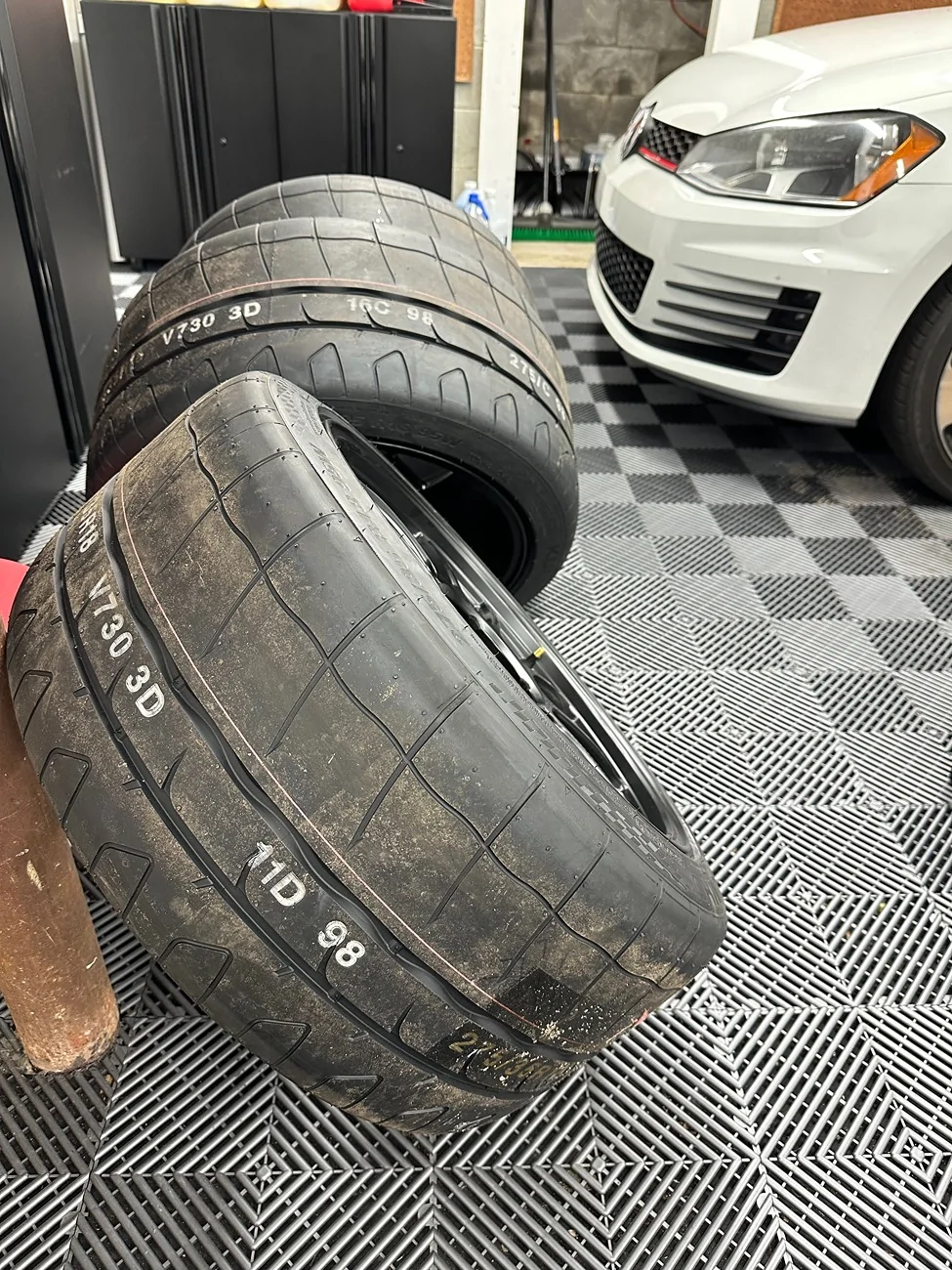

275/35/18 Kumho V730 on 18x10.5
275/40/18 Nankang CRS on 18x10.5

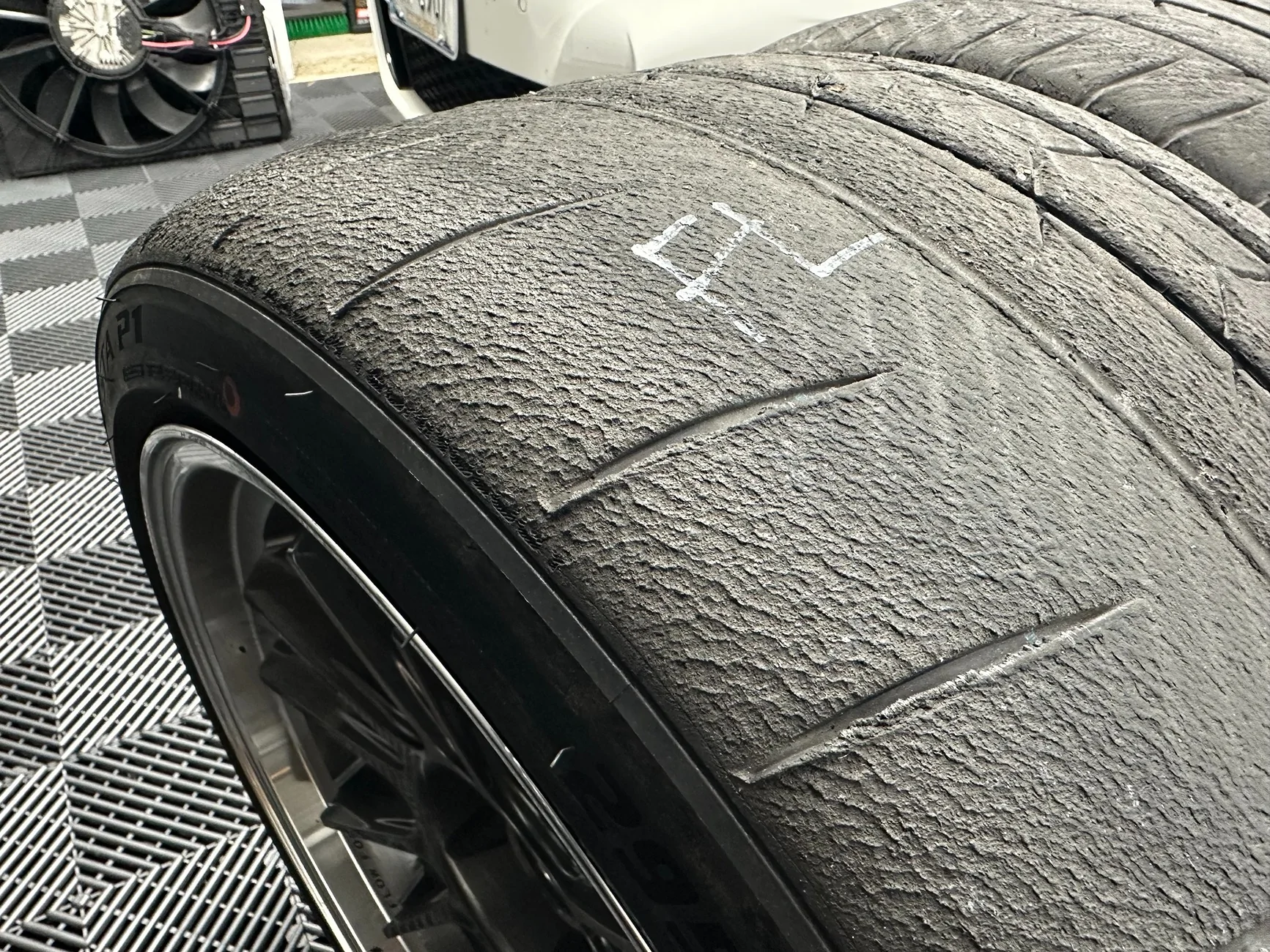

295/30/18 Vitour P1 on 18x11

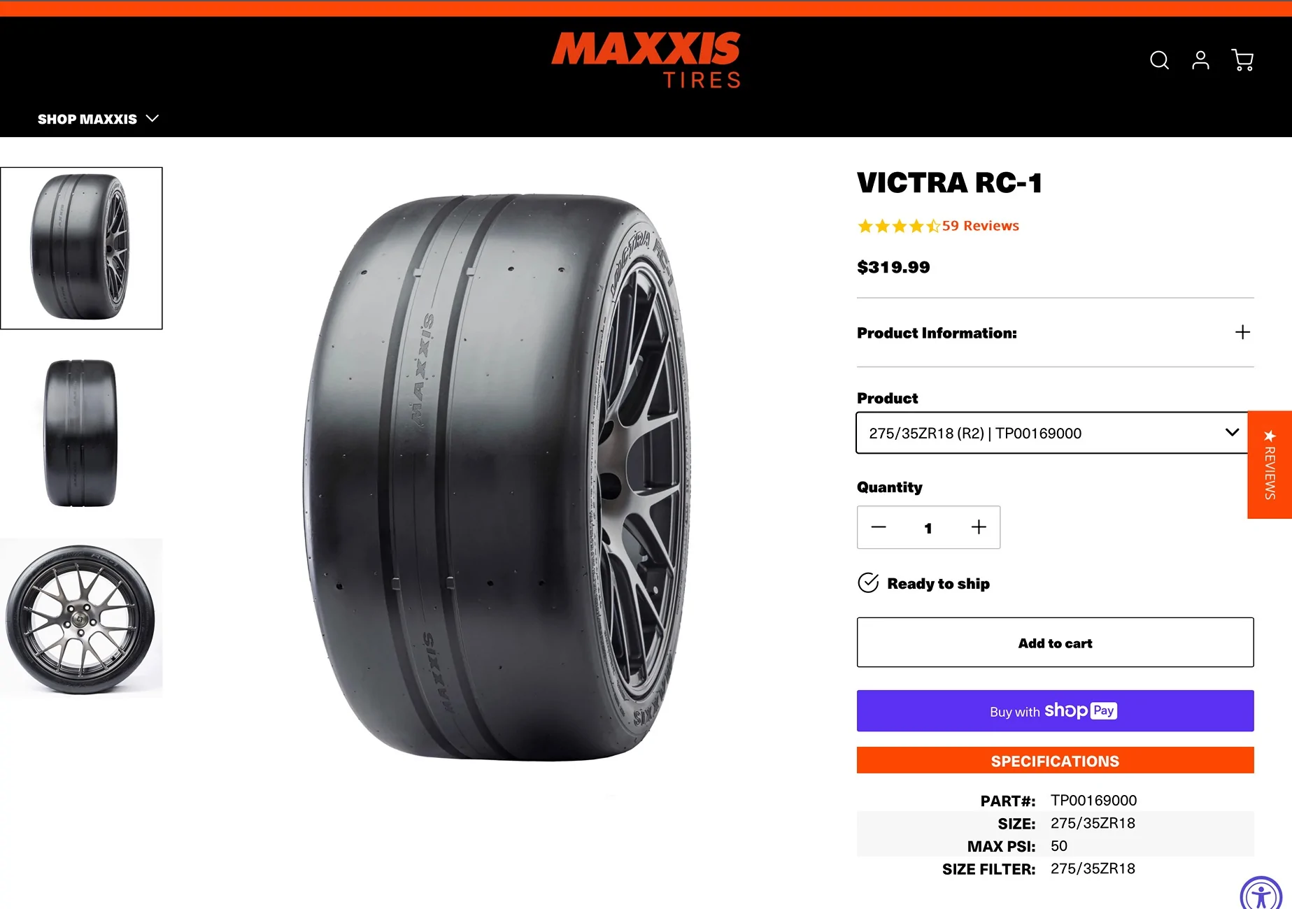

Gimme a little strip of groove grip on Maxxis Victra RC-1s & I’m happy 😜

I was even faster with a Kumho v730 in 275 on a 10.5

Case in point. Vitour is shouting from the mountain tops that their P1 tire is the new holy grail of tires. It's faster than other tires, lasts for 100 years and will make you more attractive. My experience was that they are hype. They went semi fast for one lap, then fell off by 1 sec and were never able to get back to that semi fast lap over multiple days and events. I then put RE71RS on and instantly dropped 1 second back to my PB lap time, then went a whole other second faster for a new PB. Zero changes to my setup between both tires. I also did not become more attractive while using Vitour P1 tires.
