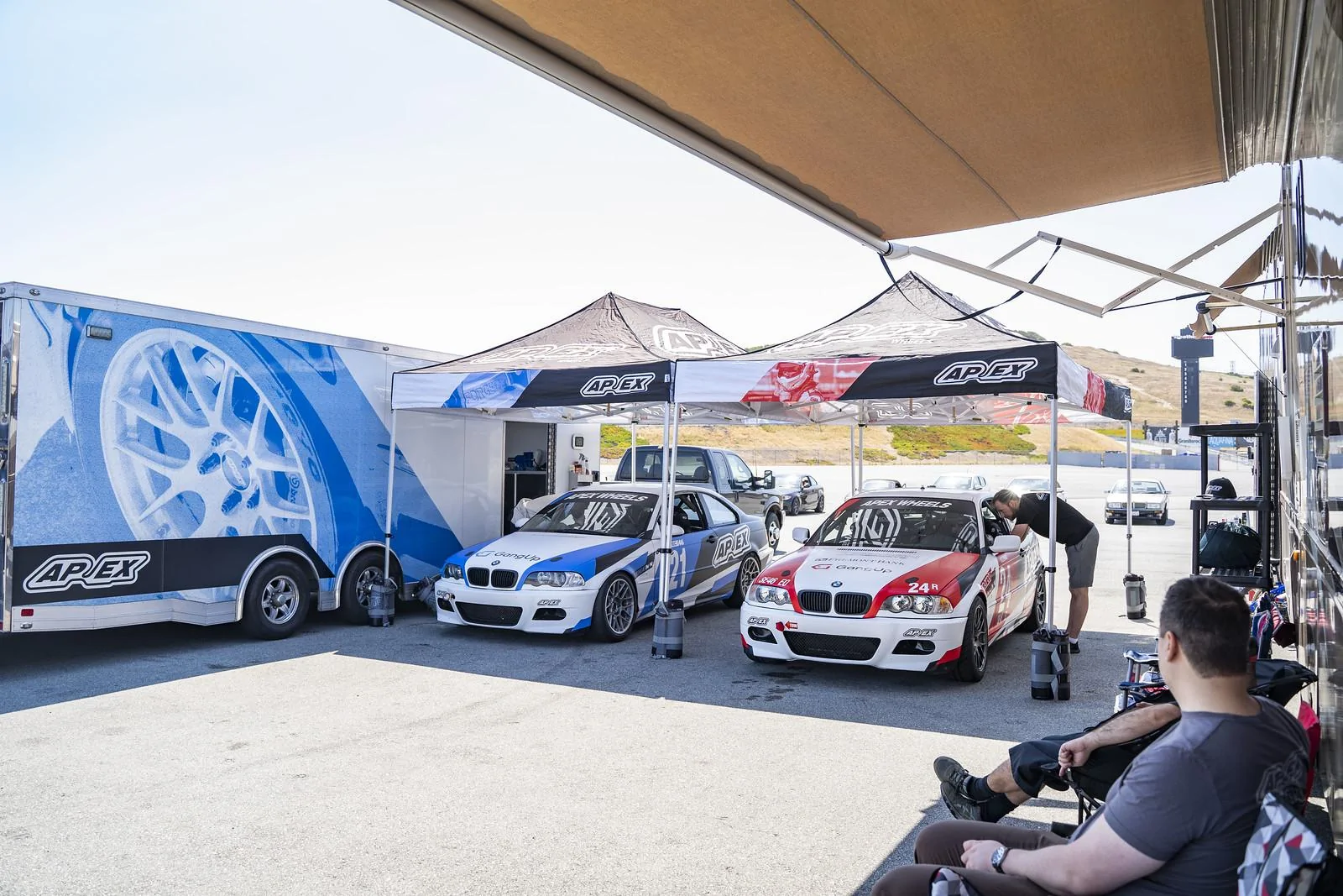

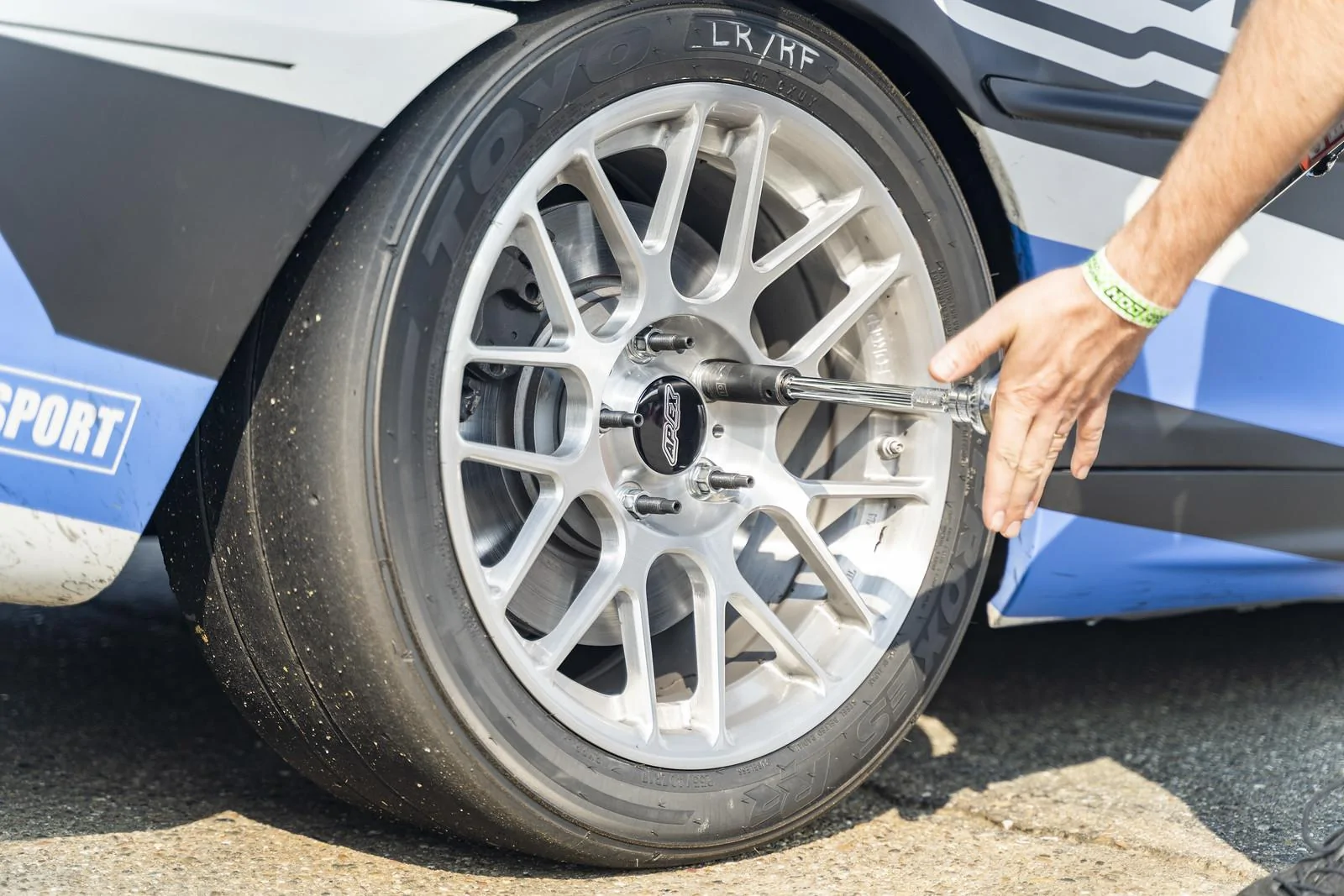

Definitely agree with this. These tires are meant for road course work and getting enough heat into them will be tricky on the street. On track (road course) they perform decently well and are a fairly progressive tire although they lack grip compared to Hoosier R7s or A7s which have the same treadwear rating. They do last quite a while for 40 TW tires though and they are cheaper than the Hoosiers. SPEC E46 requires these tires for their dry tires so we run them on one of the spec E46 cars (Blue):
