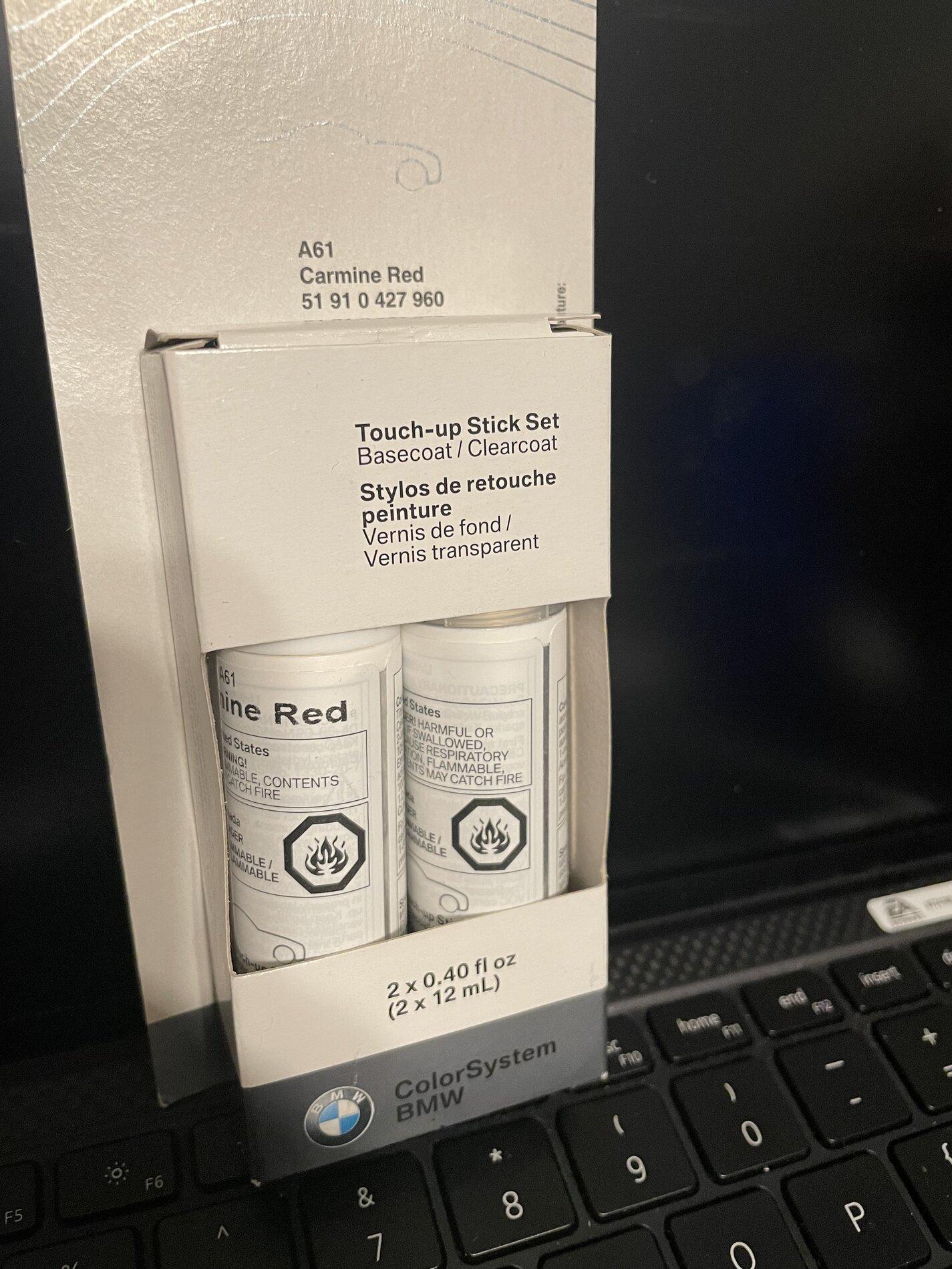

Where do I order this for reni red?
None of the local Toyota dealers had it in stock so buying it at BMW was the easiest way for me to find it.
I picked it up at the local BMW dealer. Interestingly, it was cheaper for me to buy it from them online and pick it up vs walking in and buying it at the parts counter.
A61 Carmine Red should match the Supra Renaissance Red. If you look at the underside of the hood you’ll see the A61 paint code.
Do a test strip to compare colors before applying it to your paint.
