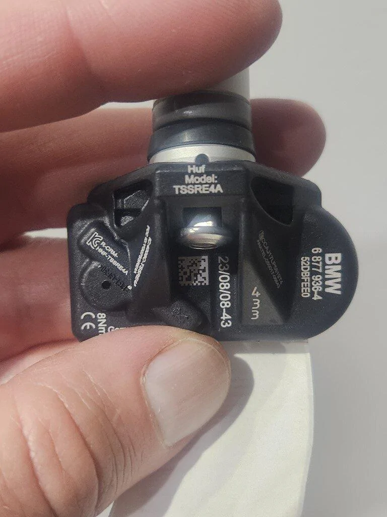

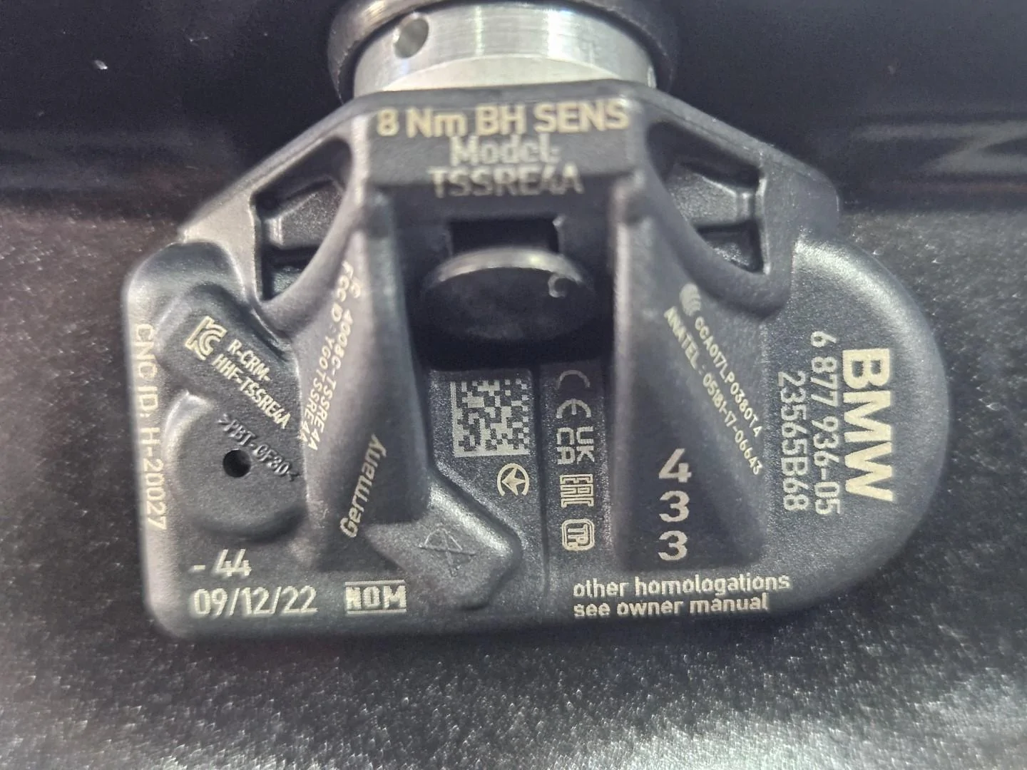

I'm going to order a new set of TPMS on Aliexpress. A set of 4 pcs. costs 30USD while the same set in Poland costs approx. 100USD. The ones I have installed on my MY23 car have PN: 36106877936-05, model TSSRE4A. I see there's a lot of offers for these 2 PNs, all are 433Mhz:
- PN 36106877936-04
- PN 36106877937-03
Which one of them will work as Plug & Play with my car? The ones with suffix -05 seem not to be available on Ali.

P/N on the TPMS sensor is 6877936-04 so that crosses to Toyota OEM P/N 42607WAA02 which is a 433mhz sensor, not a 315mhz
Thank you for this info, this is exactly what I was looking for.

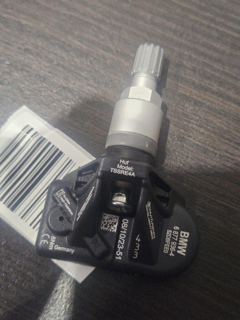

Update 28.02.2024: I just received these TPMS, purchased here for 33USD (including shipping): https://pl.aliexpress.com/item/1005006070956663.html Delivered within less than 2 weeks.
Fresh production, 2x August + 2x October 2023, they look pretty good. I'm waiting for black valves now, once I install them all, I'll post info.

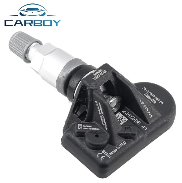

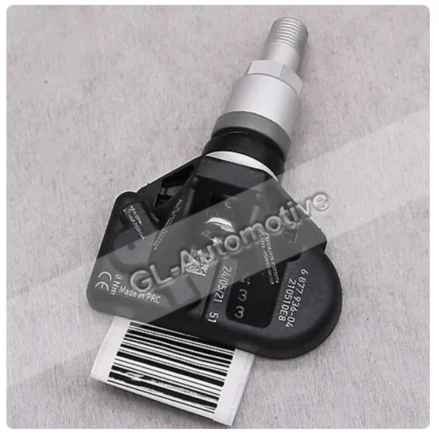

I purchased some 433Mhz sensors on eBay. Sold as original BMW, used, but never fitted.
They came in (opened) BMW boxes and plastic bag, but when we fitted one at the tyre place, it felt a bit "off".
In the past I purchased Chinese sensors to fit to my motorbike's spare set of wheels, as the battery died in the original ones, and – while they do work perfectly – the valve stem length was slightly different than the original BMW and it took a second or two extra to have them fit properly.
So... now the question... are these AliExpress counterfeit BMW sensors?
I've seen a few variations of the markings over time online...
It's mostly a curiosity. I think we will move the sensors from the OEM wheels, and I will keep these ones for the winter set maybe.
