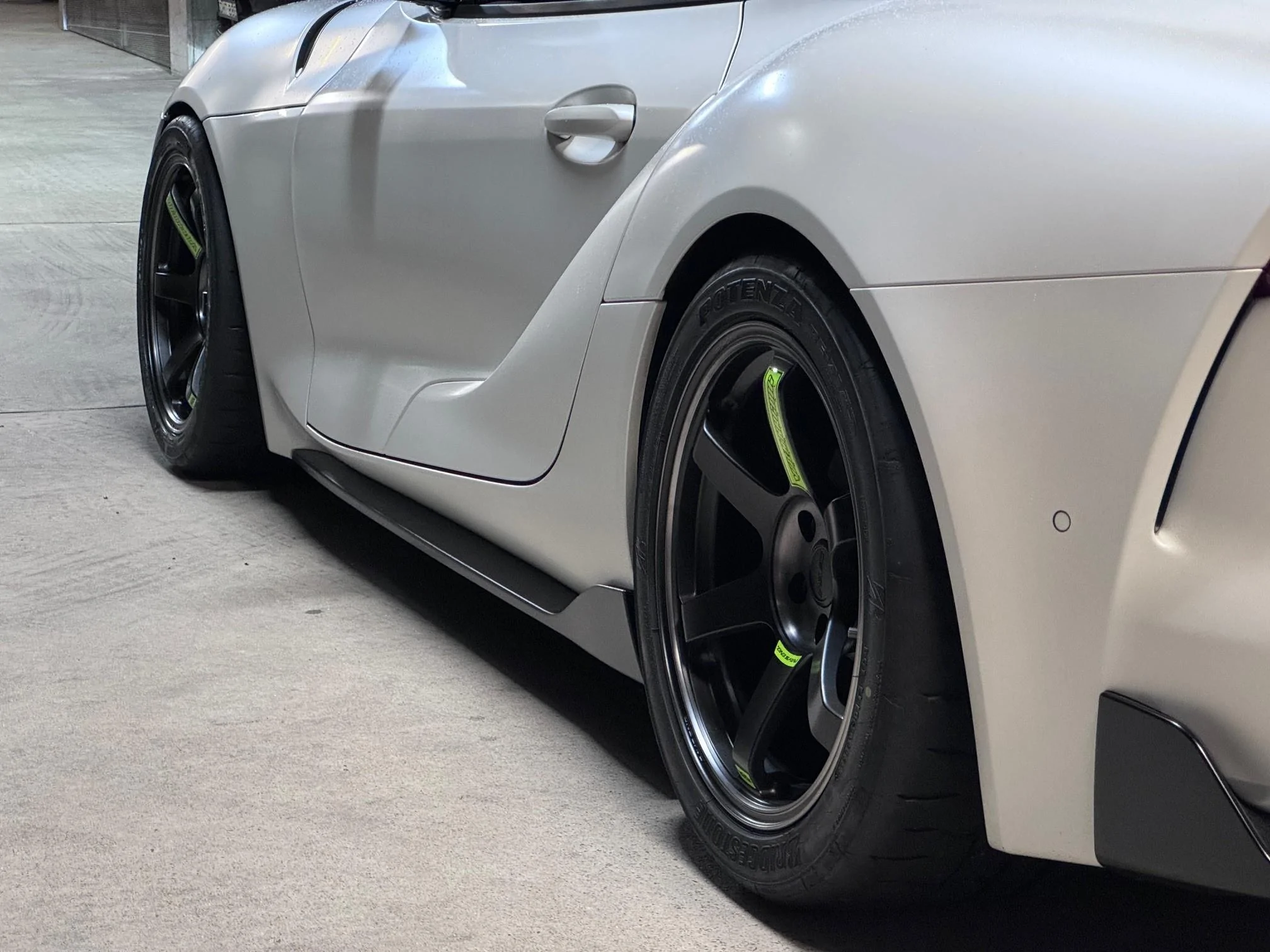

Recently fitted some track wheels to my Supra. I wanted to keep OEM wheels with the TPMS so left them as they were.

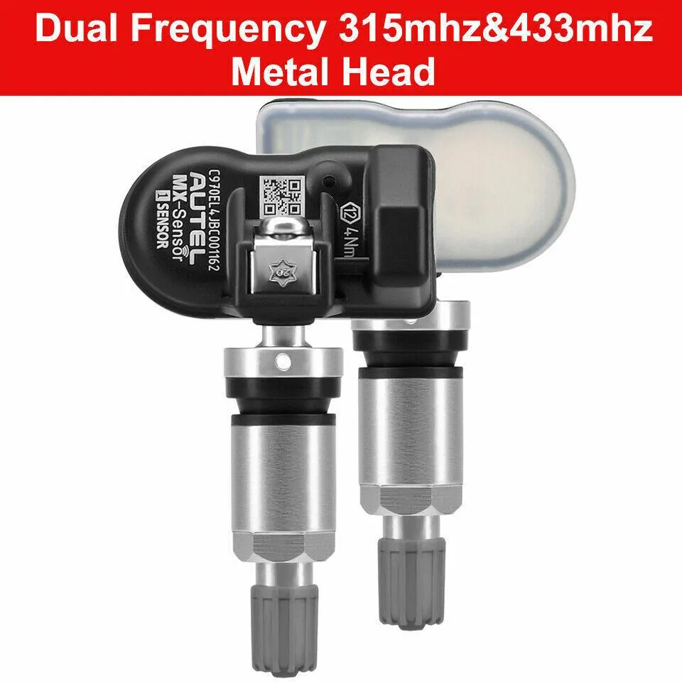

Read a few posts on here debating 315mhz and 433mhz. Ended up ordering Autel dual frequency sensors on the understanding they would work. They dont. Calibration remains at 0% and eventually after a long period of driving I get a TPMS failed warning.
Anybody able to advise which sensors will definitely work with 2023 Supra?
Thank you in advance.

Check out Apex's website. They have the Supra TPMS sensors listed.

Toyota part 42607 WAA02 definitely works. I just put a winter set on mine with those sensors.

I have used Huff TPMS Amazon/eBay sensors on the last 6 sets of wheels for BMW cars I've owned with zero issues
The sensors on tire rack that they sell seem to work as well
