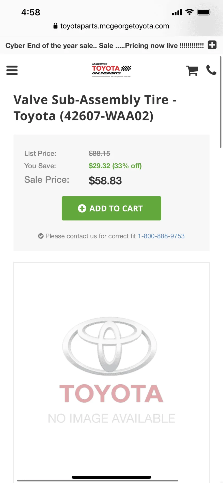

I spoke with my dealership today and via my VIN this is the correct part
TPMS: 42607-WAA02
I ordered online from McGeorge Toyota.
They sell parts cheaper then anywhere else
They’ve got them for $58.83 each

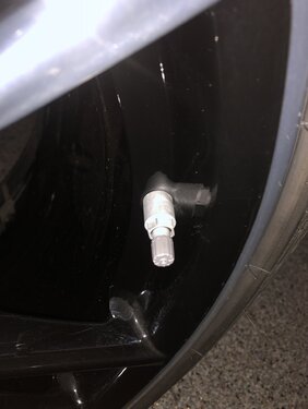

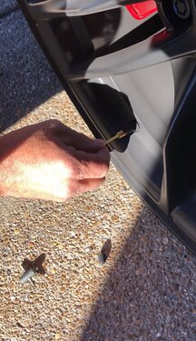

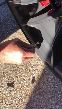

So I have a bit of a story. I bought a set of Launch Edition take-offs from a guy on eBay a few weeks ago. The ad said that the factory TPMS sensors were still installed and the tires looked to be low mileage so I went ahead and bought them.
I finally got to putting them on over the weekend. When I was cleaning them up, I realized that the valve stems didn't look anything like the valve stems that came on my stock wheels but I continued not thinking much of it. Once they were installed, I took the car for a drive and the TPMS light came up pretty quickly (which I expected).
Here is a pic of the LE wheel valve stem:
And this is the valve stems on my stock wheels:

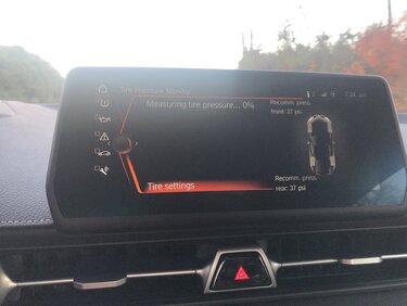

I went into the Tire Pressure Monitor menu and tried first to "automatically" connect the new TPMS with no luck. Same for the manual connection. The progress stayed at 0% even after 15 minutes of driving.
I began to question if the wheels simply didn't have any TPMS installed so I pulled the valve stem core out of both my factory wheels and the LE wheels I had just bought. My factory wheels wouldn't allow me to stick a straw through (presumably because the sensor was blocking it), but on my LE wheels, the straw went straight though (as if there is no sensor at all).
Does anyone have any input on this? Is it possible that the 2020 sensor just isn't linking to my 2021? This could be the case but the valve stem doesn't look like a 2020 or 2021 factory valve stem. Just want to get some opinions before I take the car in to have the tires pulled off the wheels.
Appreciate any advice/input. Thanks.

Those are non-TPMS rubber valve stems. You got ripped off.
