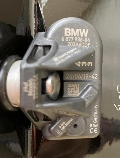

So, ran over the smallest nail in existence and had to get a patch plug this morning... figured i would snap a pic of the TPMS sensor since a lot of people have been asking about it... here is the pic and i will link below a Wurth cross reference manual with OEM part numbers as well... P/N on the TPMS sensor is 6877936-04 so that crosses to Toyota OEM P/N 42607WAA02 which is a 433mhz sensor, not a 315mhz like everyone has been saying... So a little clarity on TPMS sensors for everyone
http://ca.wurthtpms.com/upload/Wurth TPMS Application Chart Firmware Version 4.2.pdf
Saw your post and screen shot it to post here. Good stuff bro

Both frequencies have been spec'd for the Supra and there are two different Toyota part numbers that are available. Recent model BMWs can come with either frequency. I replied in the other thread with more info.
