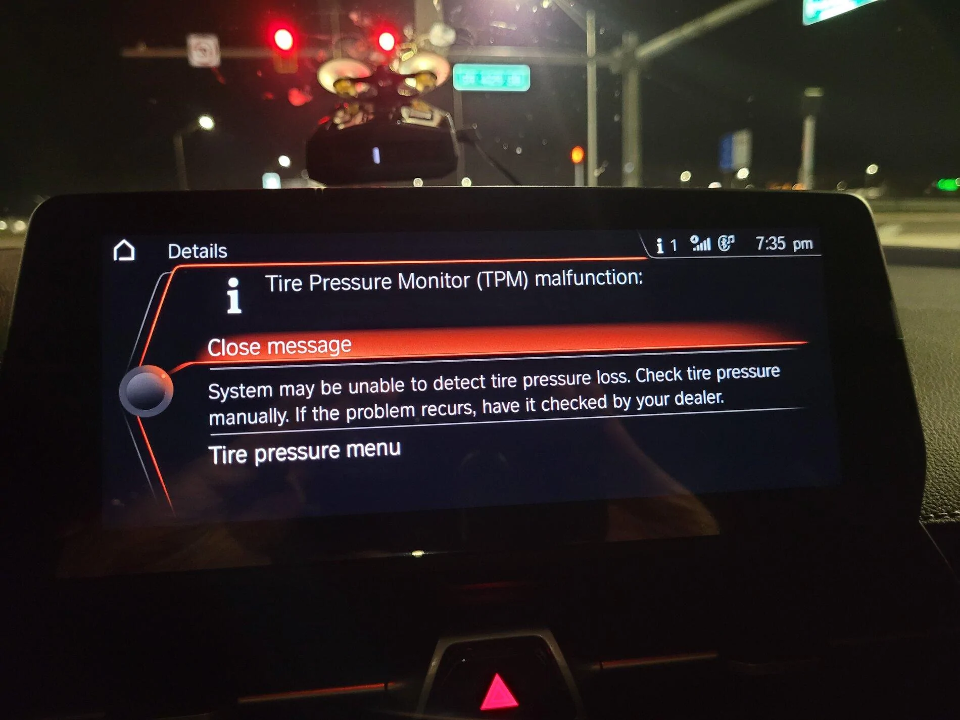

I bought the intellesens 433hz sensors for my 2021. These didn't work. Drove the car for 10 miles then got a TPM malfunction message.
