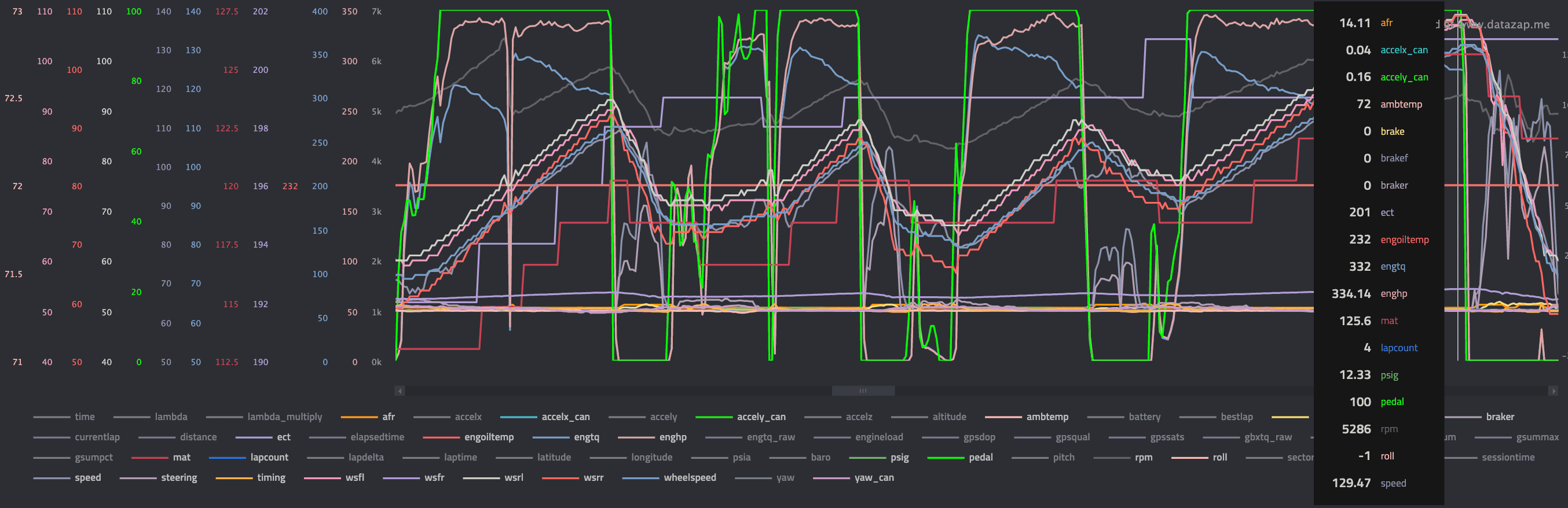

Seems like the easiest option is just to switch to MHD to monitor OBDII channels and keep Racecapture for GPS and CAN. I have a Garmin too which is foolproof butt need a little more detail to improve my very amateurish driving.

Basic Track Day screen!
Made from the ground up using all RC app has to offer.
Features:
-Car data: engine temperatures, fuel, range, tire temperatures and pressures.
-RPM with shifting alerts
-Throttle, brake and steering indicators
Ambient temperature, battery charge and GPS quality
Track timer with, predicted, last, best laps, and delta timing.
All in a packet with plenty of alerts and a format easy to read on the track and Pits.
Screen can be recorded and overlaid on top of video for analysis.
Available for Download in RaceCapture App
