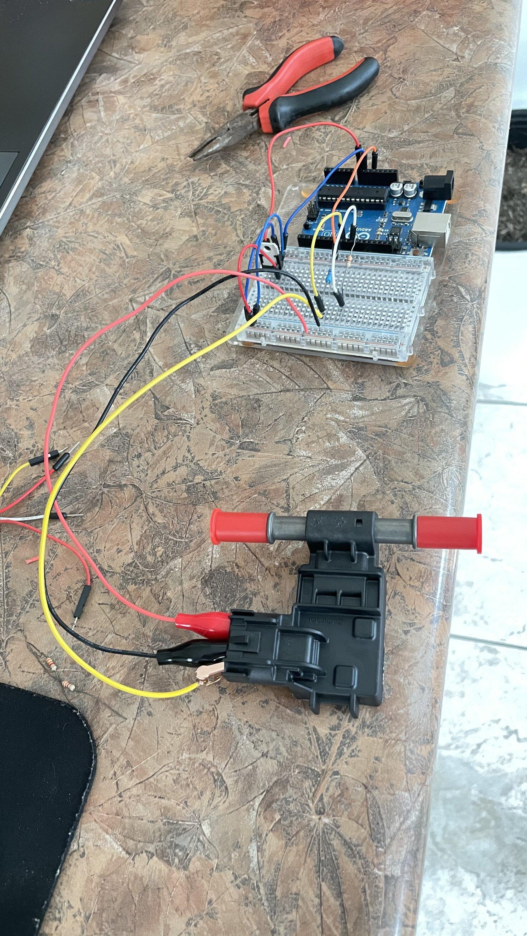

Thanks for the writeup. I have a kit I started working on for my BRZ before I had to sell it during the pandemic and was hoping to reuse it. I opted for skipping the Zeitronix and instead programed an Arduino UNO I had laying around to convert the E% and Fuel temp signals to 0-5V for the CANBUS thanks to an old Subaru forum. I did add extra outputs for external gauges. Just have to get an Arduino Mini and small PCB for the other electronics to shrink everything.
