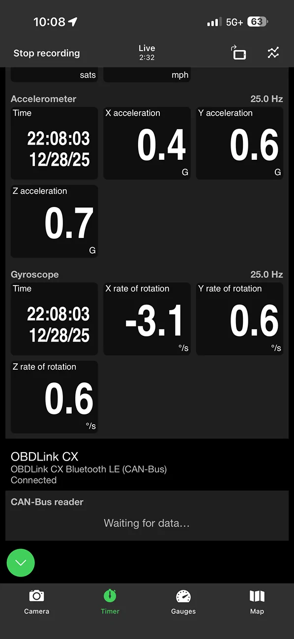

Edit: OBDLink CX doesn’t work. Tried it with MX+ and worked without any issues.
Says waiting for data and nothing shows up. Should I just try the mx+?
It works on my BMW G42. Weird the CX is seemingly unreliable.

ObdLink CX works fine on my 2023. Might be an issue with this specific obdlink cx.

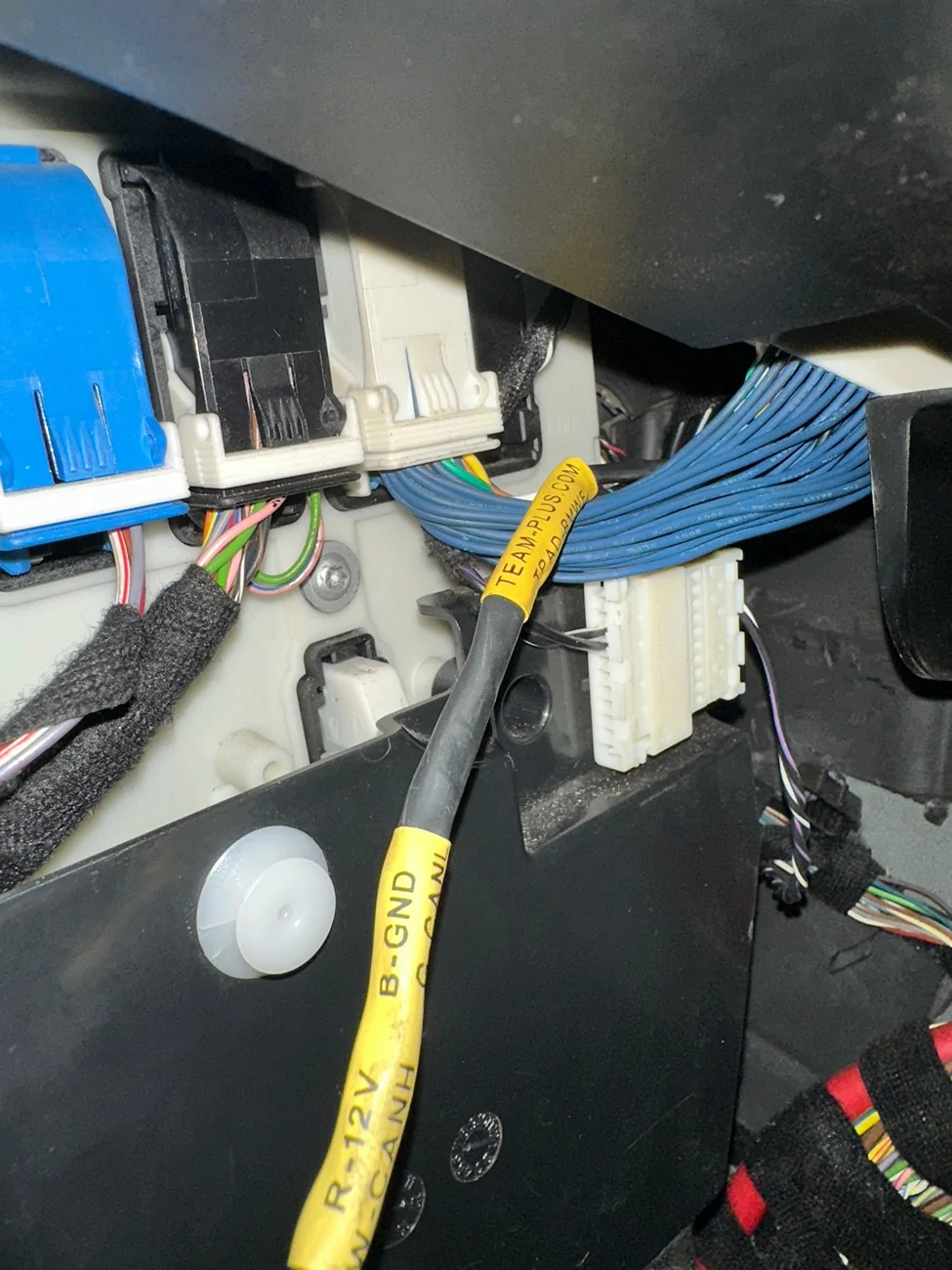

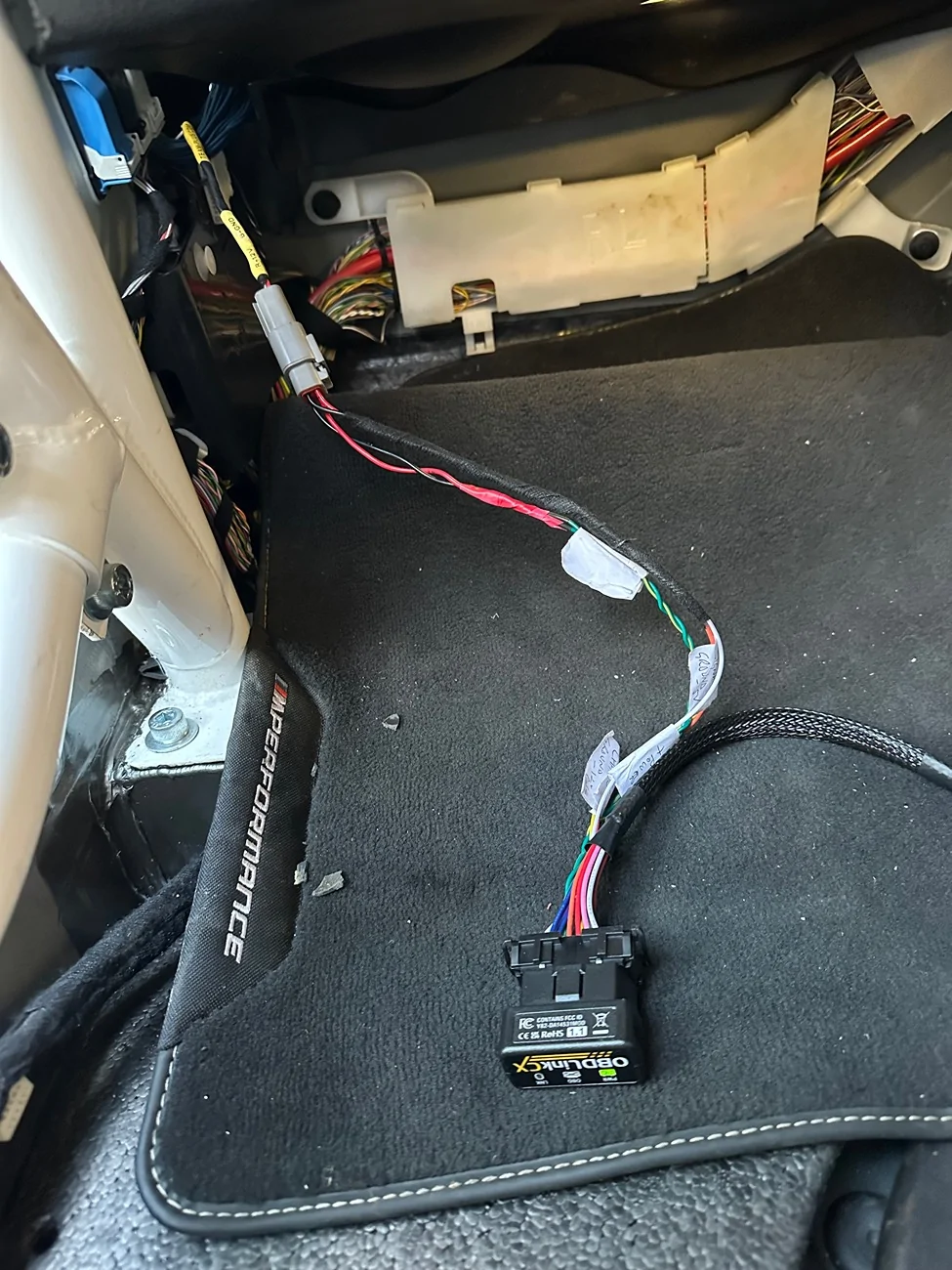

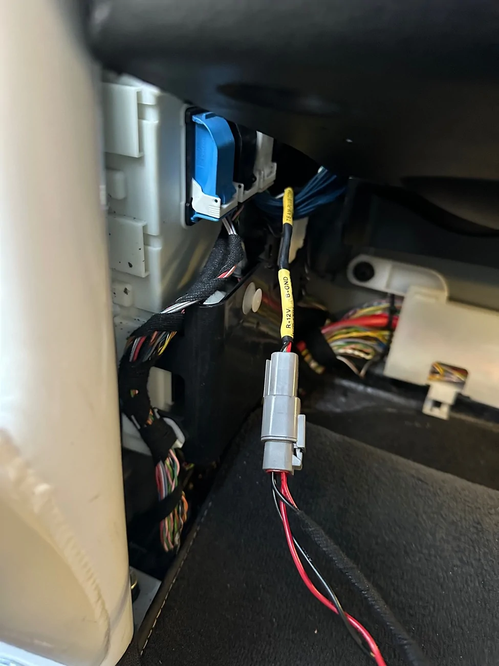

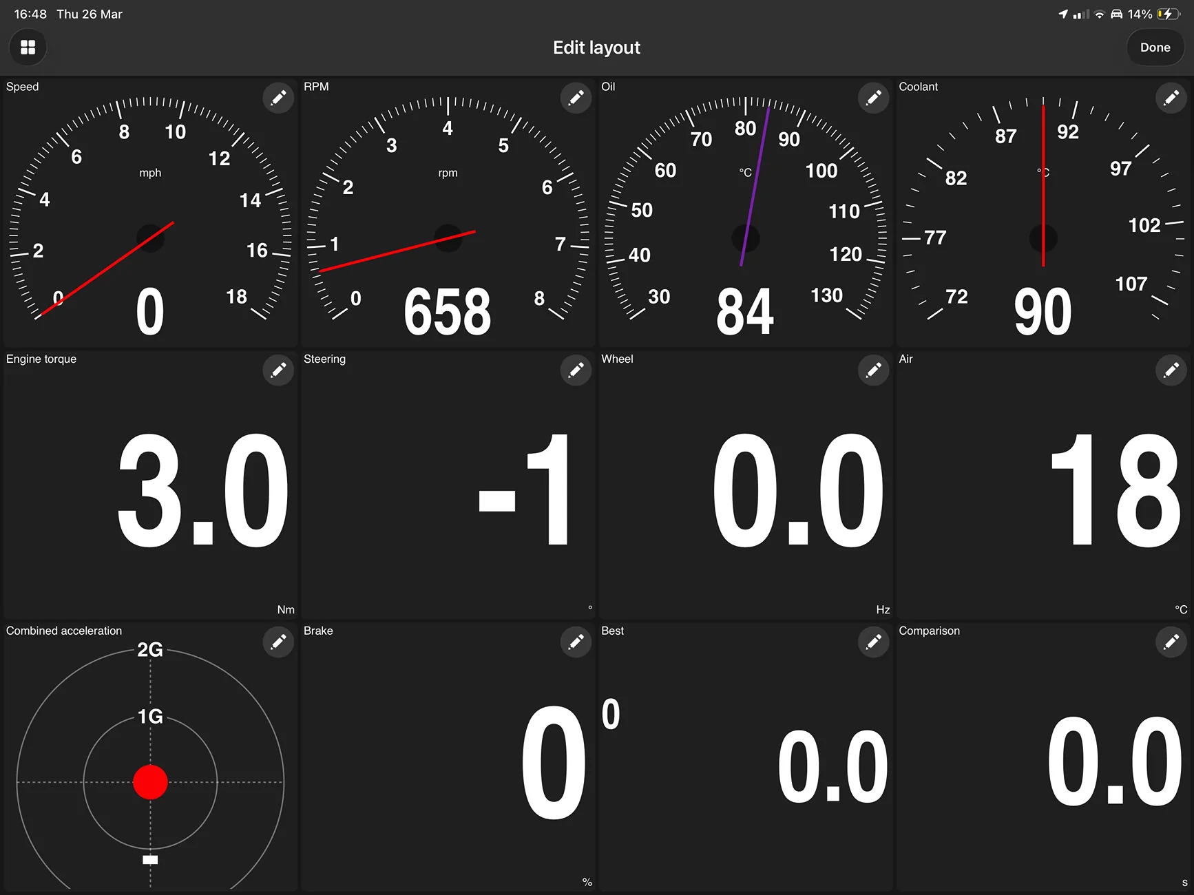

I would like to offer a massive thanks to Razorlab for unlocking the puzzle of how to get advanced data out of my BMW 135i F20 and into RaceChrono Pro using fast CANBUS. I have been chasing this dream for track day usage for a couple of years and your article plus that of Porsche man PlanetKris plus the download config file finally made it happen. Good on you for sharing with a wider audience.
I used a set of plug & play components to avoid tapping into delicate canbus wires. Total cost around £300.
You may find a lot of visits to this site from BMW F series and G series owners looking for this solution!

2021 Supra AT
Has anyone had issues with the MHD dongle throwing your car into every error imaginable? I wired in the canbus per this thread and was running a track day with the MHD OBD dongle in the right footwell. Everything was fine for the day and when I get home and go to the move the car later I had 21+ error codes pop up and car go into limp mode. It's happened once before so I pull the dongle out, restart and everything clears out.
