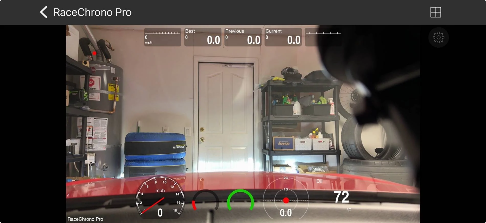

Thanks so much @razorlab ! Just got it all working. What took me so much time was the posi taps since I never used them before. But I am supra excited to see and address my trail braking for big willow next week! You just saved me from getting an aimsolo.
I know you said you were going to update adding the obd connection as well. I imagine I would have to get another obdlink connect it in Racechrono as well? Are there any advantages of the obdlink mx vs cx?

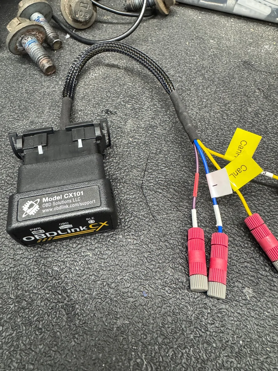

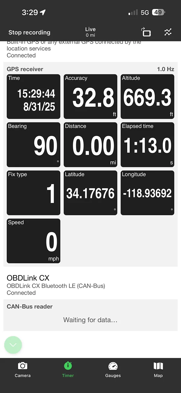

Does the OBLink just need power and CanH / CanL or are there additional wires to connect? Can connect to OBDLink but RC just just waiting for data. Thanks for pioneering this!
8,816
17,302
Power/ground/canH/CanL

Yes, idling. I checked CanH and CanL both show voltage so wires are tapped. Seems I’m missing a setting or something.
