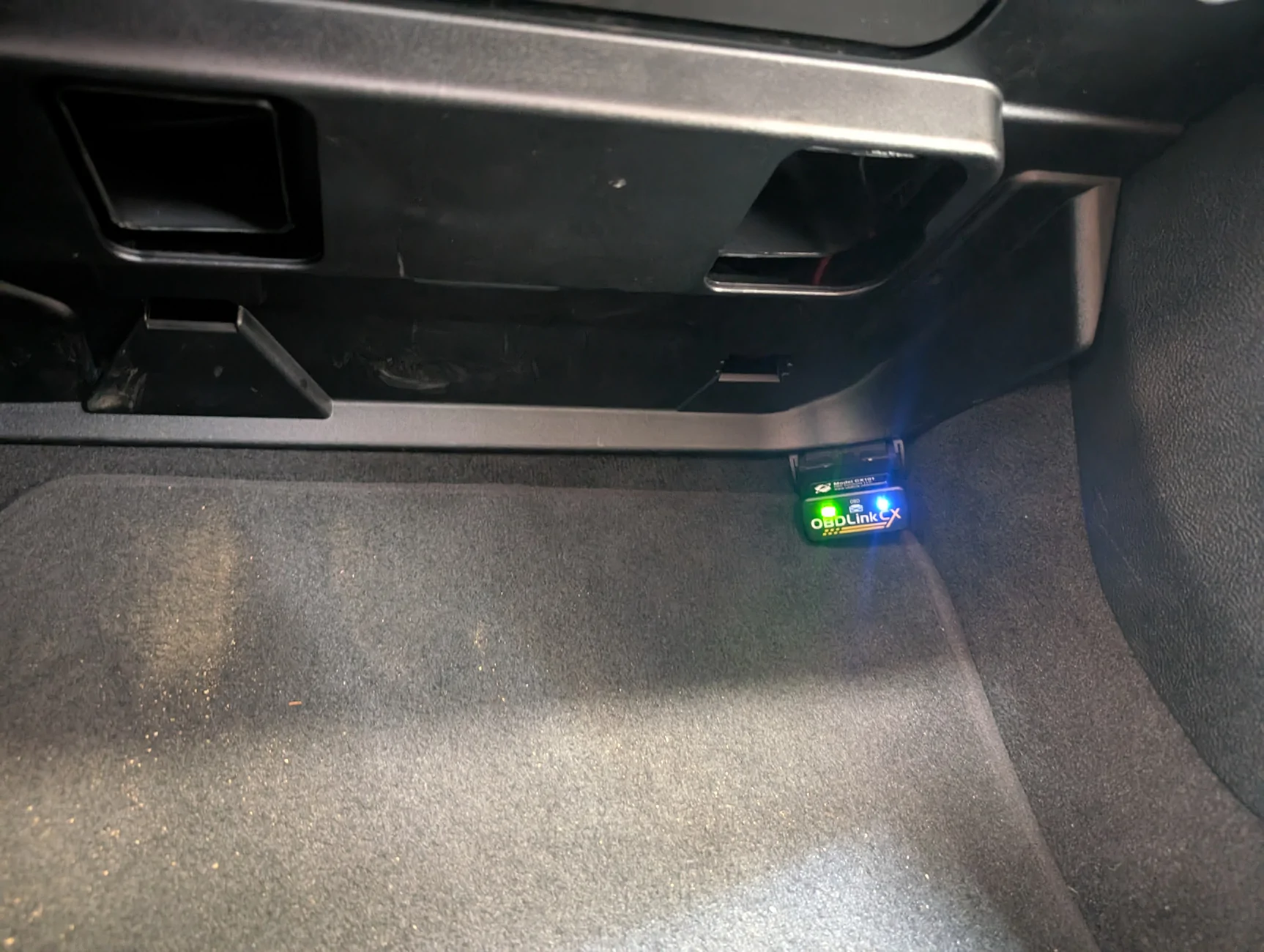

Anyone figure out IAT PID / formula yet?
Waiting for it as well. I know we can easily get it through OBD2 but connecting my OBD2 port short circuits the entire car for some reason. I need a CAN solution.

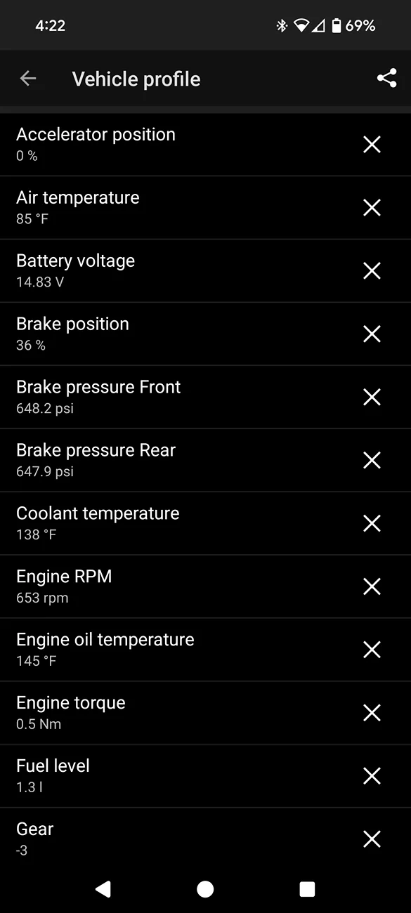

Thanks to @garudathree , It looks like we might have IAT over CAN.
@Gabe and @Hit_Apex, do you want to test this to make sure? My car is up on quickjacks currently.
CAN ID 1017
bytesToUIntLe(raw, 6, 1) - 48
That is in C
If you want to try F, I believe this should work:
CAN ID 1017
((bytesToUIntLe(raw, 6, 1) - 48) * 9/5) + 32

After some trial and error this is what I got.
AAT 75F
IAT 80- 82F
IAT last value on the screen
