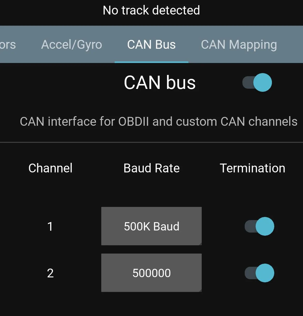

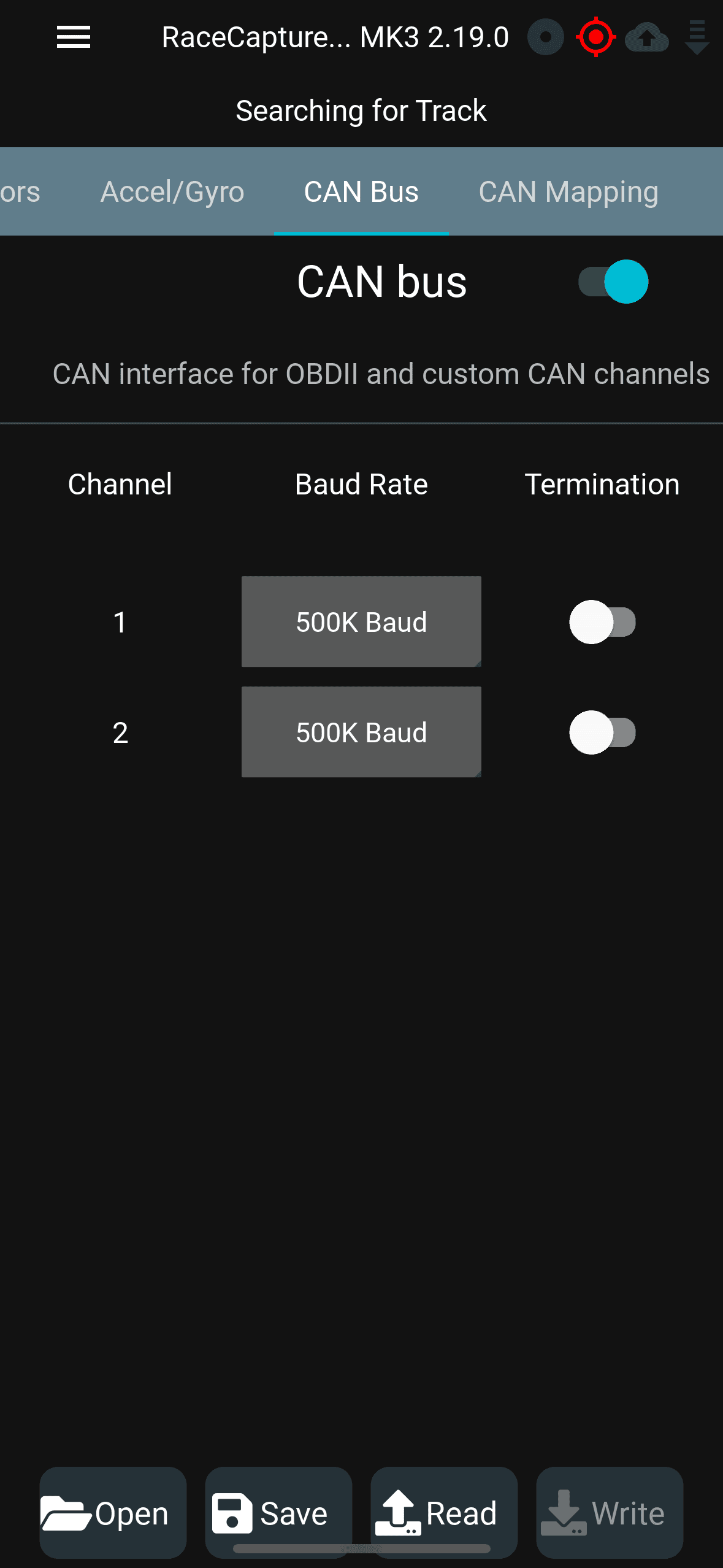

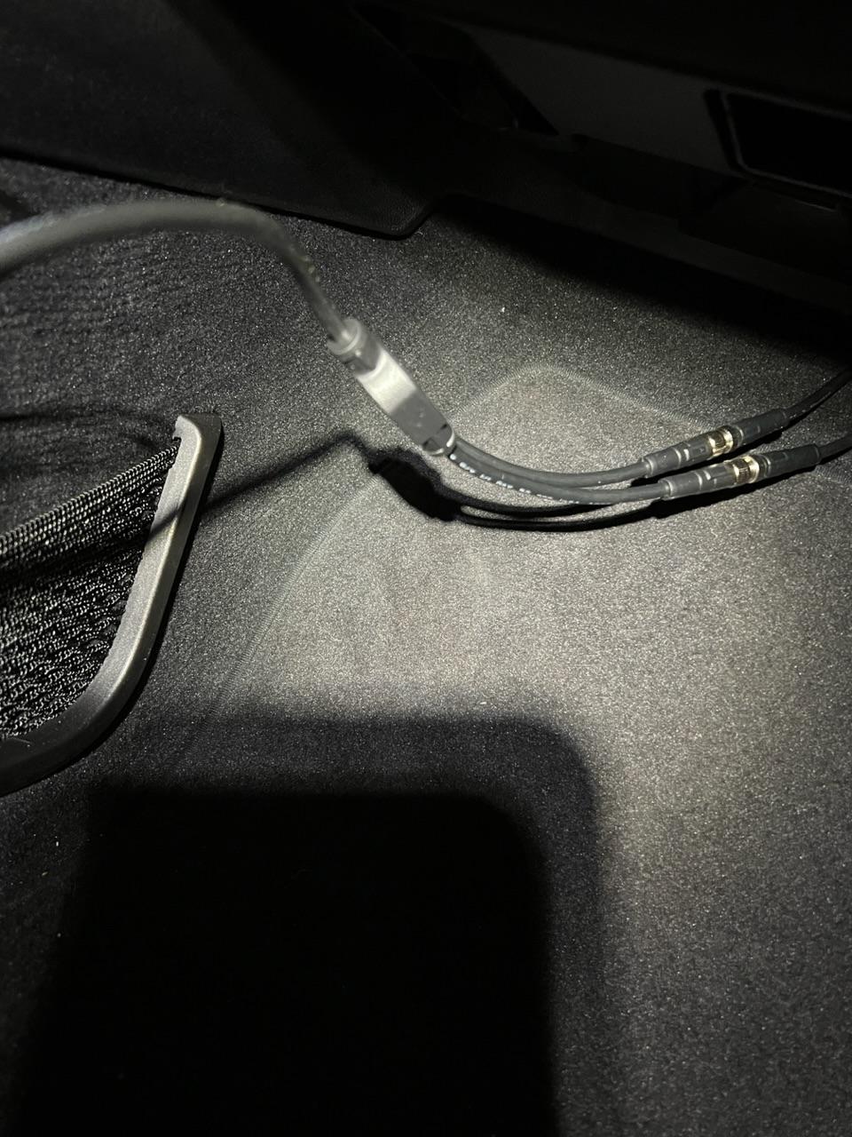

Good evening, good sir!
My device is wired into CAN and OBDII with the splitter cable you linked so that it goes into one slot on the device:
I’m currently not getting any data with the car running, even the OBDII data. The only setting I didn’t see mentioned was this:
What do you have this set to? Thanks!

Make sure you have the channels mapped correctly as well. I had an issue where I had all my CAN data items mapped to CAN2 but I had the physical connection on CAN1.
I'm not sure off the top of my head my settings you are asking about. I'll connect to the car later and check for you!

Here you go:

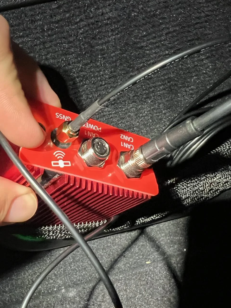

Thanks! I’ll try that out today.
In your original post, you have the OBDII and CAN merged into one connection on CAN1/Power. What do you have hooked up to the other connection on the device, that big blue cable on CAN1/CAN2? If you weren’t using whatever that blue cable is, could you plug the OBDII into one port and the CAN into another?
8,697
17,044
Yea ignore that photo. I was doing some testing that didn’t work.
