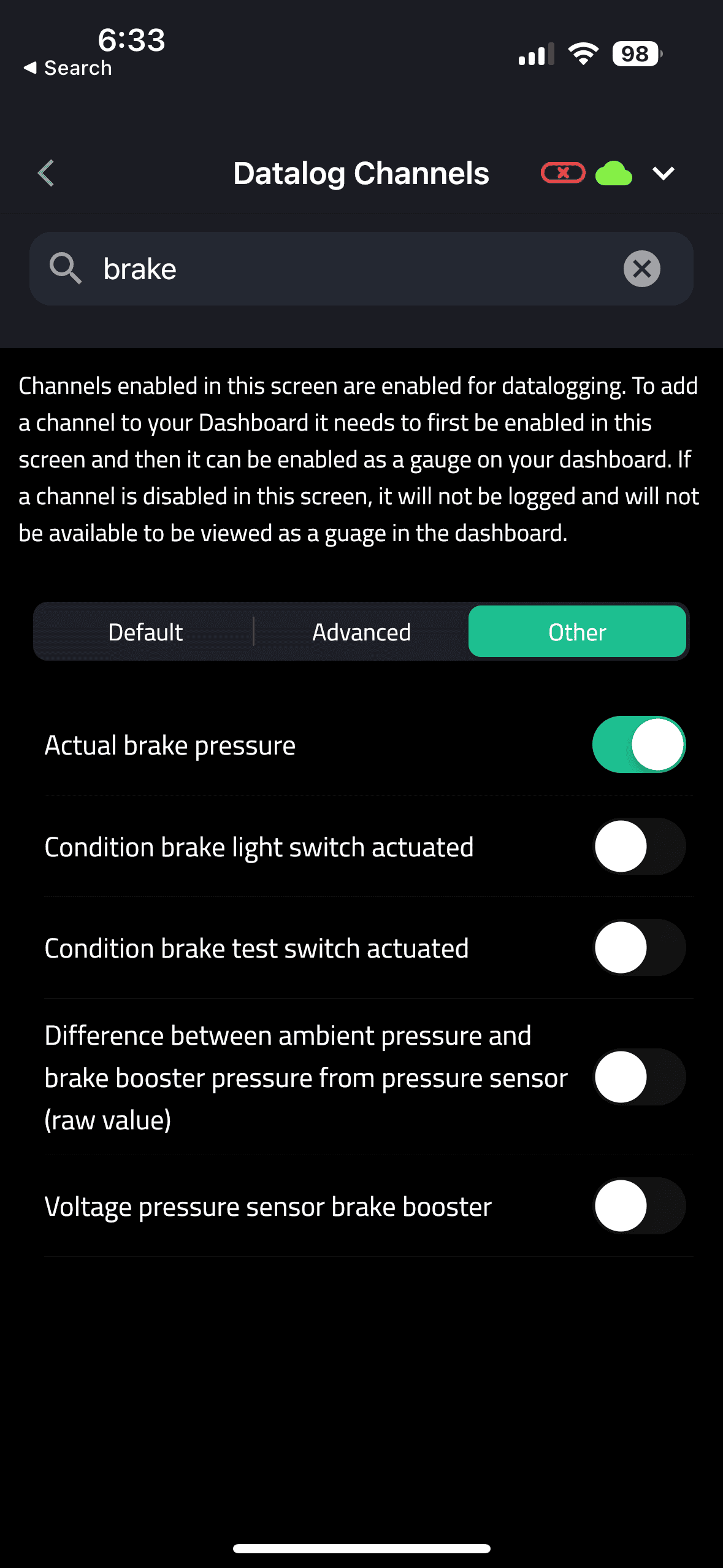

Haven't found that on OBD2 yet. I do know the BM3 logger can get overall brake pressure, and TPS over OBD2. I don't think you need to have a BM3 tune to log them either.
At some point I need to sniff the port and find the details of all these items. Hard to find the time.
