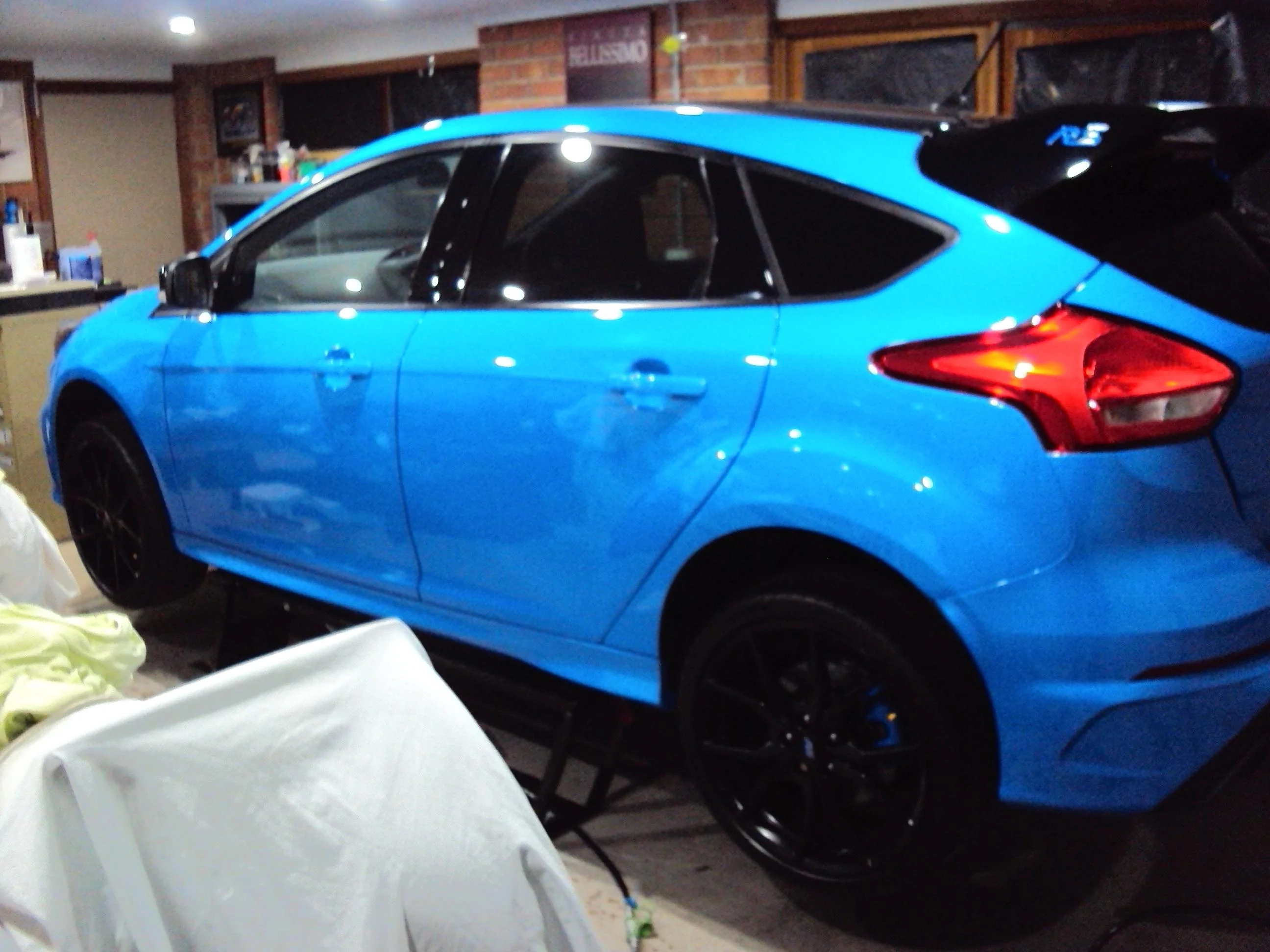

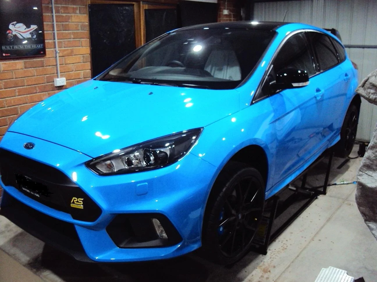

My only advice when you decide on a trolley jack is don't attempt to use it on the jacking points without a pinch weld protector or jacking pad. I bought this and still have it (Quickjack) Brilliant piece of equipment.

I know the quickjack is not cheap but it is well worth it if you plan on using it at least semi-regularly. I've used it on my mini cooper, supra, and rdx. I've also used it on the SOs focus (not rs haha). Makes doing stuff so much easier. In fact the supra is currently up on it for brake pads/fluid flush and oil change. Did the mini timing chain with it and focus sway bar end links. Yes all of that could have been done with a normal jack its just super easier and folds up nicely with a couple wall hooks so doesn't take up tons of space. They may even be offering a memorial day sale right now.
