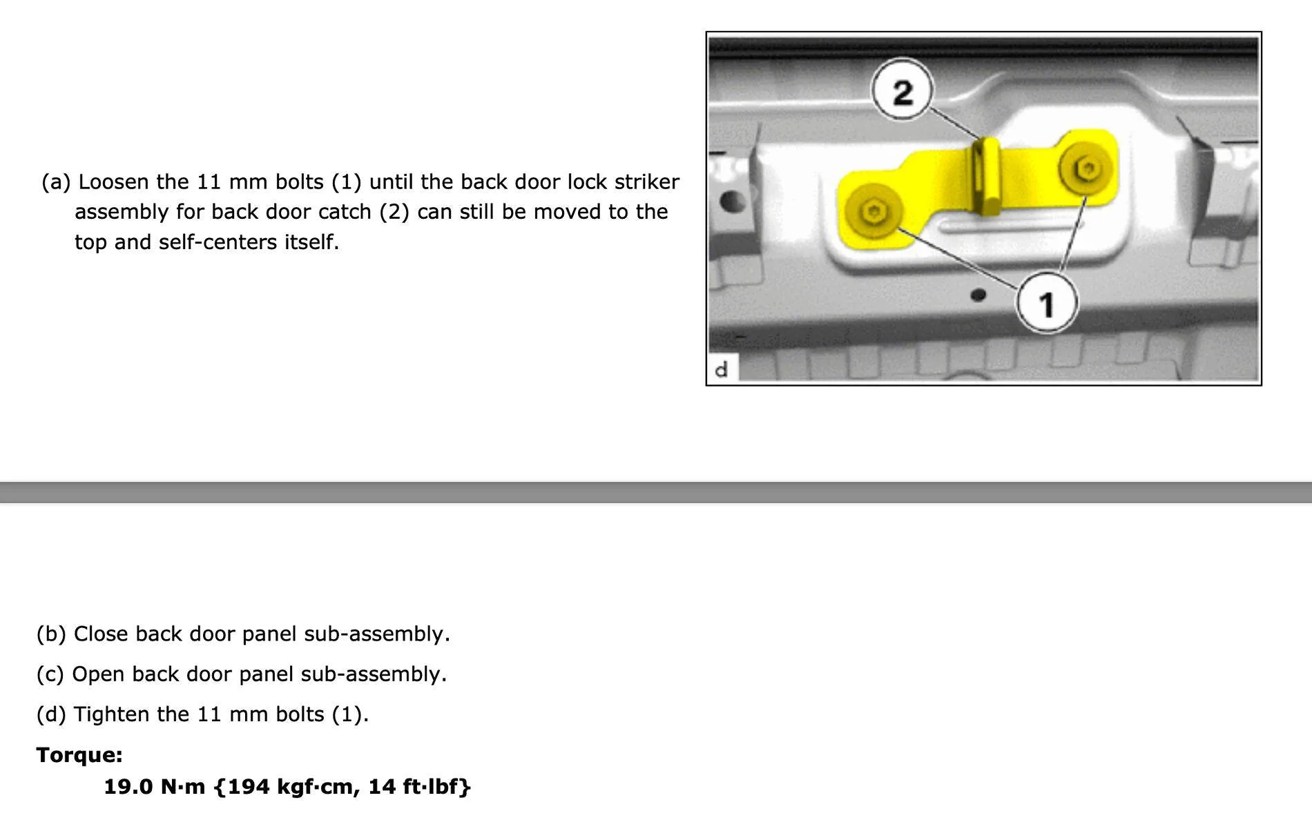

Also,, if the knobs push out the hatch too much where it's no longer flush with the body panels, you can remove the black trim and adjust the lock striker.
I twisted my knobs counterclockwise where it finally worked but then my hatch was no longer aligned with the side body panels. Loosening the 2 11mm bolts on the striker, then tapping it down about 1-2mm keeps the hatch from re-locking prematurely when that vacuum is caused by the doors closing shut.
