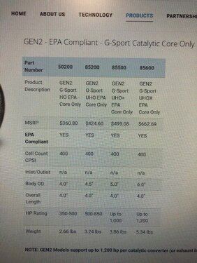

I am running the CG catted dp and E50 tune. Attached is a chart showing the flow rates of the various Gesi cats in terms of horsepower supported. Note that the 5 inch cat used on the CG Precision dp is rated up to 1000 hp while the 4 inch models that the other manufacturers use are good up to 500 hp.
So the CG Precision does use a GESi catalytic converter? I couldn't confirm this when I was doing research on this catted downpipe and assumed it was an off-the-shelf 5" cat. If so, that's great news.

2020 Supra, 65 GTO restomod, 69 Corvette
CG does use Gesi Gen2 epa-approved cat. You can tell there is a significant reduction in restriction by how much louder the exhaust is. The first time I started it I was shocked.
