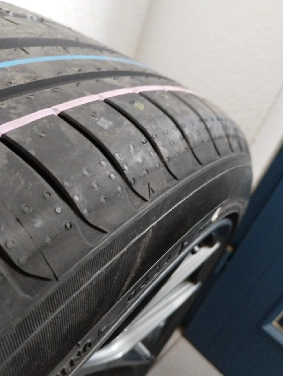

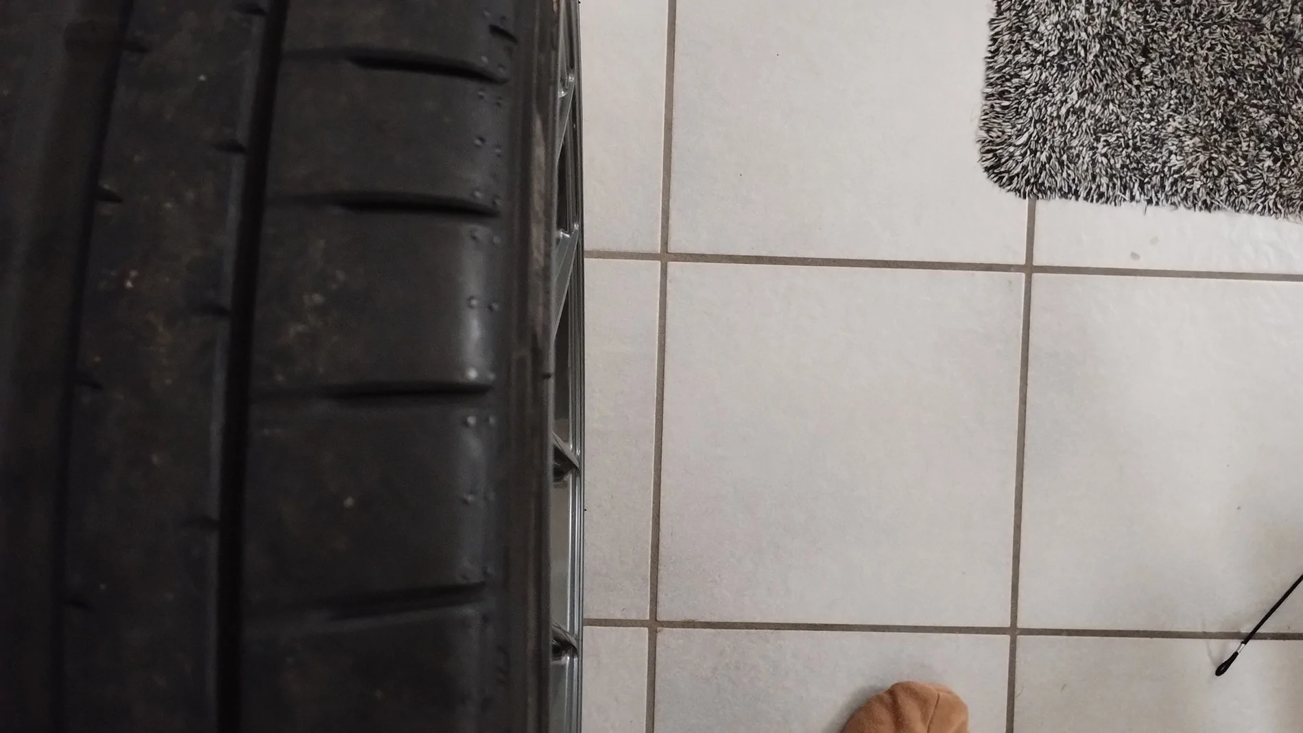

Since i just recently got some new wheels and tires in that size, here are some pics for reference.
Tires are Yokohama Advan Sport V107.
Front 19x9,5 with 265/35
Rear 19x10,5 with 285/35

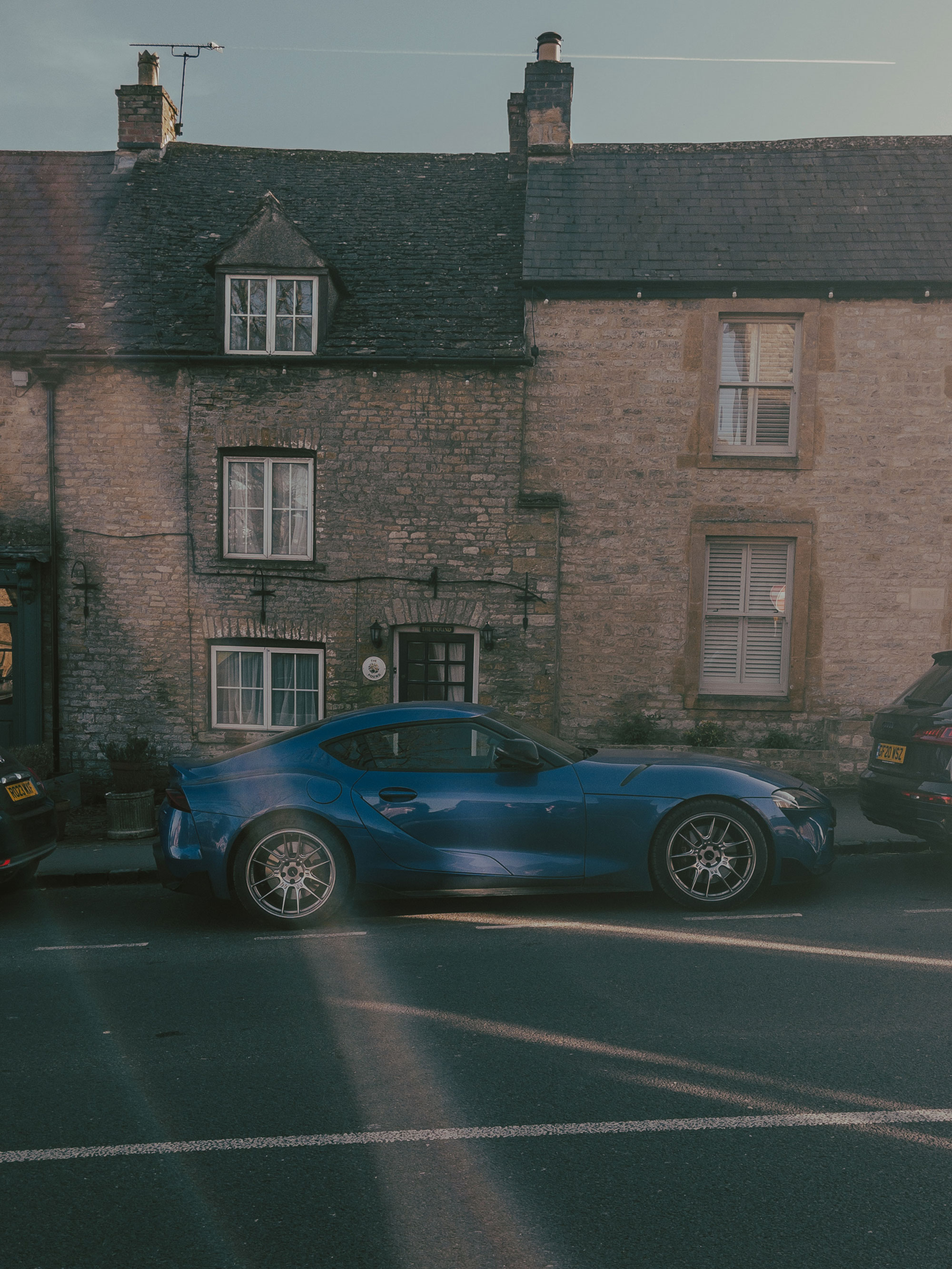

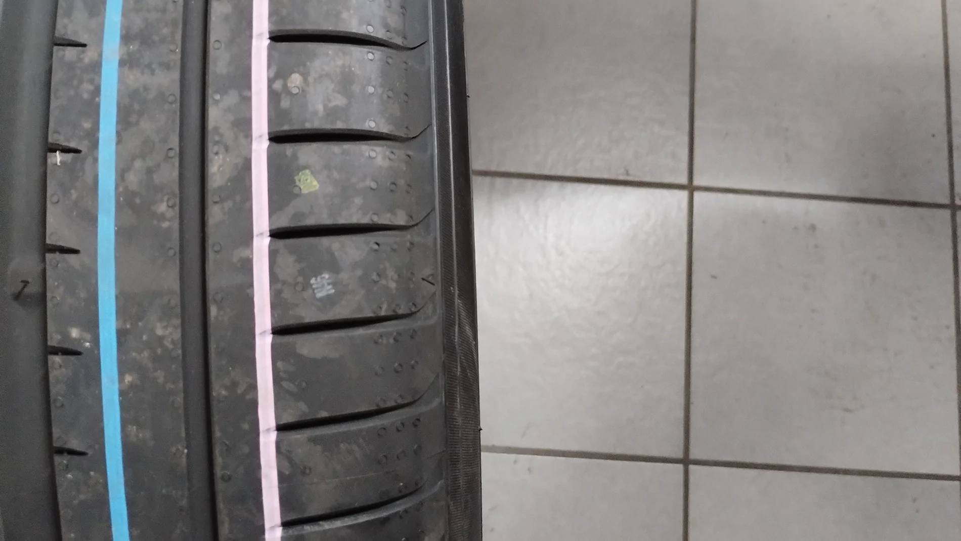

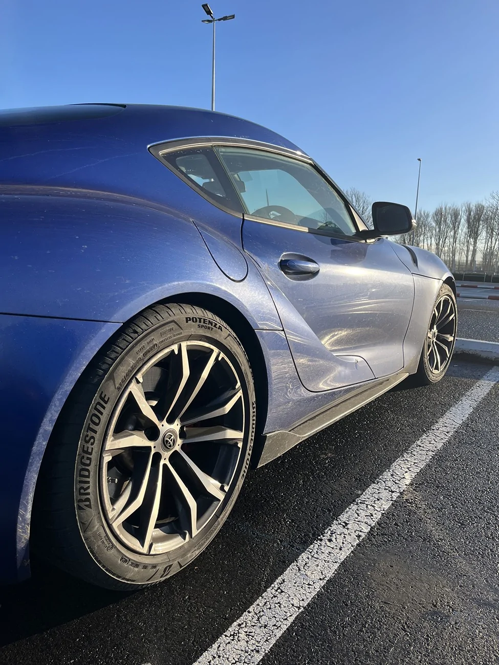

Actually, hold that thought about what I said regarding OEM wheels and tyres..
Found both tyres (OEM sizes on OEM 2.0 wheels) and stretch is roughly the same. I must have imagined that last bit, sorry :D
and the pss:
For the new ones, ok I'll go a bit wider still, at the rear.

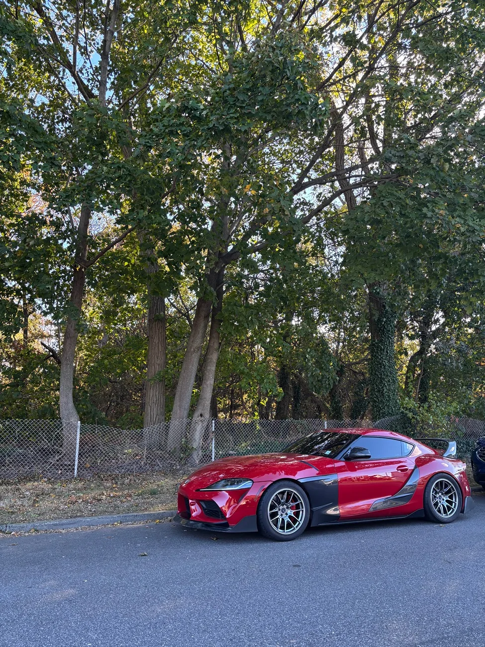

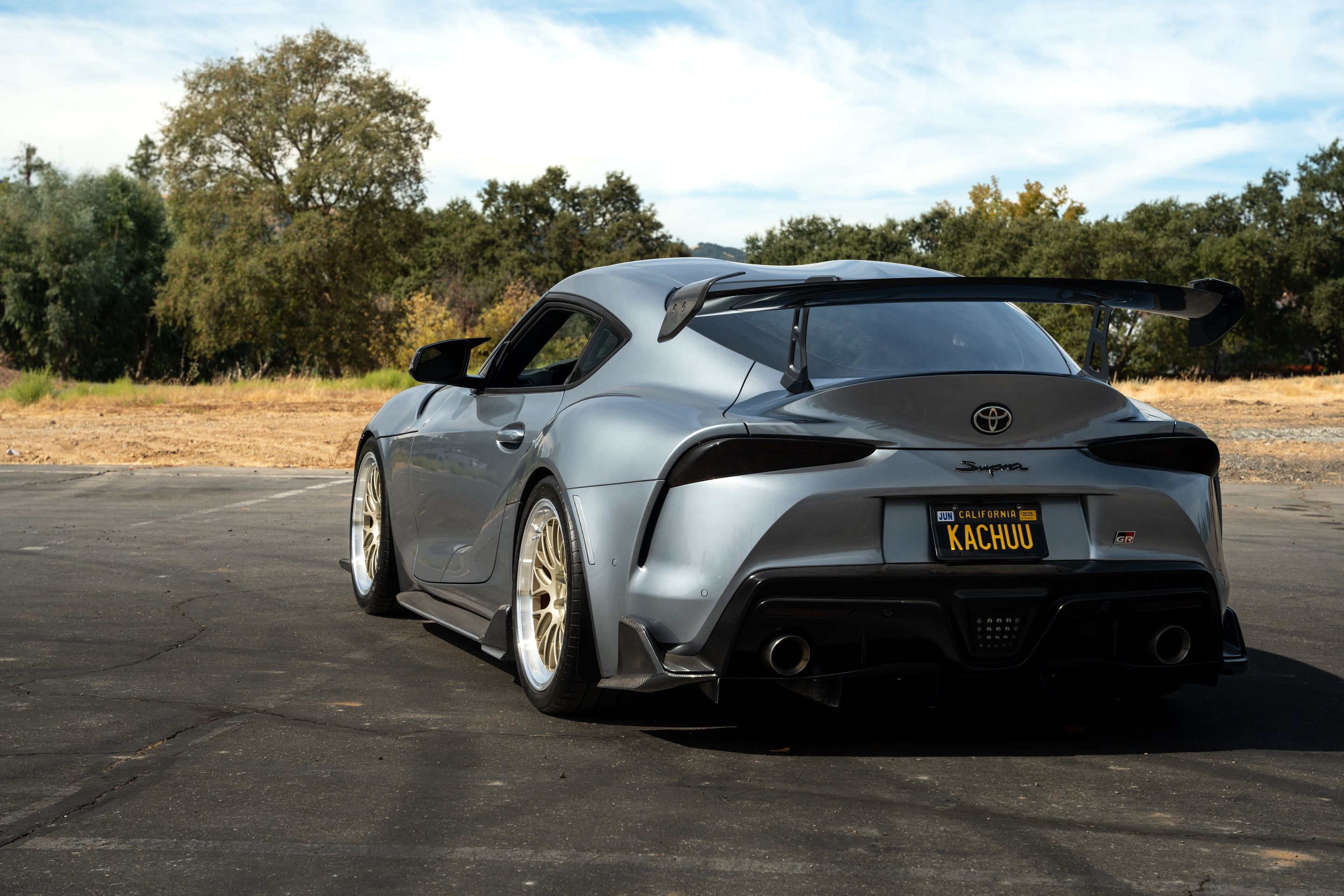

This car is running 265/35-19 up front and 295/30-19 Pilot Sport 4S in the rear. Same width wheels 9.5" and 10.5" respectively.
Usually the difference between section width and tread width is what gives a tire that more rounded versus squared off look. With shorter sidewalls, that look tends to be less pronounced regardless of tire.

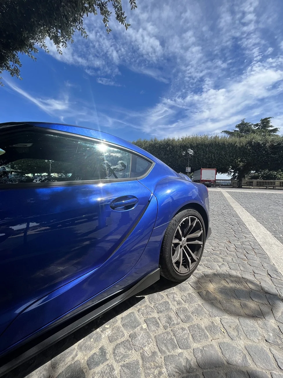

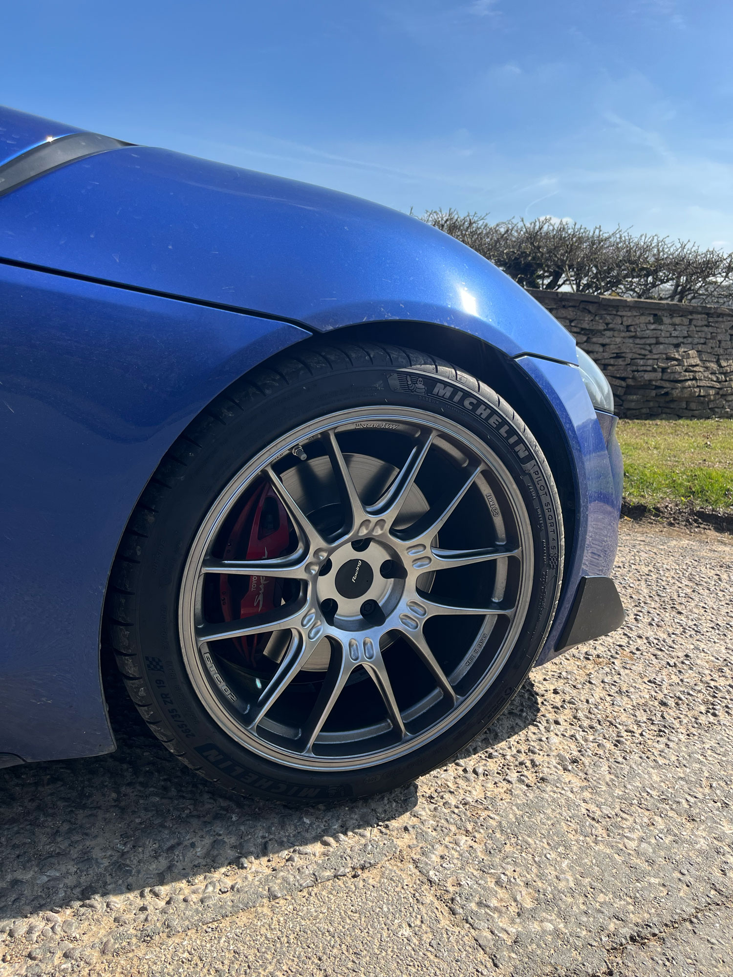

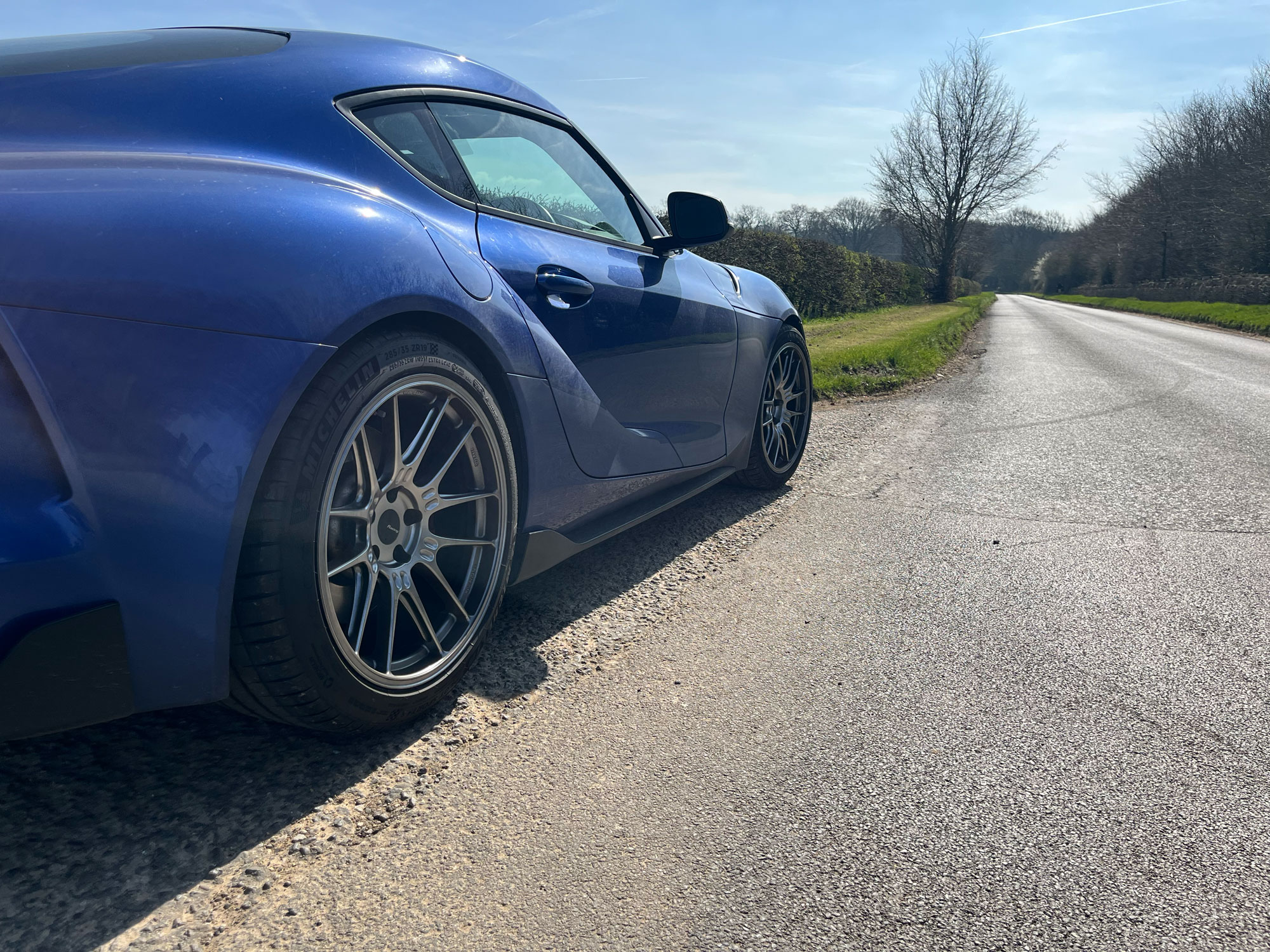

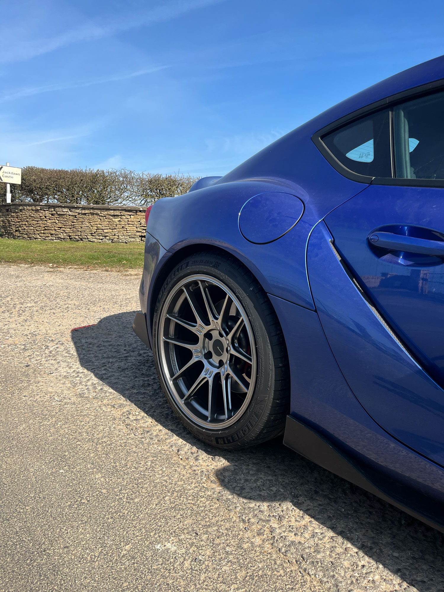

Just, for the record, and if it can be useful to others...
I did fit the wheels and new tyres.
I decided to go for 285 at the rear, after a quick test. As suggested by Apex (thanks again for the knowledge share!) there is a fairly mild stretch. Not terribly far off from the OEM PSS rear, to be fair (see second picture from post #6 above).
Front, 265, a bit more square.
Very happy with the result.
No rubbing or anything weird. Car will be on track in a month or so, so that will be double checked out :)
PS4S are noticeably, and pleasantly, less stiff than the Potenzas, despite 19" rims and less sidewall overall.
Now just needs a wash :D :D :D
