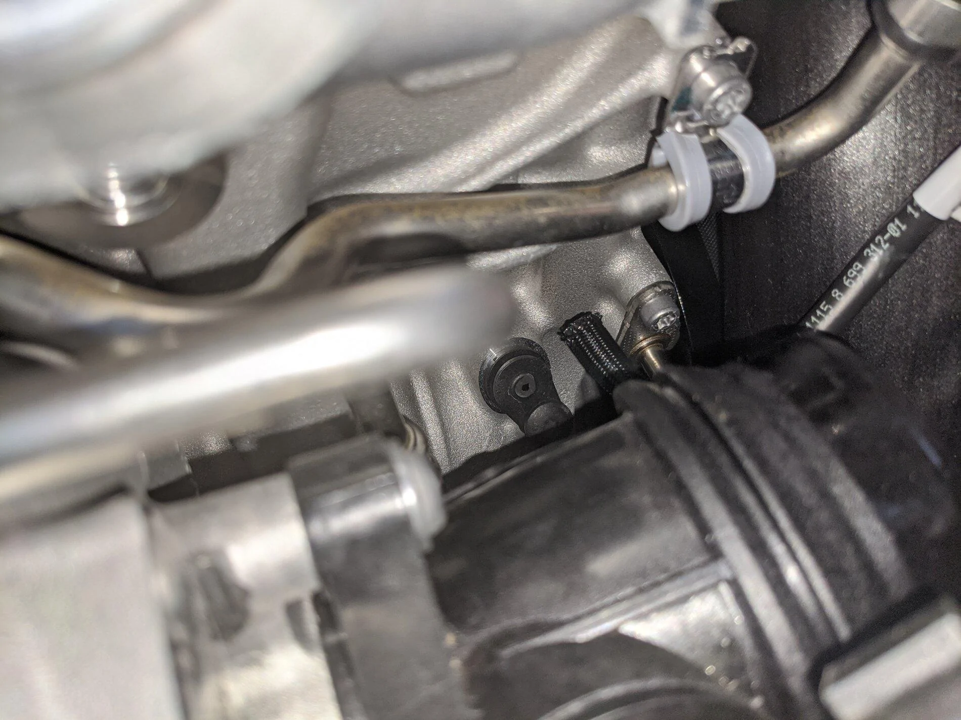

I broke mine as well. I have ordered it from 2 different dealerships in hopes one will get here faster. I'm really concerned I'll break it again however as the CTS turbo intake really puts a lot of stress on the inlet. Considering cutting the vent pipe and putting a silicone hose in the middle to relieve some of the stress.

Do what i did. Order one then install a catch can on the ccv side which converts the hose to a flexible one. You can also just buy a hose and follow the same instructions as the mishimoto carch can install

Thanks for the info. If you have a part number for your catch can I would greatly appreciate that. I got the new vent pipe, cut it in half and rejoined with automotive silicone hose that I had left over from my 93 Accord lol. It's now flexible at least. I don't like how the inlet is kinda floppy as well with the CTS turbo intake I installed.

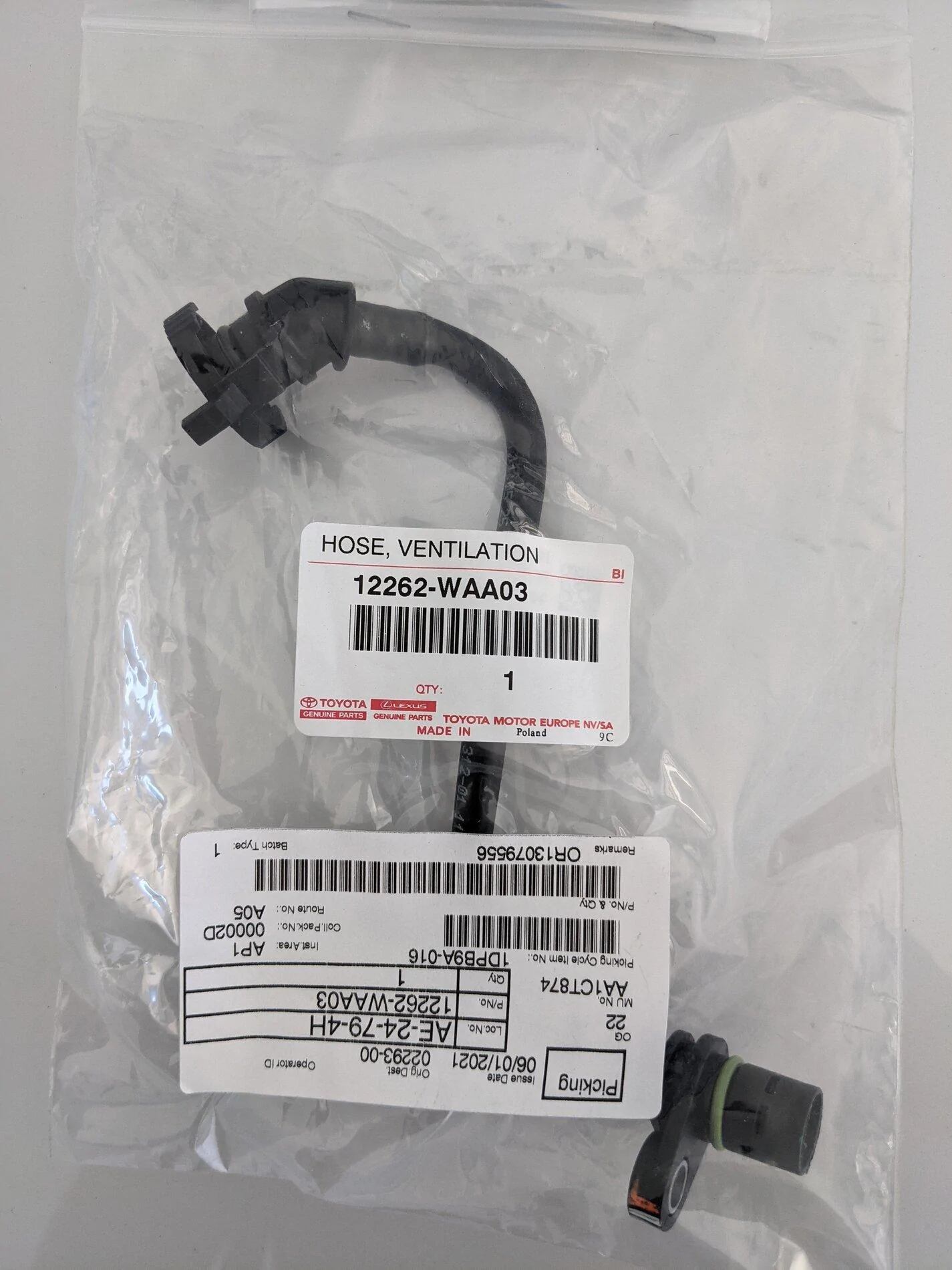

BMW part #:
  • 11158699312
You can order it from bimmerworld they do 1 day shipping if you need it fast

Different areas of the country. One had it in stock and the other said they could get it in one day. Ended up with the next day part getting here sooner. I cut it and added a silicone hose in the middle and has plenty of flex now.
