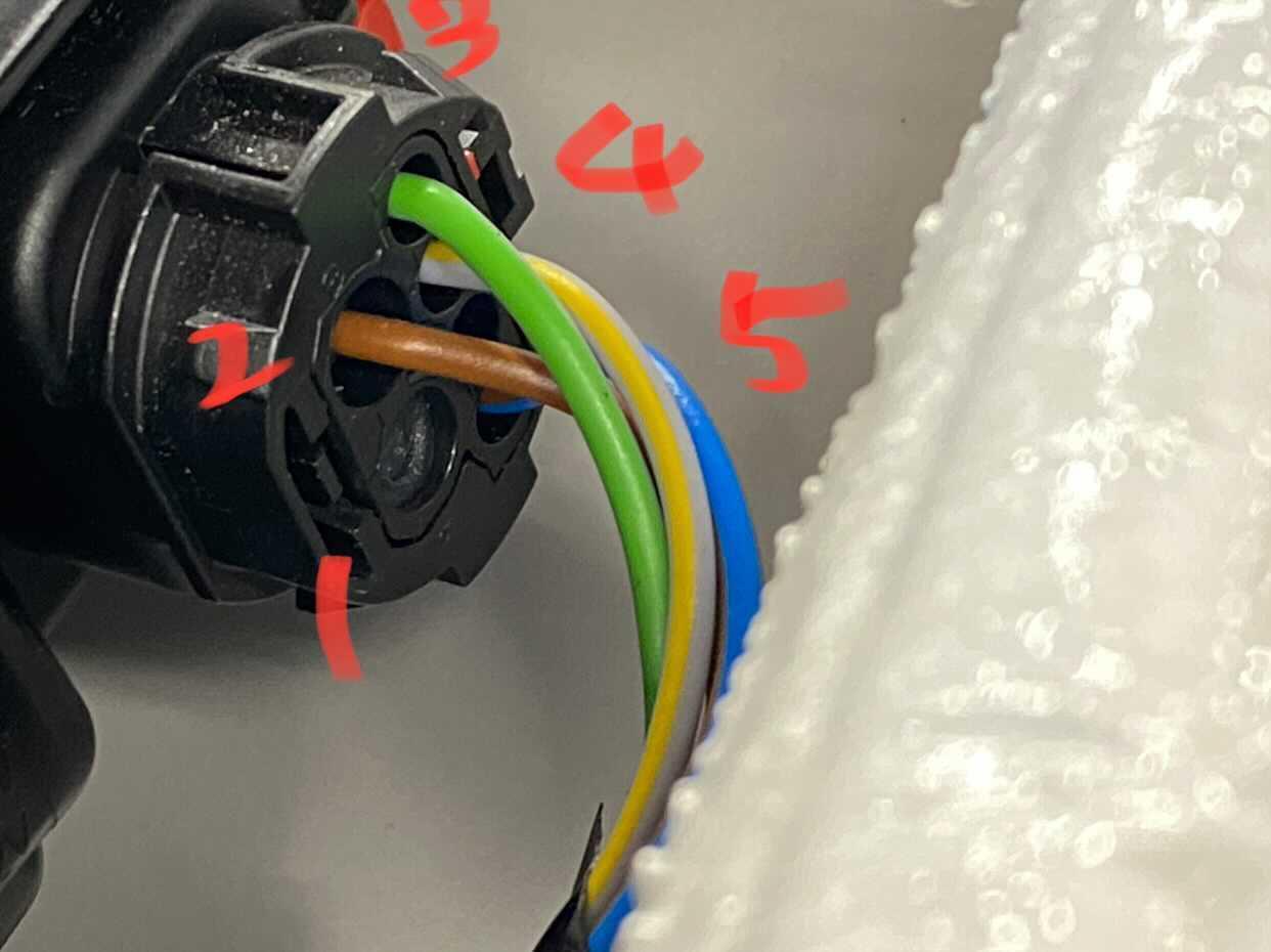

I have a Left Hand tail lamp on order, and the ETA is 8/27 at this point. I'll let you guys know as soon as it arrives.

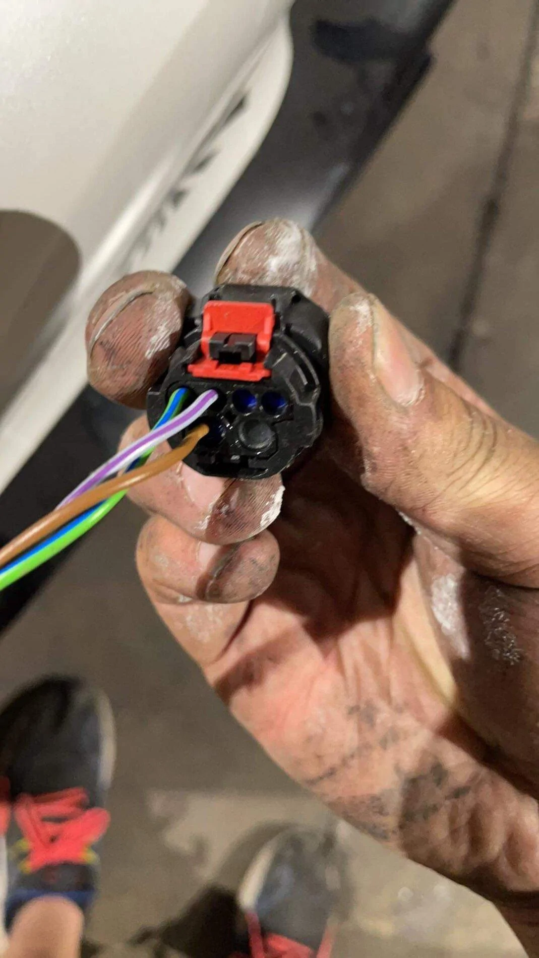

So the JDM pins are different from the USDM. There is an extra wire likely for the illuminated side markers. Can anyone help find the plug type?

ugh I knew it. I assume the top one with 3 wires the JDM one and the bottom one with 4 wires the USD one?
The taillights i don't think would have come with that wiring harness, so did you order the harness separate or is that JDM harness pictured above one you found on a website?
I looked at the Workshop manual (https://storage.googleapis.com/a90garbage/2020 Supra Workshop Manual.pdf) but not seeing wiring schematics on there.
The easiest way to tell is if you can put a multimeter at each pin and at you should be able to find out which wire does what. (fyi- Brown wire for BMWs have almost always been for Ground, not sure if that's still the case with the new generation BMWs but it was with my M2)
So if that Blue\Brown cable is indeed for the sidemarker, then it is very possible that there is no LED chip inside that part; which would mean you'd most likely need to code the car to disable that light function to prevent an error.
I suppose we'll just have to wait for FuzzyRev85 response when they get the taillight.

ugh I knew it. I assume the top one with 3 wires the JDM one and the bottom one with 4 wires the USD one?...
I have some friends in Japan who have supras. The top pic is the usdm. I believe japan requires the illuminated side marker in the lamp hence the extra wire. Anything brown is definitely ground on bmws as it is on my m4 too. Good thing is that coding the taillight monitoring out is pretty simple. I hope that it's using simple 12v signals and not a chip sending specific signals that I'll have to figure out...
