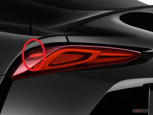

Does anyone know if the Foreign Market Tail lights are direct plug and play to US model Supra's...? For those who don't know, the Foreign market tail lights have an independent signal light within the brake lights rather than the brake and signals sharing functions.
Part Number: 81560-WAA01 (Foreign Market)
Part Number: 81560-WAA02 (US Market)

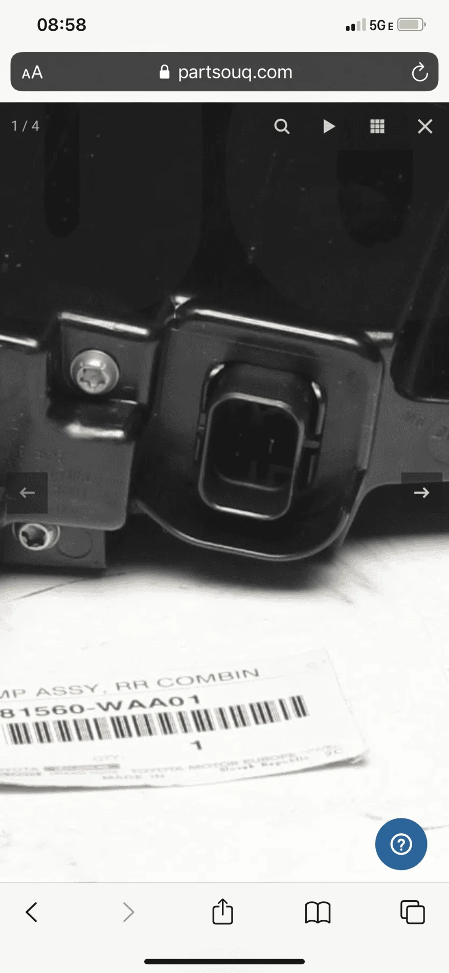

I don't know if they are plug and play because I haven't been able to get a solid picture of the connector yet. But we did discuss this briefly in the USDM Headlights thread.

The plugs shape i'm sure is the same across the board. However, i'd imagine the wiring pin configuration is a little different.
In addition to the Amber Turn Signal, I've noticed in watching some videos from Supra's overseas, is that the corner "parking" light is not illuminated at all when the lights are on with the Euro\JDM models, whereas here in the States it is. Heck, there may just not be an LED in there. Because of this, I also think coding may be required (using apps like BImmercode), otherwise the US-Spec car might thing that light is malfunctioning and may give you a dash LAMP error.
