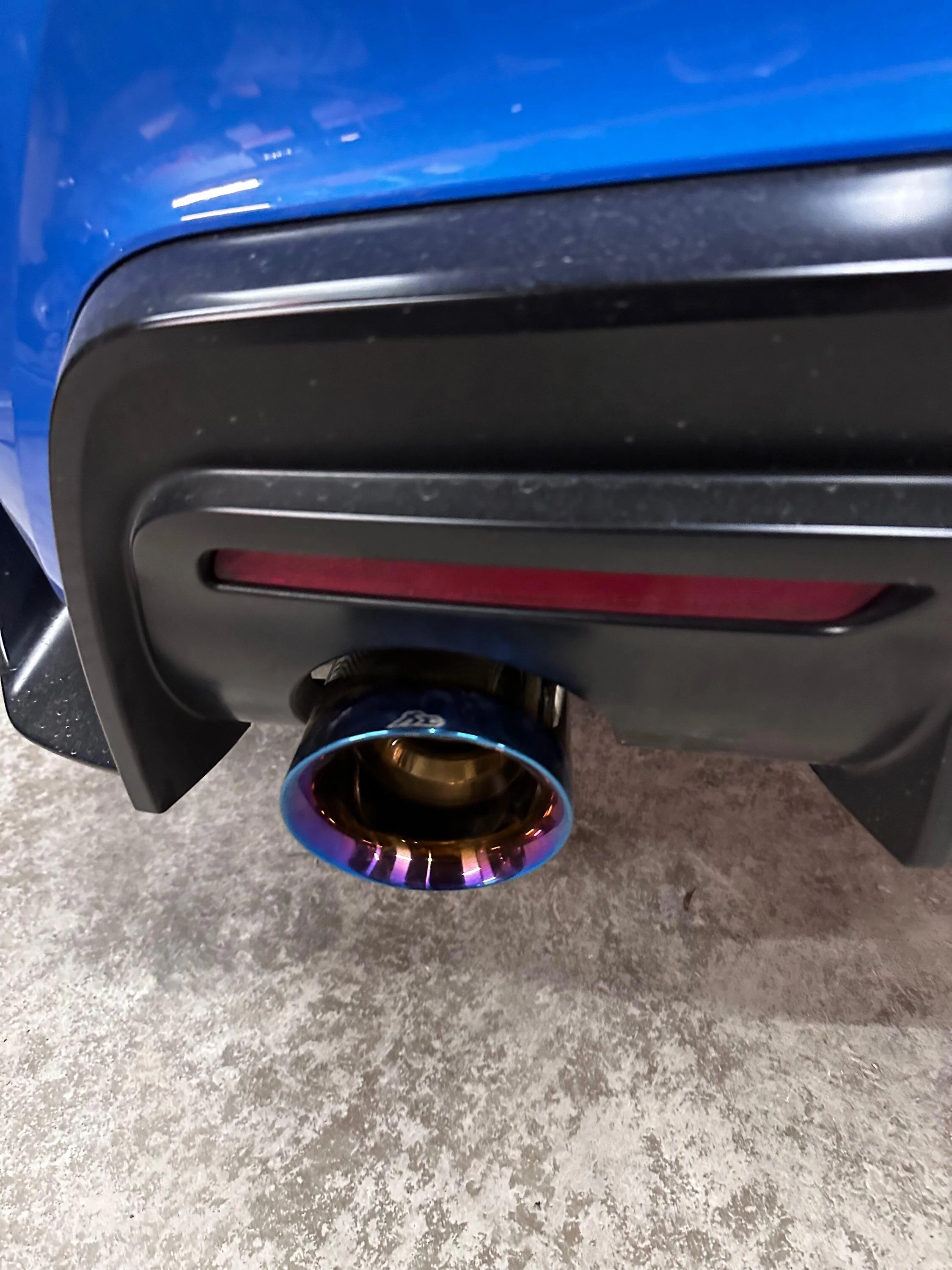

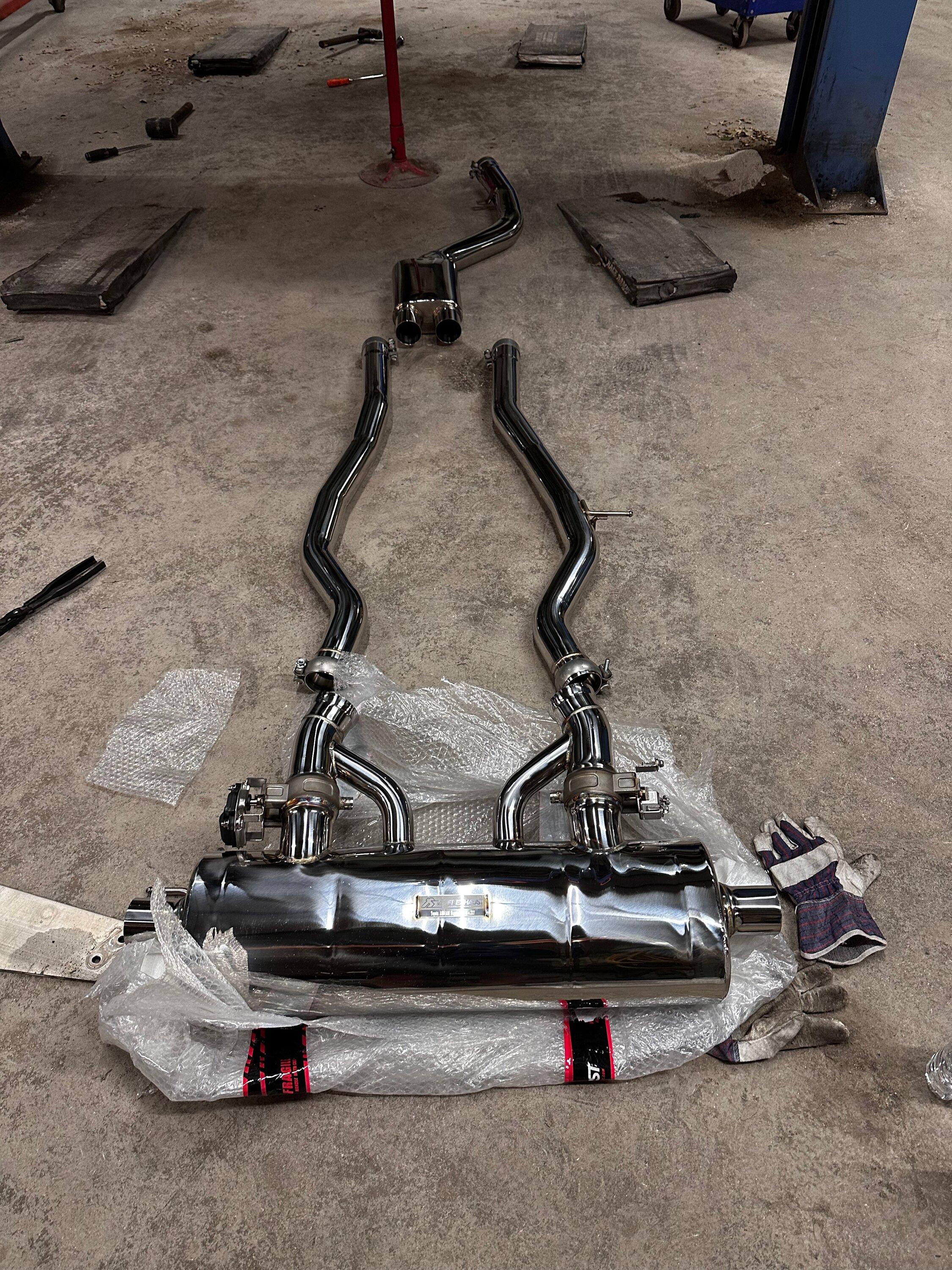

Apparently I'm pretty good at wasting time and money messing with different exhaust setups. I recently had the chance to install the Fi exhaust, so hopefully my impressions helps someone. When I was looking at all of the catback options, I almost dismissed Fi due to the cost and the fact that you can pick up various titanium exhausts at this price point.
This system is constructed from polished 304 stainless steel and stood out to me because of the exhaust tone (from the few videos available), and the dual valve feature. Most catbacks for the supra have either no valves or a single valve option. Most people will be fine with this, but it’s a nice feature to have. Another one of my criteria is NO drone. This isn’t a straight piped dodge challenger nor a loud, diarrhetic '94 fart can civic.
Keep in mind, this exhaust ships from overseas via DHL and I ended up paying an additional import fee. Shipping took about two weeks and DHL communication was playing hard to get. Fi certainly didn’t sponsor this purchase, and I’d share if it’s lackluster. @DSG Performance and @NitroYellowMKV were great to work with. Here are some different setups I’ve tried up 'til this point:
Active Autowerke downpipe + stock catback: This setup gives a mild to moderate bump in sound from the stock system. Frankly, many people would be satisfied with this OEM+ setup. I needed more sound and hopefully more character in the exhaust tone.
AA DP + Borla catback: Like a properly seared ribeye and mashed potatoes, this is a beautiful combination. I’ve had Borla systems in the past, and never experienced any drone. With this pairing, the entire car has far more presence and the burbles are pronounced. This is a single valve exhaust setup similar to the stock exhaust. Like others have mentioned, the fitment is a bit challenging to get spot on. And as with many valved systems, the valve rattles a little bit during the first few seconds of a cold start when the RPMs are inflated. If you’re a bit particular like me, you may notice the sound in sport mode is slightly biased towards the right (valved) side. You definitely HEAR the sound of the exhaust at lower gears but this isn’t the same as unpleasant drone. Borla is a solid option if you want a considerably aggressive bump in sound over stock at a reasonable price.
Fi exhaust + AA DP: One of my concerns was less volume than the Borla setup. The Fi catback includes a resonator, and a muffler for when the valves are closed. Lo and behold, when I heard the setup on the car, it was quieter than expected. So much so that I thought the valves may not be functioning properly. They were fully open and I even removed the motors to verify there’s no interference with any valves being partially closed. With valves closed, it’s similar to OEM. From inside the cabin, the exhaust does sound pretty isolated behind you.
The overall volume of the Fi exhaust is a moderate bump over stock. Like stock, the tone is tame but the burbles are a bit more distinct. You get the occasional extra loud pop on downshifts. Compared to the Borla, burbles in the lower RPMs are more muted. This is why it’s difficult to capture exhaust loudness and tone in videos. In all of the videos of the Fi, it sounds like an absolute menace, but everyone is really getting on the throttle in those clips. With folks like Stradman hyping it up and the pricey buy in, you want to like this system. The sound was much less in your face than all the video reviews I’ve seen seem to suggest. You’re also not shedding much weight compared to the stock setup. One massive caveat is if you’re going fully catless, this system might provide the perfect balance depending on what you’re looking for. I’d superman punch the cat out of my downpipe if I could easily tune. Fi is a bit like the fine dining version of an exhaust; pricey, palatable, but leaves you wanting more.
Positives: Super shiny, solid fit and finish, some of the best looking 5” tips, has a cool logo, dual valves offer balanced sound, zero drone.
Should you buy it? I’d say if you’re not looking for a crazy loud system and have the coin to spare, go for it. I took a bit of a hit on the price to resell such a new system, purely because I preferred the meaty and less refined sound of the Borla. For a similar cost, I would rather experiment with some lighter, more exotic titanium systems.
