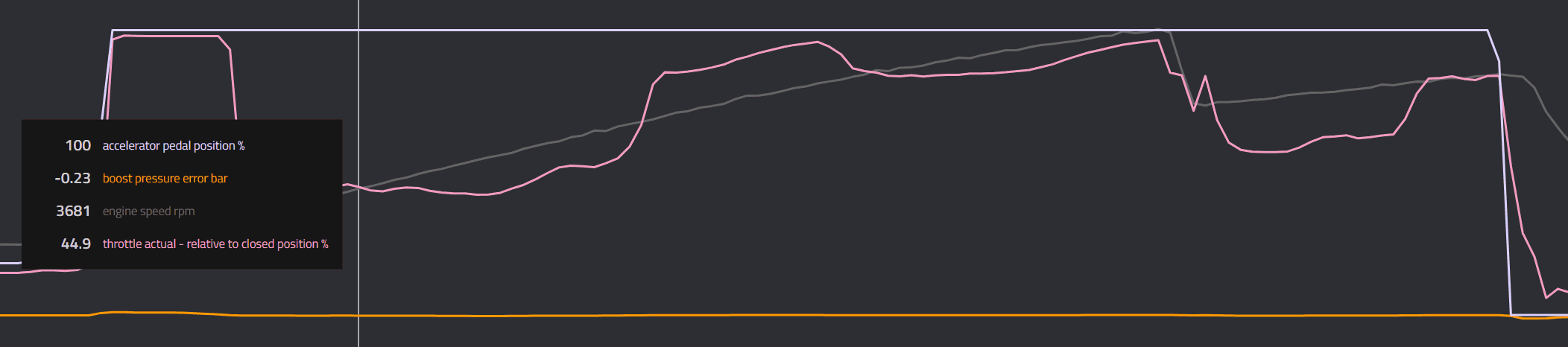

Hi everyone,
I've been logging my car lately and noticing pretty consistent knock retard and some ignition retard. is this normal/to be expected? Car is tuned on Ecutek, 98RON fuel. added downpipe, exhaust and intake, everything else is stock.
log can be viewed here https://datazap.me/u/bad90t/7-mar-2024-sport-mode-bp98?log=0&data=15
and here https://datazap.me/u/bad90t/7-mar-2...data=15-27-33-34-35-36-37-38-39&zoom=958-1139
Would really appreciate any help interpreting this and determining whether i should go back to my tuner.
TIA

30+ psi of boost or 2.2 bar, sounds like a high amount of boost for current setup.

Likely just due to the fuel. Any way to raise octane? the knock does start to clean itself up.

The boost is -1 bar from the actual reading you see on the log, so it should be about 16-20psi.

Can we make it a preference that people replying to logs actually know how to interpret logs correctly?

Even at the start of the log i get ignition retard just cruising.. anyone know why would this be happening?
