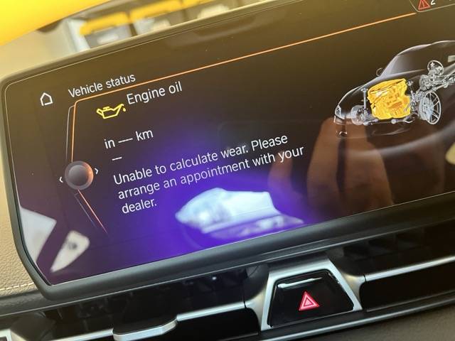

Went for a short drive and it's a nice little power bump.. but I got one of these to dampen the mood.
I presume this is just an artifact of the MHD OTS tune. Oil levels are fine according to the iDrive check. Does anyone know I can get rid of this? Clearing codes on Bimmercode doesn't seem to affect it. Ugh.

I'm assuming the historical oil change data is now missing and the system can't calculate the oil wear data. Can you reset the oil change required notification to zero it out or does it need to actually be presented to do that?
Itll be fine. Had the exact same thing. Goes away after couple of car cycles. Think I even had it come up another time but always went away. I've reflashed it probably 10-12 times and only gotten it twice.
Yeah cool. I've reached out to MHD but will just try and drive it out. ?

Worse case you’d reset the oil like Phil mentioned… I get occasional gremlins to show up from the minor little things I’ve done & they go away. Still bet she’s going to feel more lively & you’ll be happy as a pig in shit by next week.
