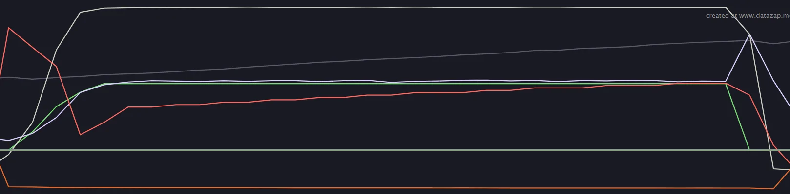

What are you logging with? Your sample rate still looks crap, unless this is like a 1st or 2nd gear pull?
EDIT: After looking at the actual log, doesn't look so bad.
4th gear! Got rid of a lot of parameters too. Yep just need to work on the more dynamic boost stuff, partial throttle, shifting, etc. Then I'll start turning it up.
8,810
17,286
Make sure you log TPS too so you can see if the throttle is closing.
It's good practice to let the PID raise WGDC to meet target boost instead of reducing WGDC to meet target boost. So leave a little buffer. Just know that WGDC for a given boost target will fluctuate in cooler and warmer ambient temps. So make sure your PID tables have enough headroom for when things get warmer.
