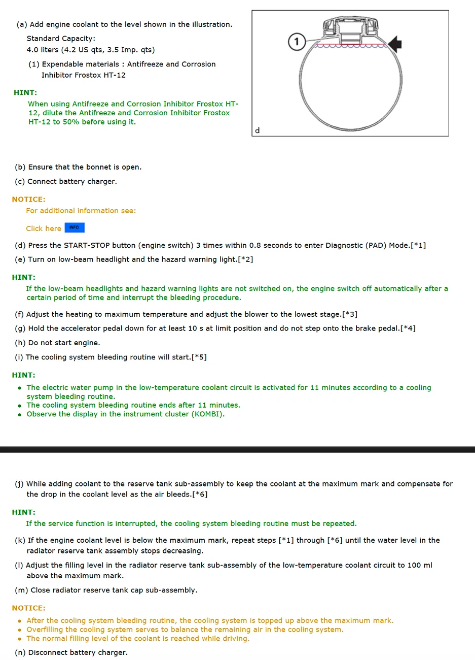

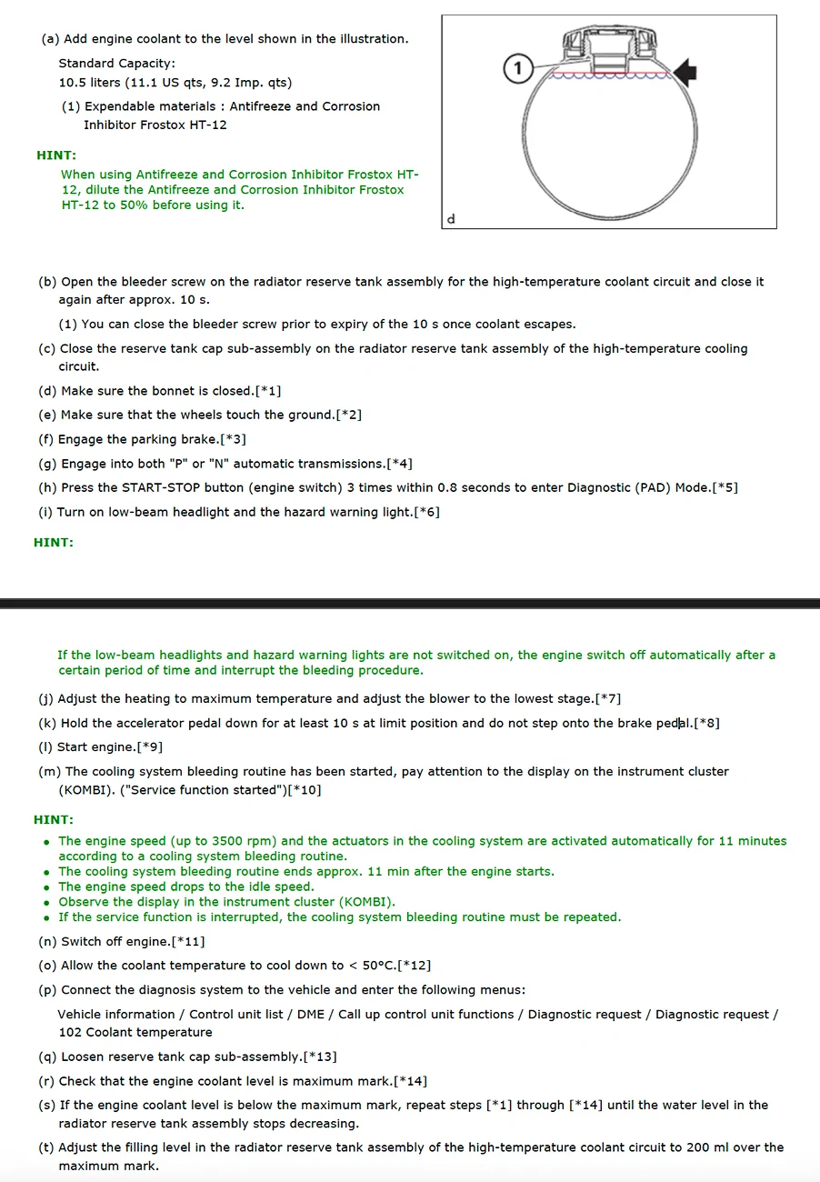

Meh.. I searched online all over the place on how to do a coolant drain and fill on my 2020. I don't have a vacuum fill device and don't feel like getting showered by coolant..twice. but I also don't feel like taking my car to the dealer just for this. Can the Supra survive gravity fill? :crazy:

Not sure if there's a good way to drain the coolant other than disconnect the bottom hose from the radiator. I haven't personally messed with the cooling system before.
For bleeding, this should work:
https://www.supramkv.com/threads/cooling-system-bleeding-for-mkv-supra.4824/post-73515
Be warned, car will rev to 3.5k rpm during the process, might be worth getting an exhaust silencer, or just going to harbor freight and getting the vacuum bleed device :D
edit: Also worth noting the bleed procedure may be different for the low temp circuit. not sure off the top of my head. I'm sure there's instructions in that thread.

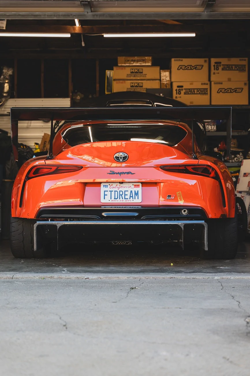

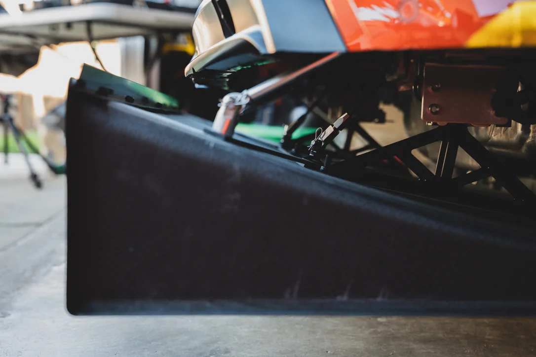

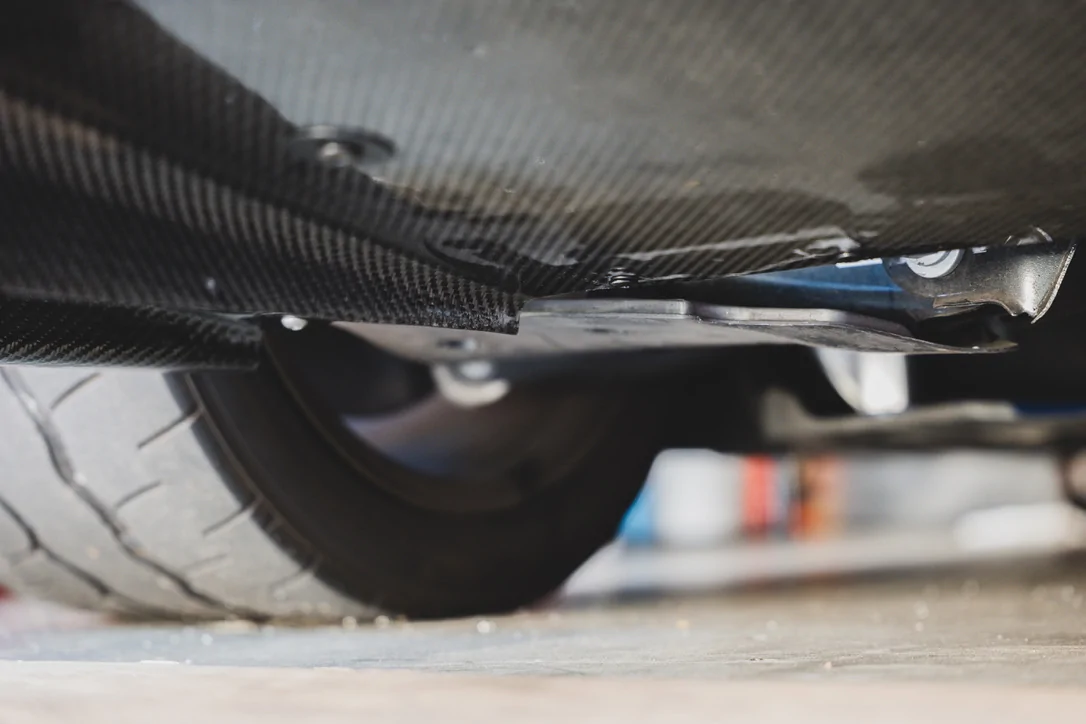

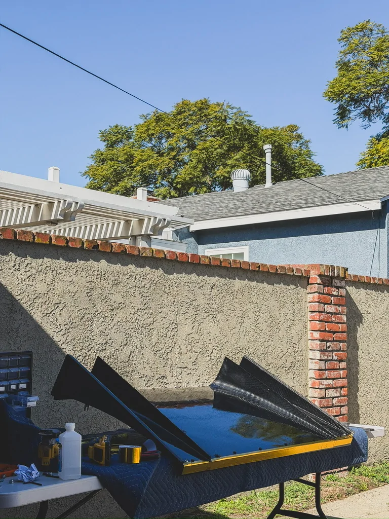

I've posted on some of the work done to both the car and the diffuser itself to optimally run this thing but it's finally done.
I ended up not running the frame I had CNC'd to mount the diffuser. It made the setup way too heavy and my mounting points didn't allow enough adjustability. So after some consultation, I reinforced the center-top of the diffuser with really high tensile strength carbon fiber flat bars and the leading and trailing edge with aluminum angle bars. With everything weighed together, it came out to be 7.2 lbs. Overall, the process was a bit of a pain, but I'm glad it's done. Hopefully shakedown soon
