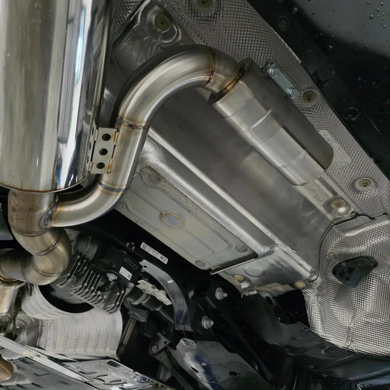

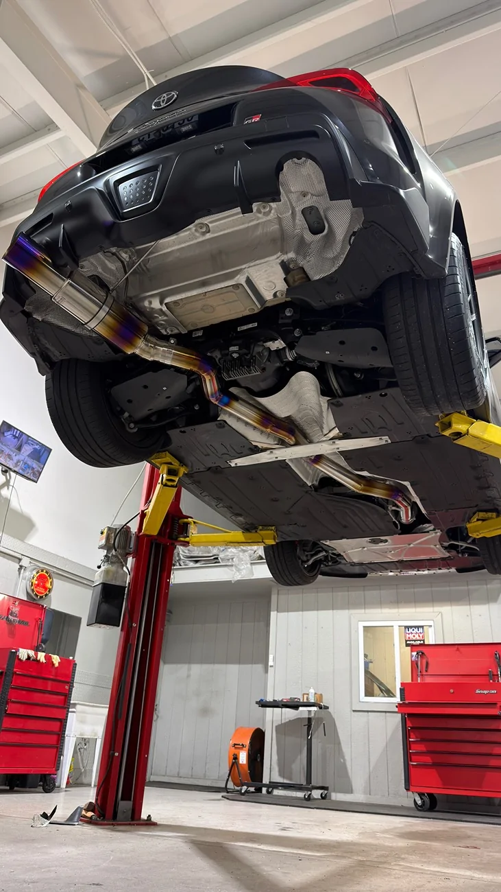

Had a Helmholtz resonator fabricated to combat drone from ~1900 to ~2300 RPM - seems to do the trick too.
What single exit is that?
