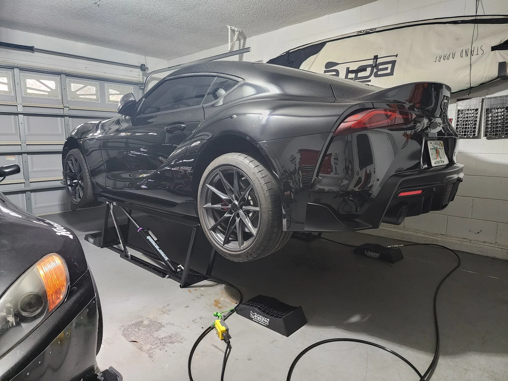

Any issues with those Megan racing ramps? I was looking at those for when I finally put my Whiteline springs on. I use the 7000 quick Jack and I barely clear at stock height
Davo307
David
Aug 30, 2024
192
310
Orlando
2024 Toyota Supra 3.0 Premium
Nope! They work perfect. I bought 2 sets off Amazon. Im lowered and have a front lip and I still clear fine.

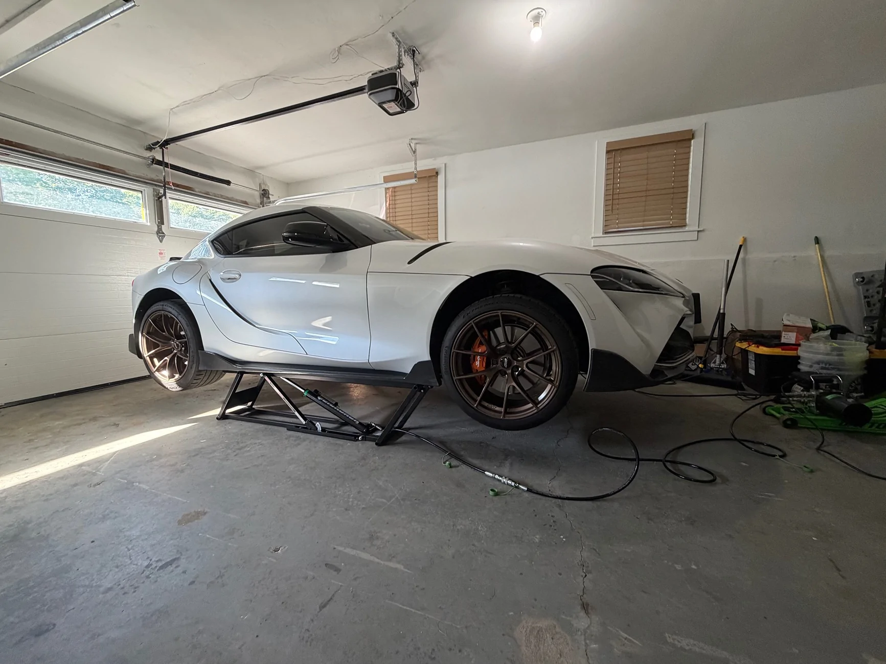

Bought quick jacks. Don’t fit under car. Comes with a large and small pad. Small pad won’t clear. Anyone buy the low profile ones?? Only on Whiteline springs. Not super low - it’s barely hitting by like 1/8”
I would just park on some plywood or 1x8 board. With the Supra the low pro blocks should be okay becuase the plastic jack points hang down a bit. But with other cars the side sill or plastic trays will hit the frame of the quickjack before the lift point/pinch weld touches the block.
