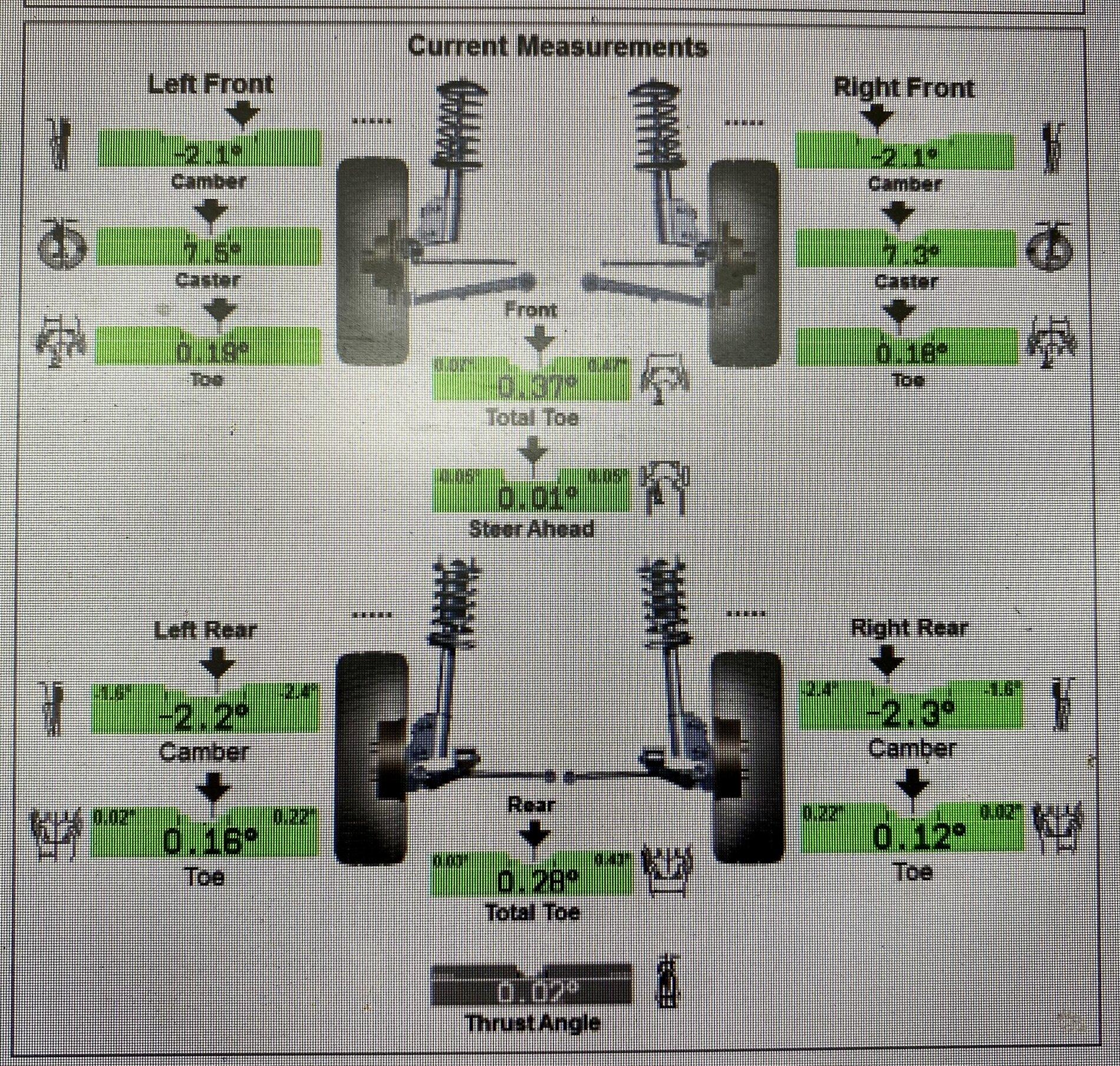

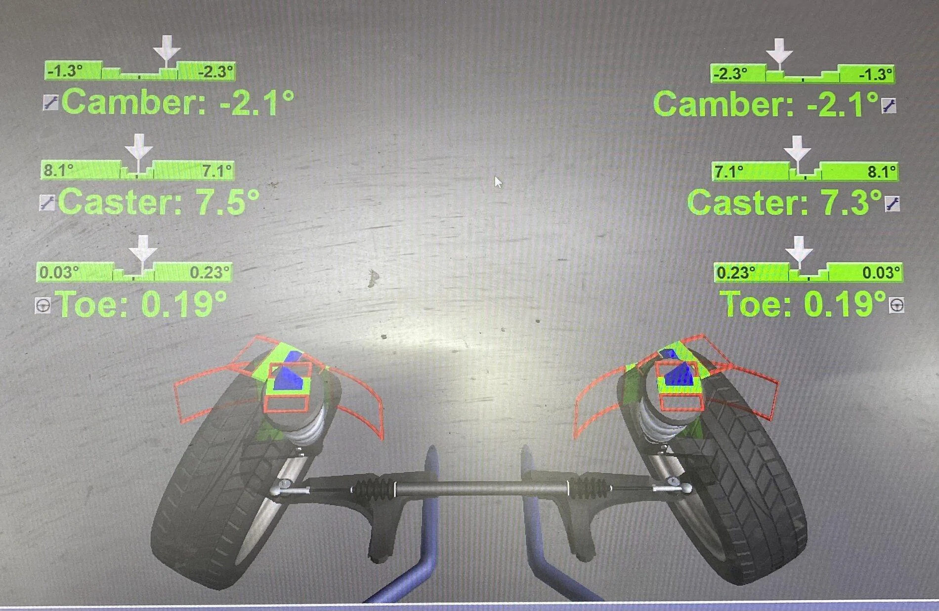

Cool, thanks, was wondering if springs alone are good enough for -2 up front. What springs brand did U go for? I missed it...
Euro Eibach Pro-Kit lowering springs
(Drop of .08” front & rear)
Euro Part # E10-20-046-02-22
EBay Seller link below: (no affiliation)
https://www.ebay.com/itm/184497855474
I’m also running Burger Tuning wheel spacers
(10mm front and 13mm rear).

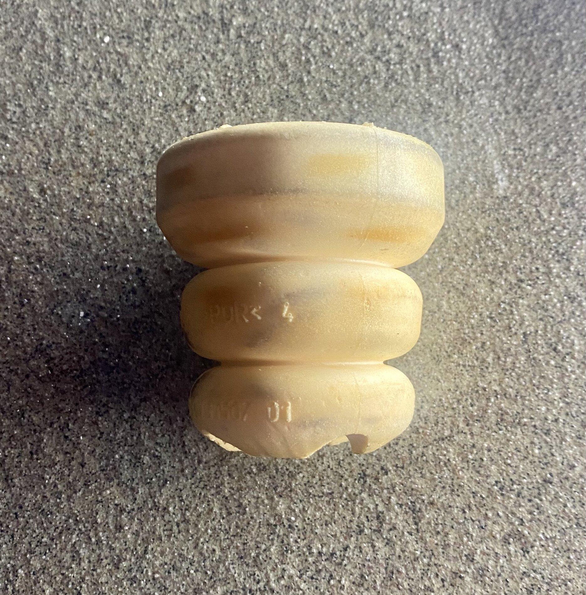

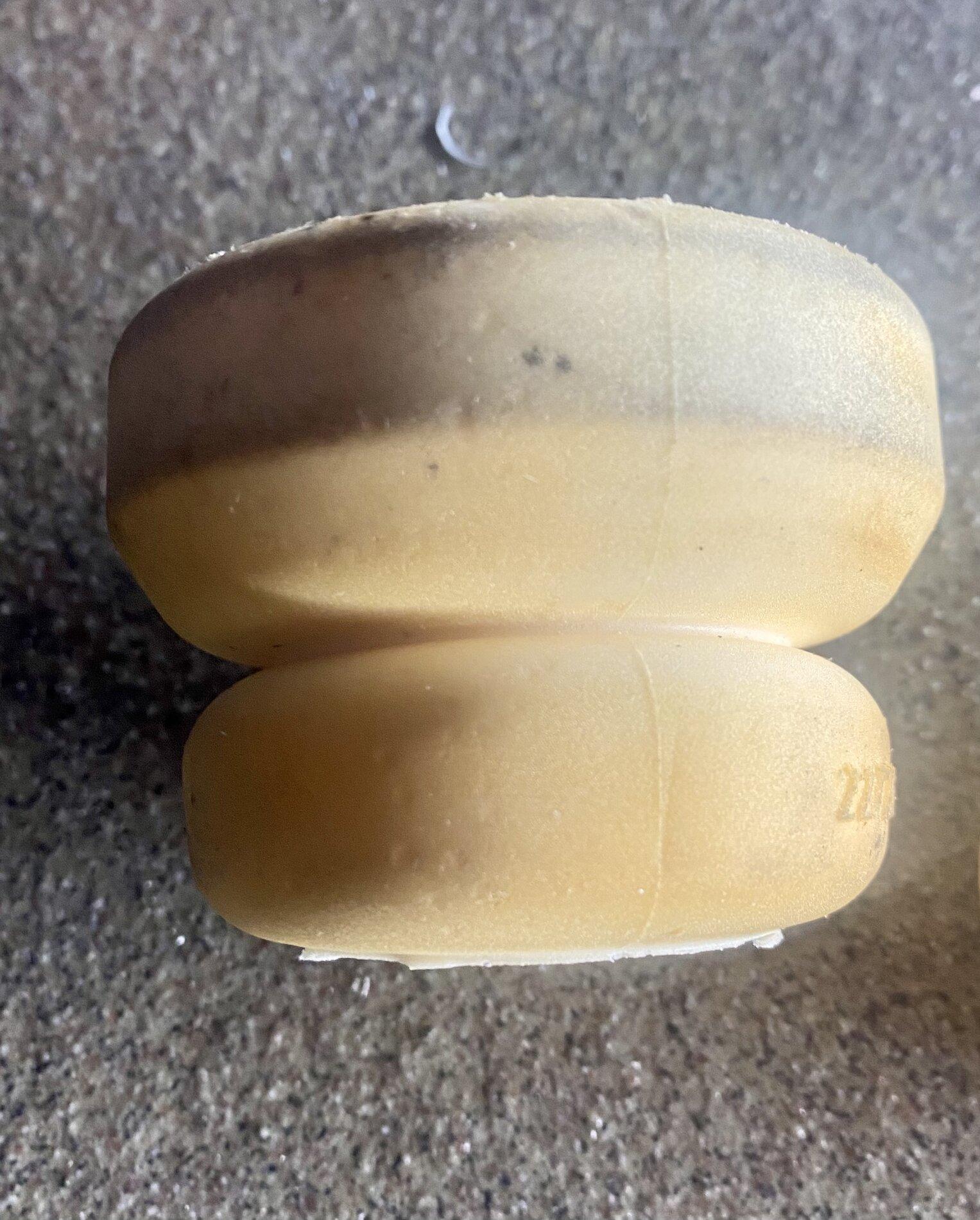

I'm in EU, so even better as its my go-to part :D
Did You cut bumpstops on those/did it came with fresh ones? Any clicking noise issues like some experience?
~ Yes I did trim my factory bump stops (one round section) front and rear. The euro eibachs do not come with dust boots or revised bump stops... you simply reuse the factory ones.
I’ve had zero issues with these springs (no noises whatsoever). They’ve been great and I have 600 miles on them thus far.

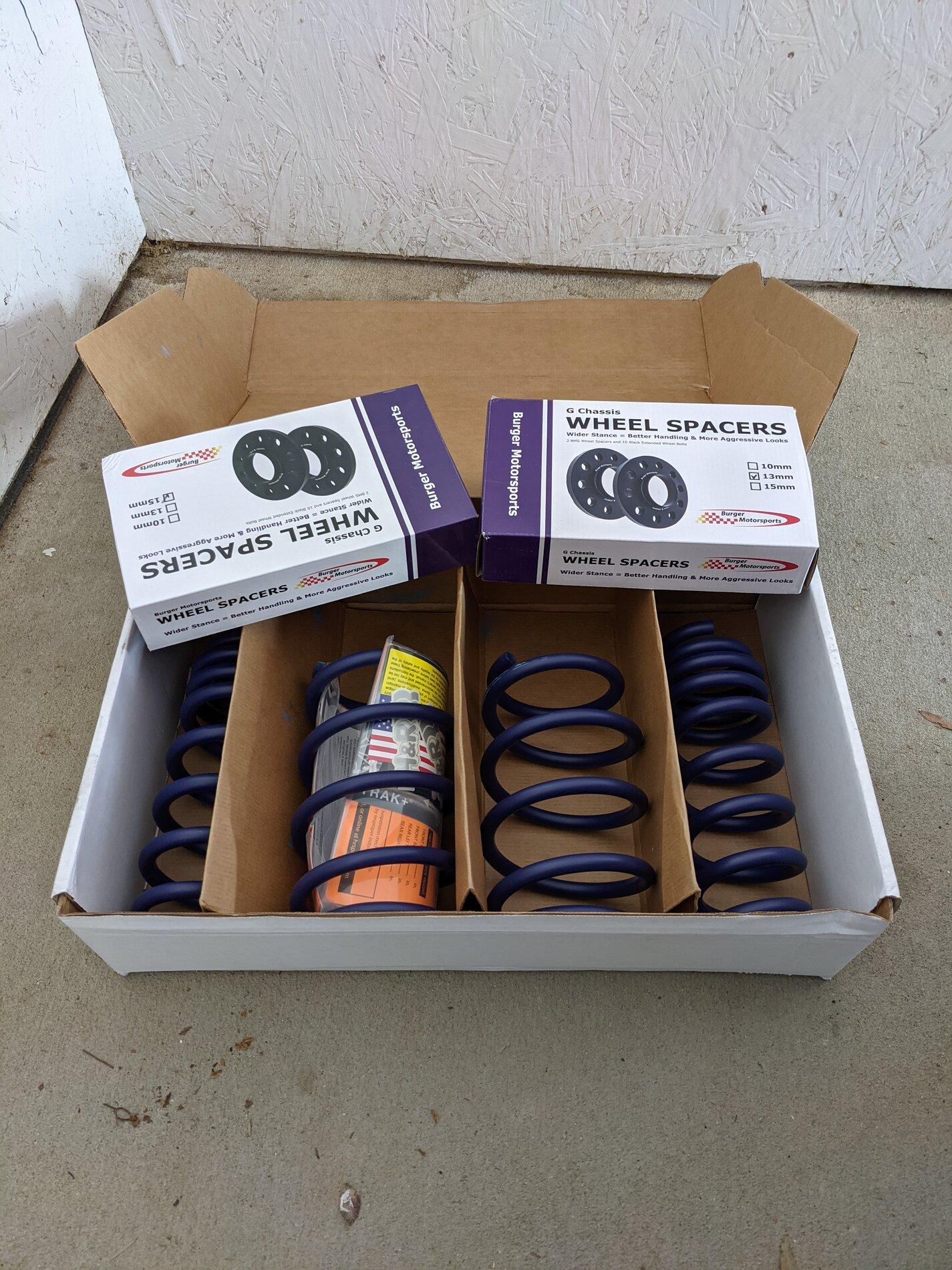

Getting these installed today! Yea bwoiii!
The springs are H&R. Didn't want to go too low but that fender gap needs to go.
