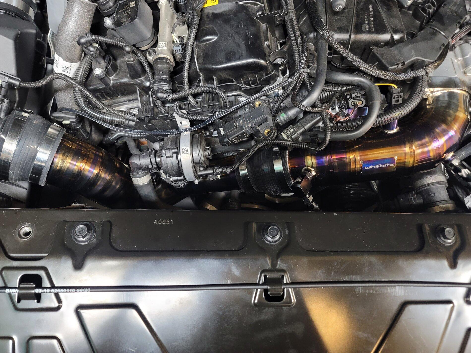

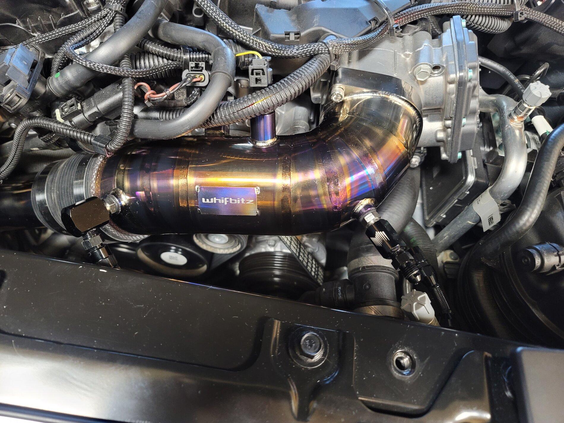

Got some new titanium. Still trying to figure out which intake box to switch to. Meth bungs where not very fitting at all. Had to tap them with 1/8 npt to allow my meth injectors to go in. Other then that they were great fitting. Just running the stock box back on for now. Either an armaspeed or mst with clear plexiglass is likely going in next to complete the intake side of things. Definitely not going open box again cause iat temps were too high this summer.

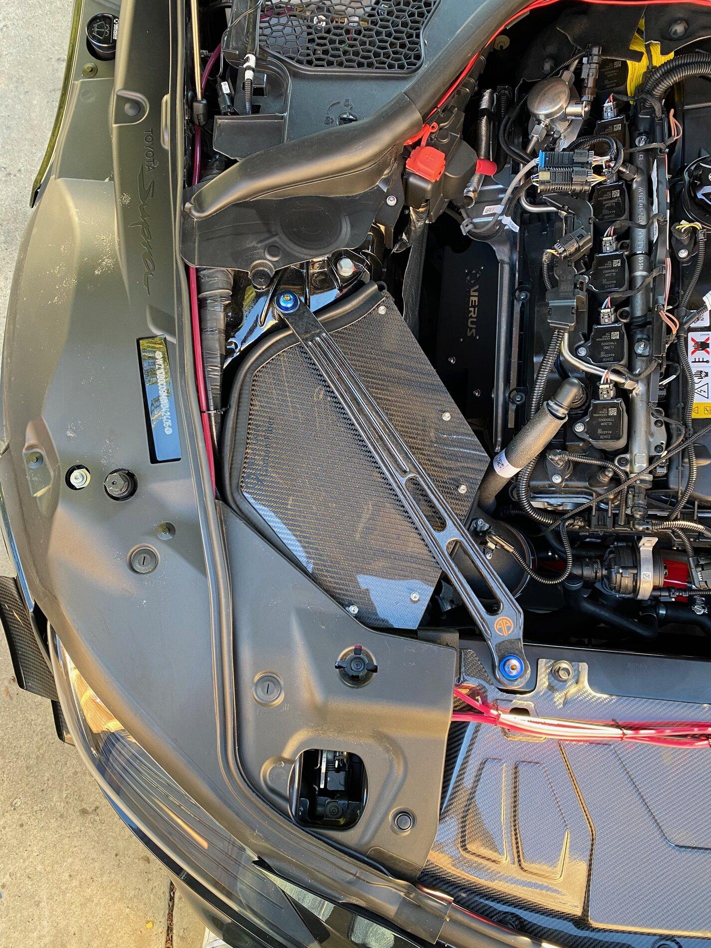

Is that the mst? I was leaning more towards the armaspeed intake with carbon fiber top but didn't think to do carbon fiber on top of the mst.
Yeah, that's MST with a CF lid that's in development. This is (as far as I know) the first test fit. If you go with MST, and you want a CF lid, lemme know and I'll throw you on the list.

Yeah absolutely! Put me on the list as long as it's not something that you think will take a long time. I am gonna want to get something on there fairy soon within the next month or two.

For sure for sure. I'll hit you up soon.

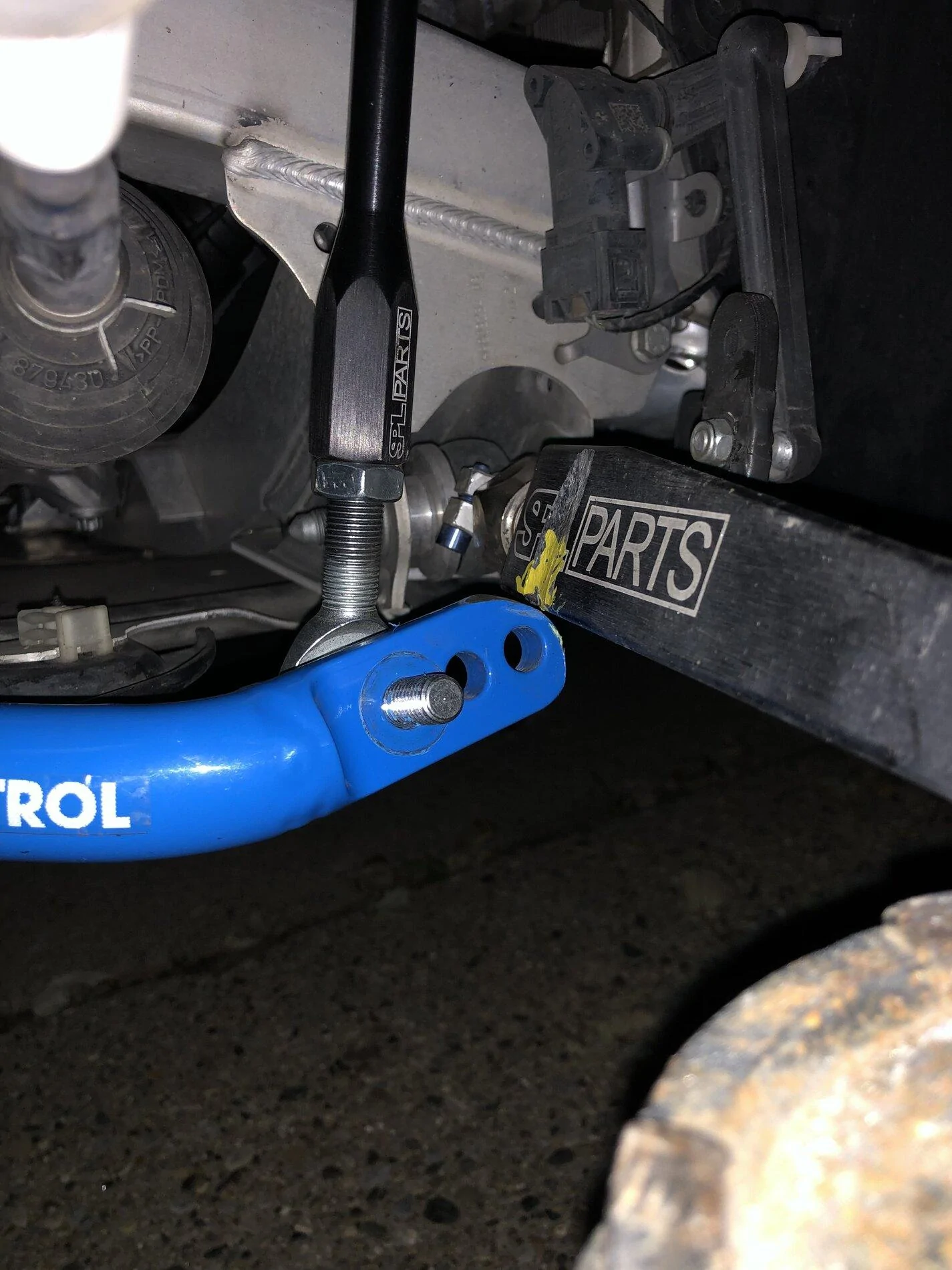

I had to chop off the softest setting hole on my sway bar because it was hitting my front LCA pretty bad, even with end links and my aFe sway bar pushed all the way forward. See photo (yellow paint is to monitor contact points).
Thankfully I don’t think I’ll ever use that setting and now It feel much much better.
