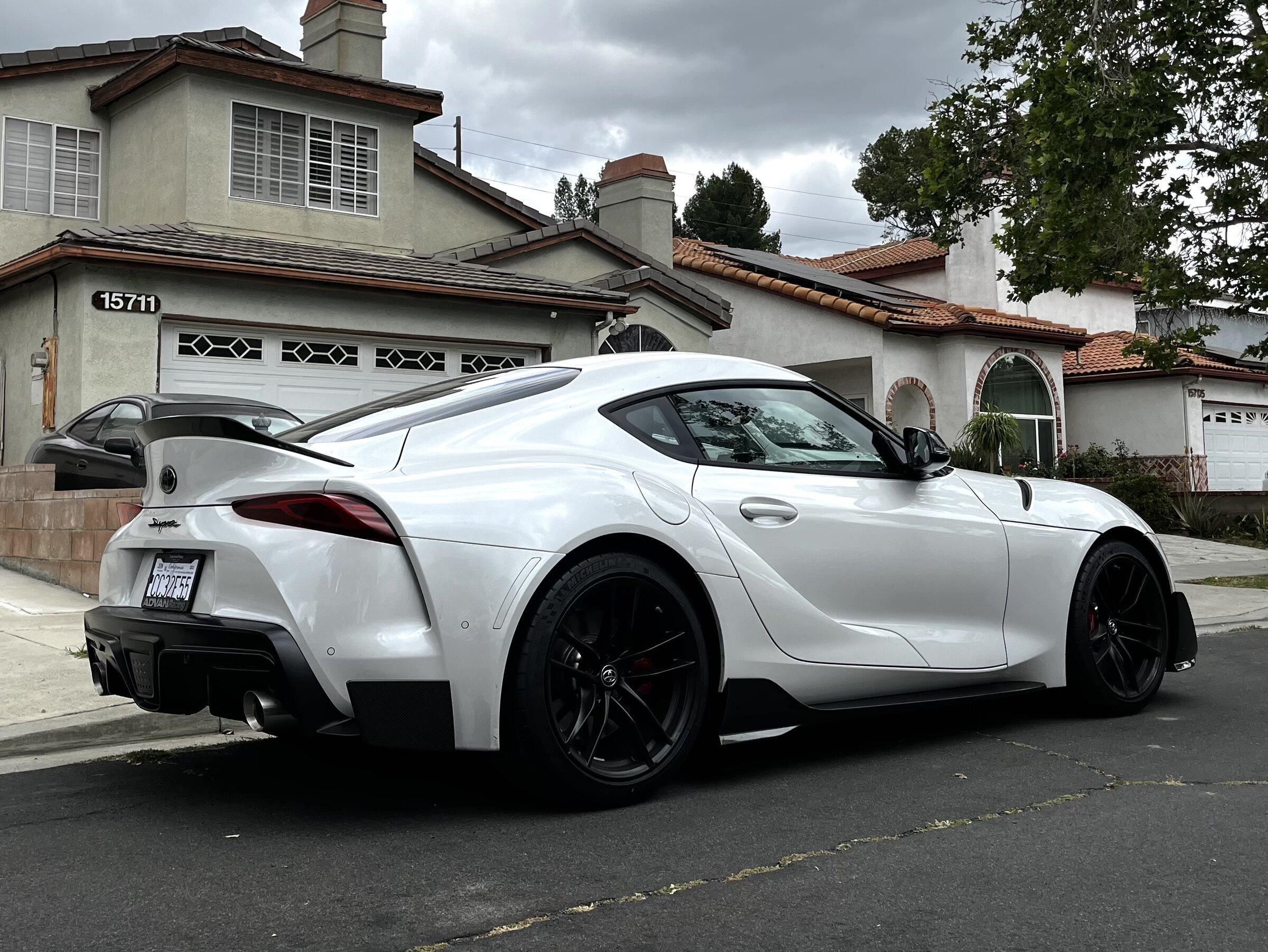

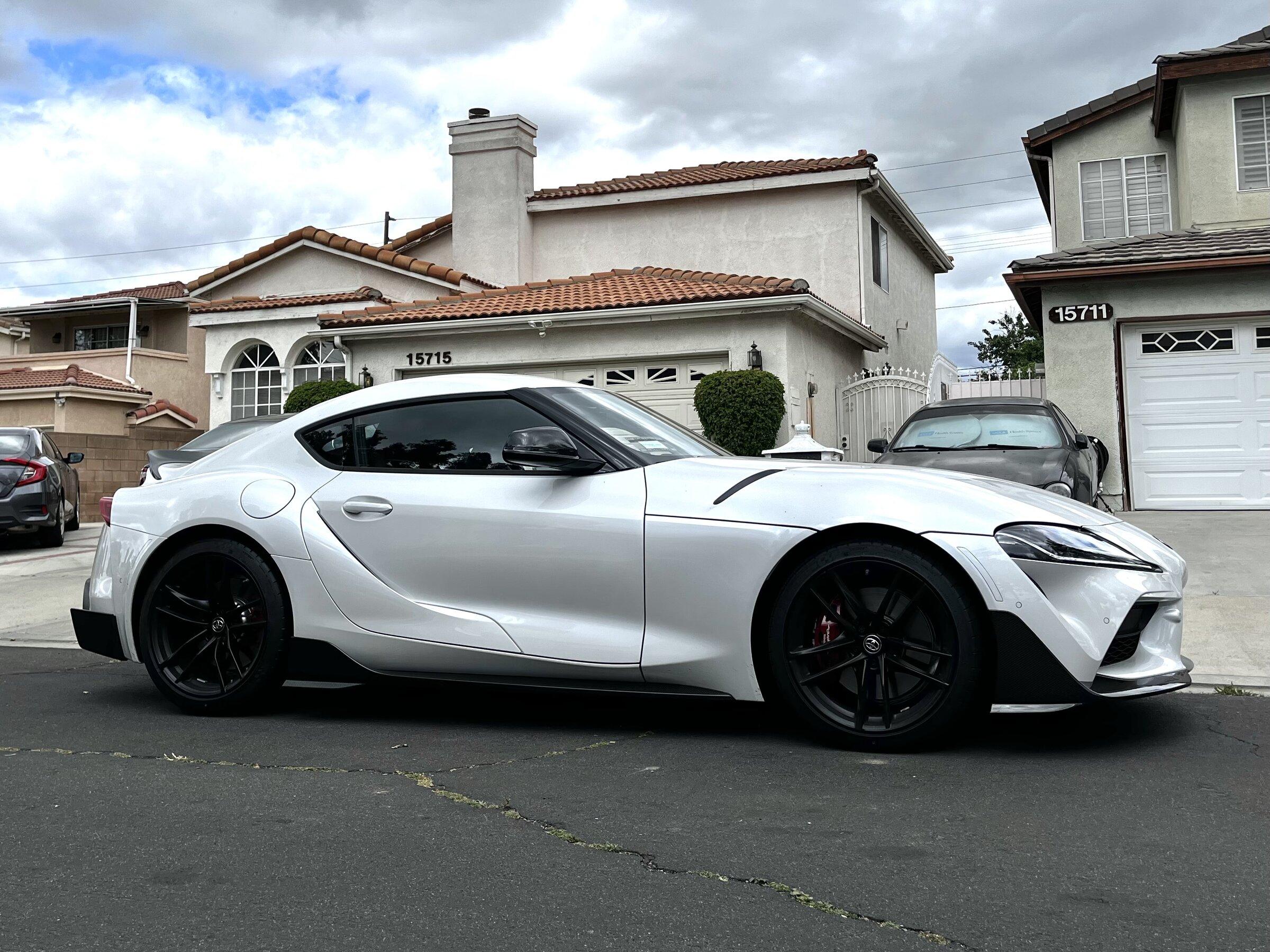

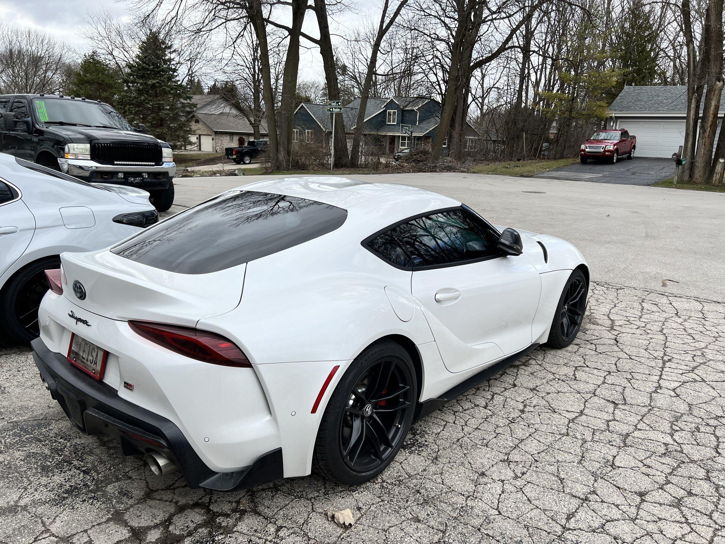

Another moderately fun install day done! This time around, I completed the reflector deletes with the iND front and rear kit. I also pulled the GR emblem off the rear while I had the heat gun out.
I know this topic has been covered, but I wanted to provide some additional install notes.
First, don’t be afraid to really put some heat into the reflectors. My car is only a couple weeks old so the tape was very fresh. After getting it hot (slightly uncomfortable to touch with your bare hand), I covered it with a microfiber cloth and pushed in. All came out relatively easy with enough heat.
I managed to install the fronts by turning the wheel and removing the 3 8mm bolts for the fender liner. There is a very limited amount of space to work back there, and working from the bottom up proved to be easiest.
For the rears, I was able to remove the 3 8mm bolts for the fender liner, and the 1 bolt holding in the bumper without lifting the car or pulling the wheels off. Using a variation of socket lengths and extensions is your best friend here.
Hoping to have the car lowered once my wheels come in sometime in June. Pretty content with how it sits for the time being!

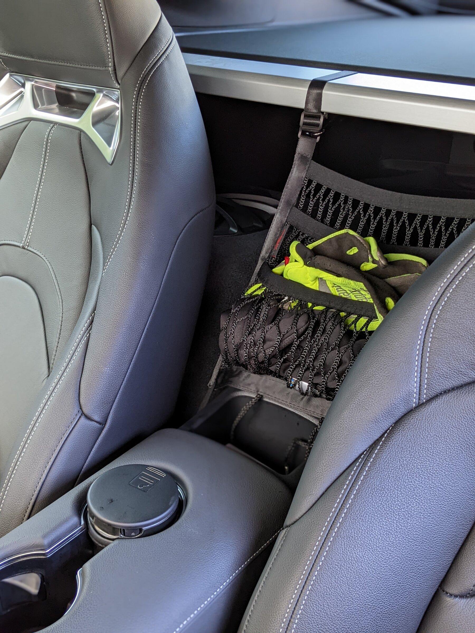

Also did this. Didn’t get any pics, but these do a good job.
Super cheap on Amazon and appears to be pretty well attached. They can hook onto the seat rails. There are no holes to hook onto, but the seat rails have enough edges and the cargo net has enough tension that it’s not going anywhere.
Good suggestion.

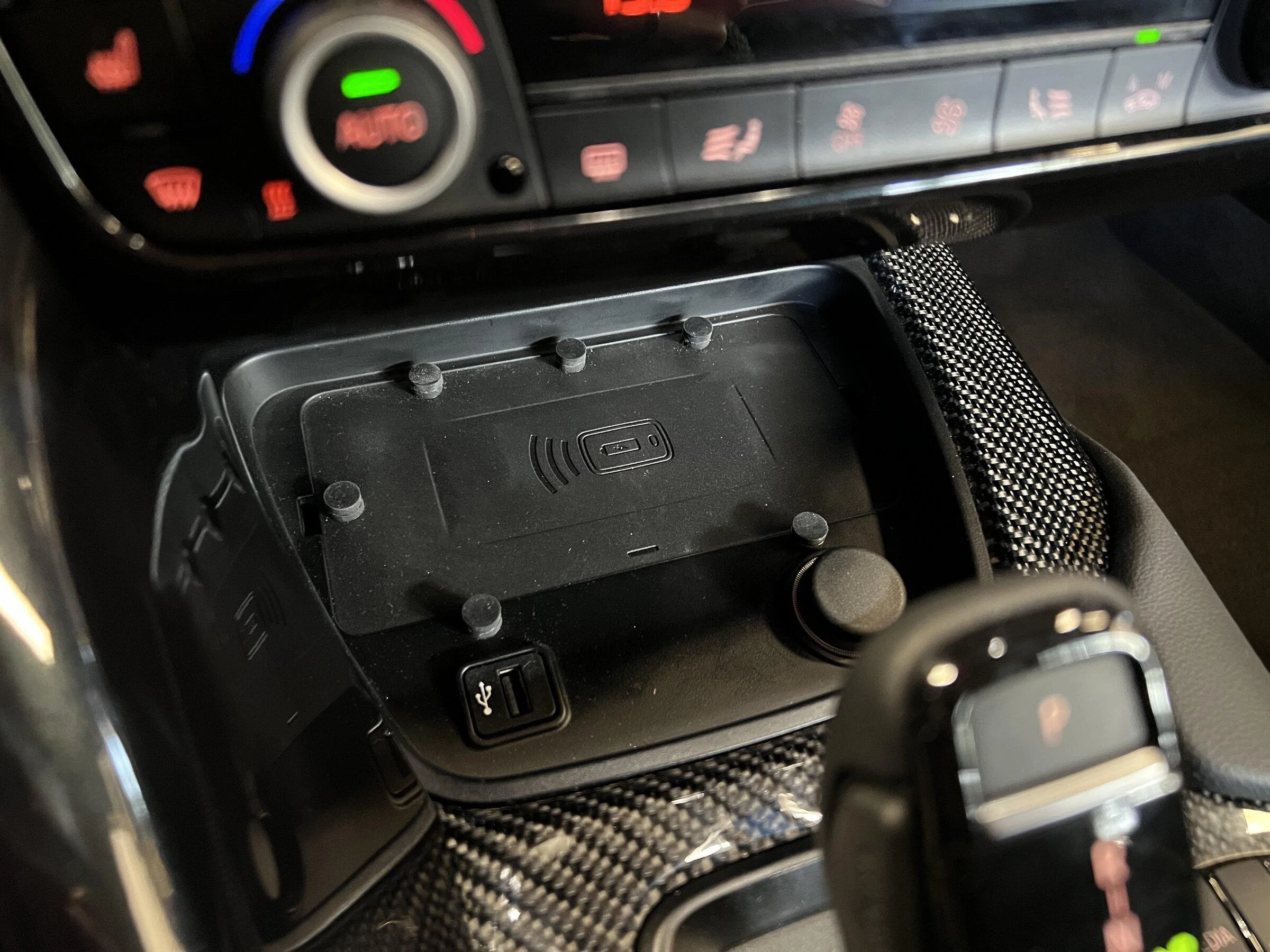

Probably the biggest mod of all in the thread.
Used these to keep my phone in place :cool:
Those little rubber stops are a great idea...was trying to figure out how to keep the phone from sliding around without that annoying cover
