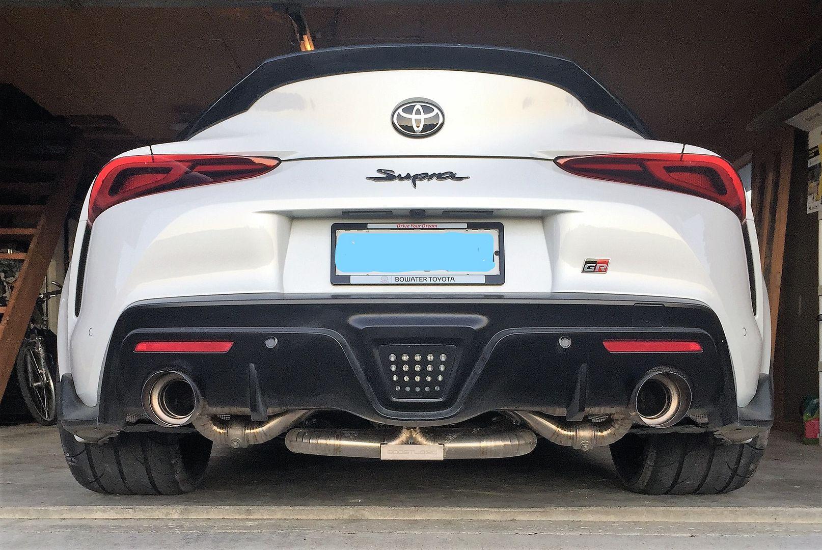

Micky Thompson 305's on factory wheels for later on in the year when I put her down the strip to see what she will do :)
Some shiny Versus bits along with diff cooler plate & turbo heat shield to be put on with my AFE intake when my Mishimoto catch can shows up
Getting used to the Boost Logic exhaust :)
Your car is eerily similar to Adam LZ's. Boostlogic exhaust system? Micky Thompson 305's in the rear? What's next a Pure 800 turbocharger? ;D
:D Had considered a Pure 800 but too much $$ & hassle to get it sorted over here, wasn't sure which tires Adam had
Also with my current relationship with the Dealership I can possibly swing a warranty claim if needed but with a bigger turbo I think I would be pushing it ;)

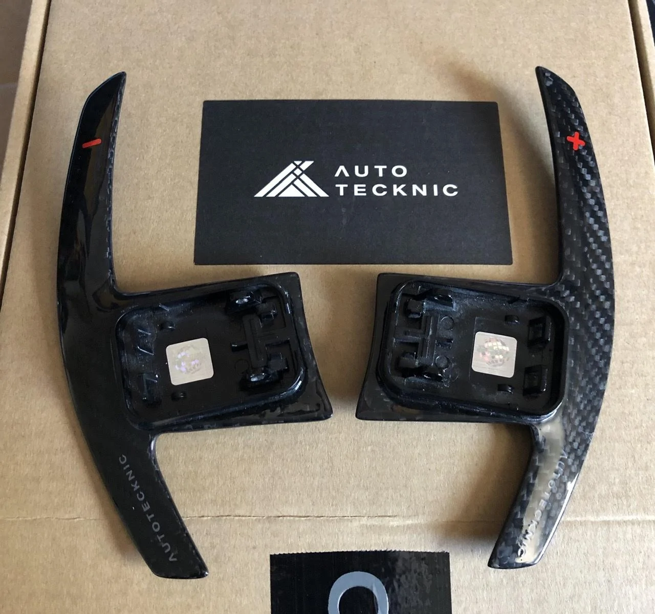

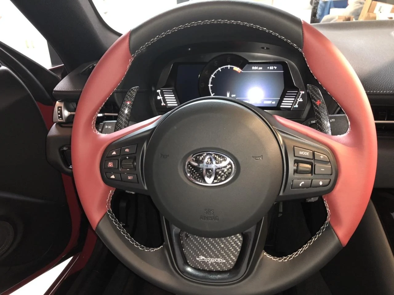

Hi guys. I swapped out my regular steering wheel for the red and black Launch Edition steering wheel and I added AutoTecknic carbon fiber shift paddles.
Changing the MST to AFE?

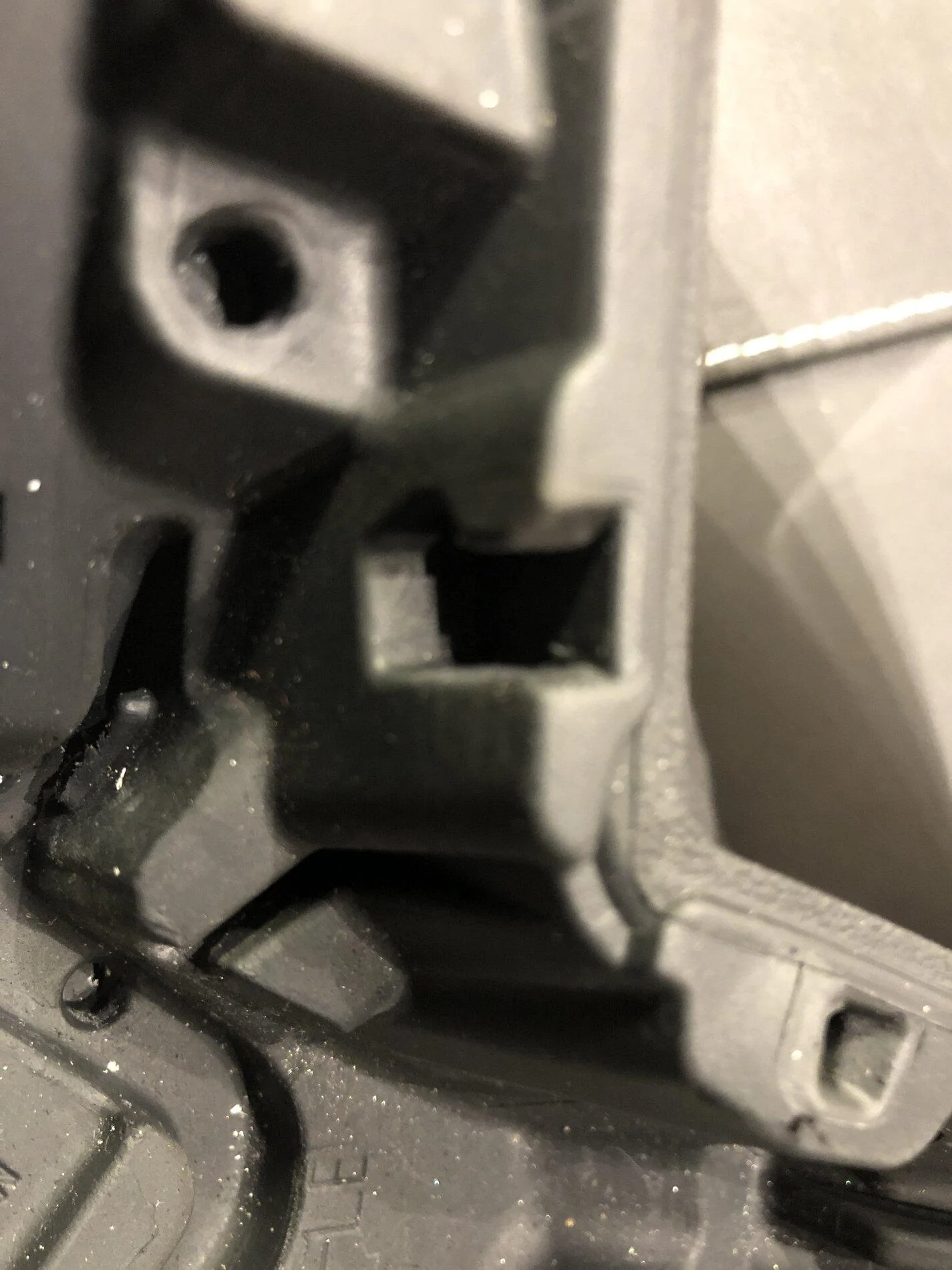

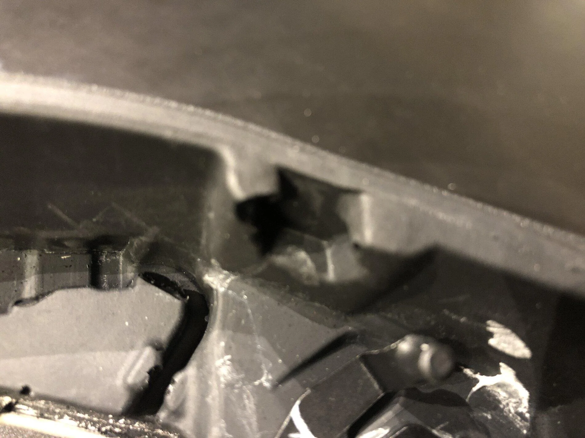

How was changing out the wheel?
JRedMKV
Jul 1, 2020
43
684
672
Reno, Nevada
2020 Supra 3.0 Premium

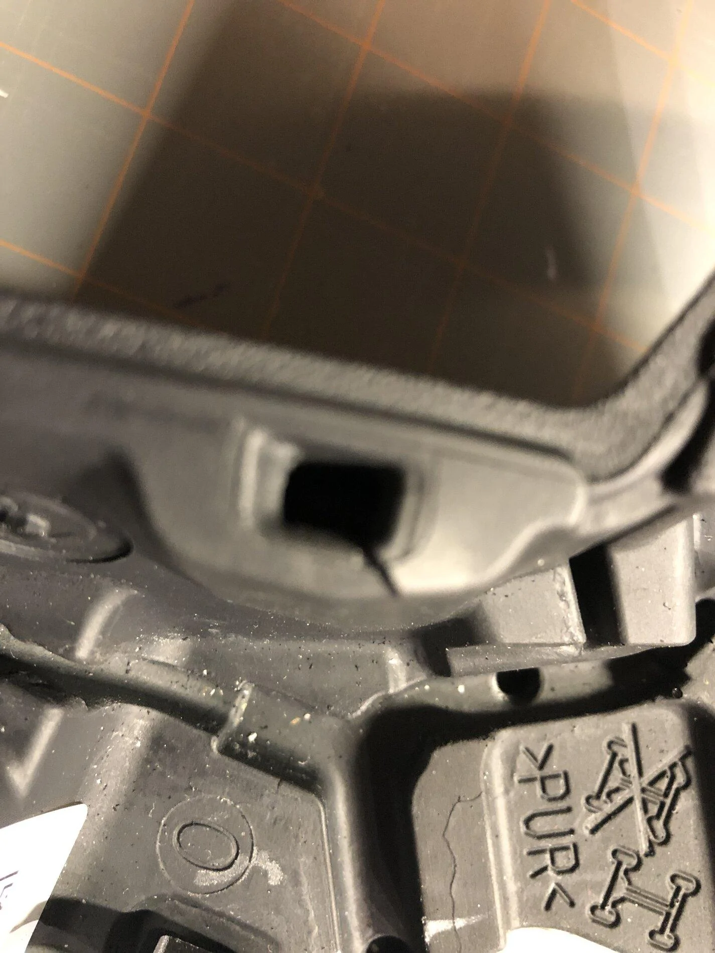

It’s a fairly straightforward job but it takes a lot of time and patience. I watched the Speed Industry video as reference to remove the steering wheel. After getting the wheel off then I needed to figure out how to remove the plastic piece that holds the electronics and that big plastic piece at the bottom of the wheel.
The FIRST thing that you need to do after removing the steering wheel is to remove both of the shift paddles by removing the torx screws. This will expose two more torx screws from the back of the steering wheel. Remove these two screws then you can carefully pull off the main plastic piece with all the switches. Also make sure to remove the connector for the electronics that’s on the right side. It’s difficult to pull off these pieces because they are held by 4 plastic tabs that go in these depressions in the pics I attached but just be careful and they will come out. Same thing with the lower plastic trim piece, just carefully pry off the whole thing. It’s held by 4 tabs. Once you get those off you’re pretty much home free. There’s two other electronic modules mounted inside the steering wheel housing that you need to remove but those are easy to pull out then you can easily remove all the wiring in one piece and transfer it to the new wheel.
I probably should have taken pics of the whole process but I really wasn’t thinking about making a guide. Hopefully these tips help you guys out.
