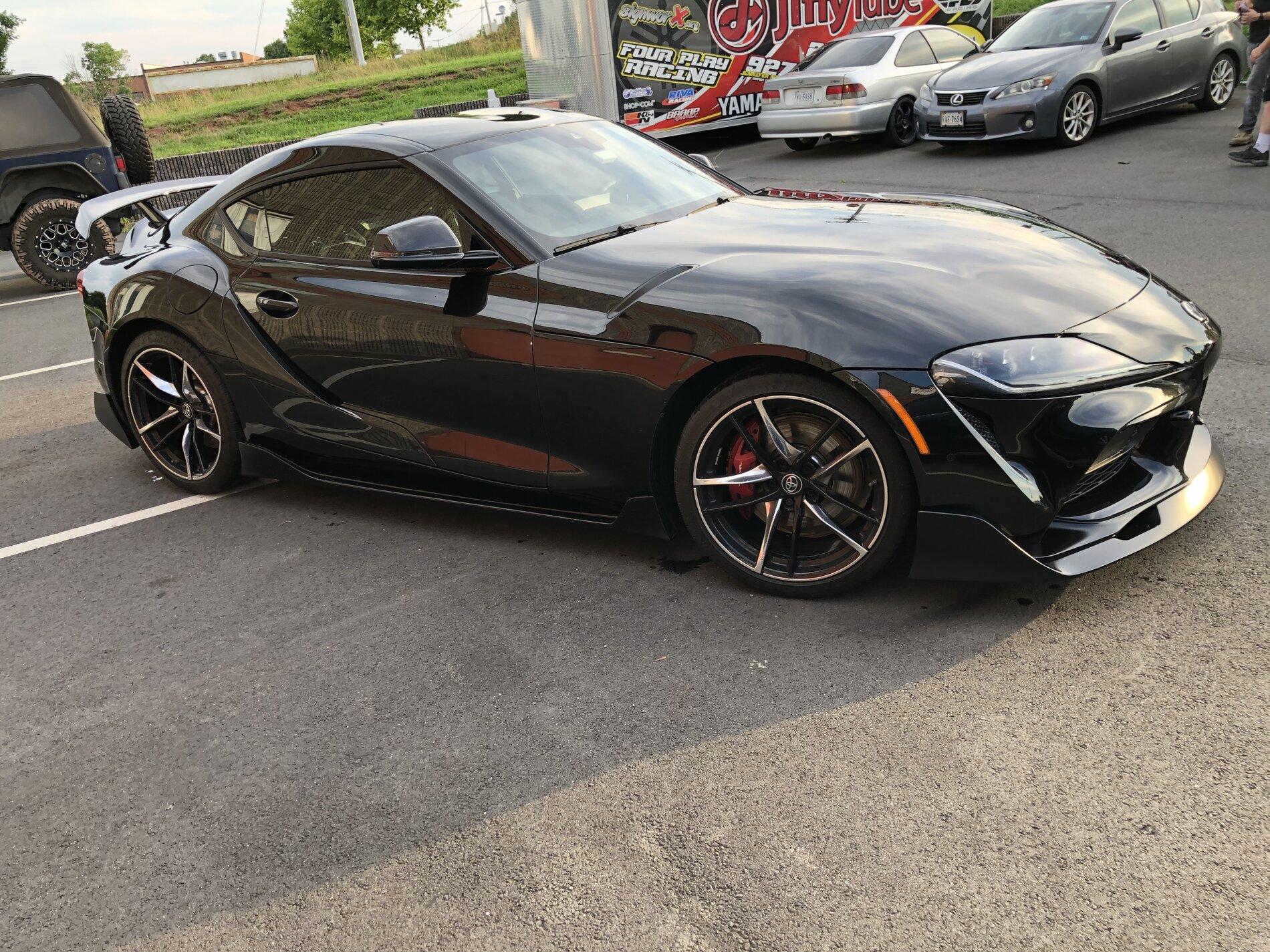

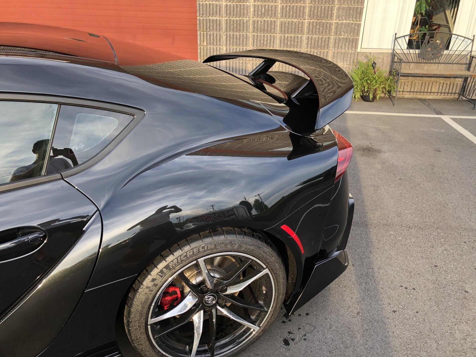

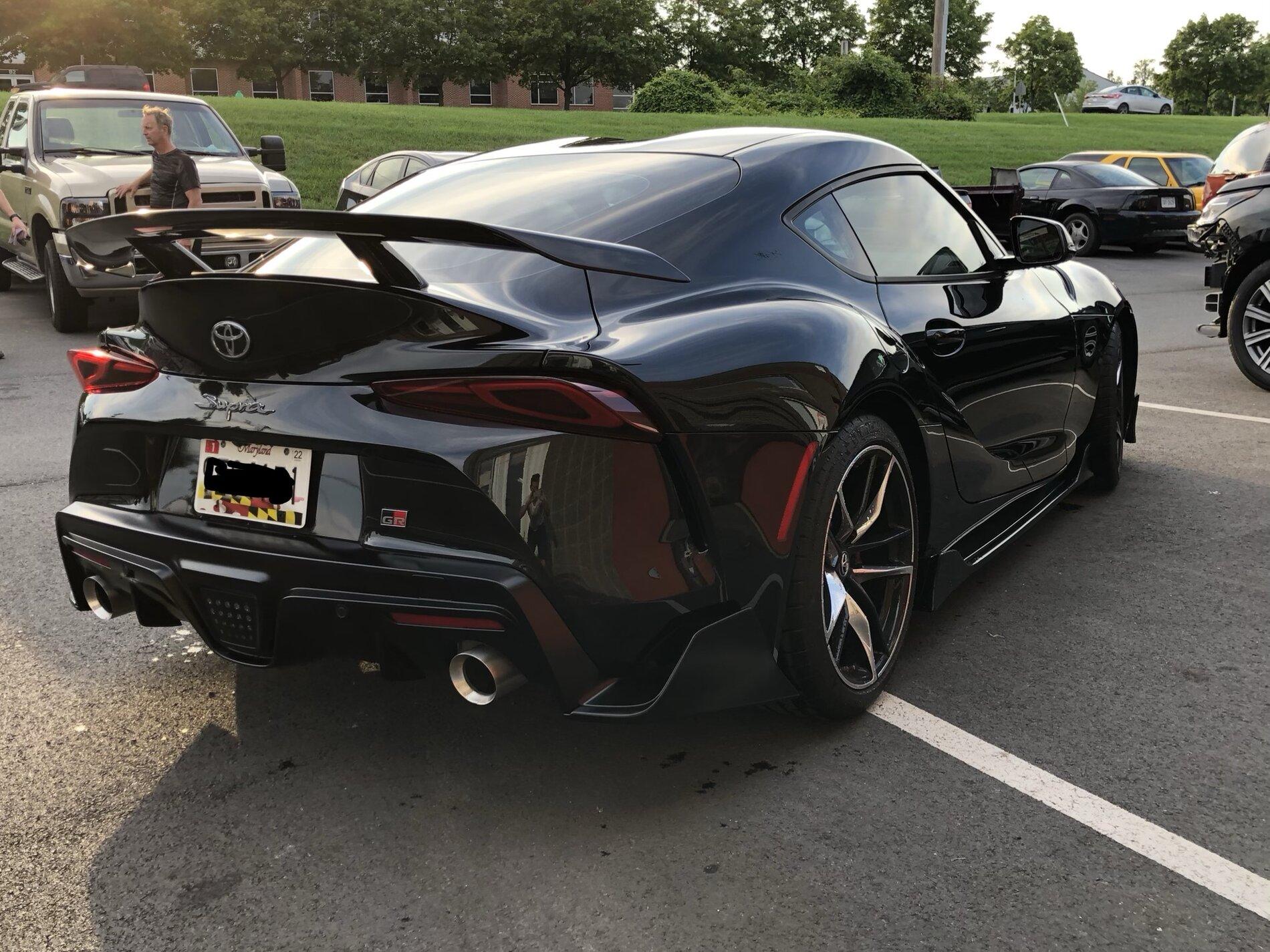

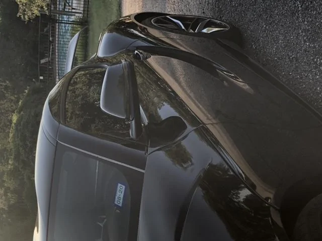

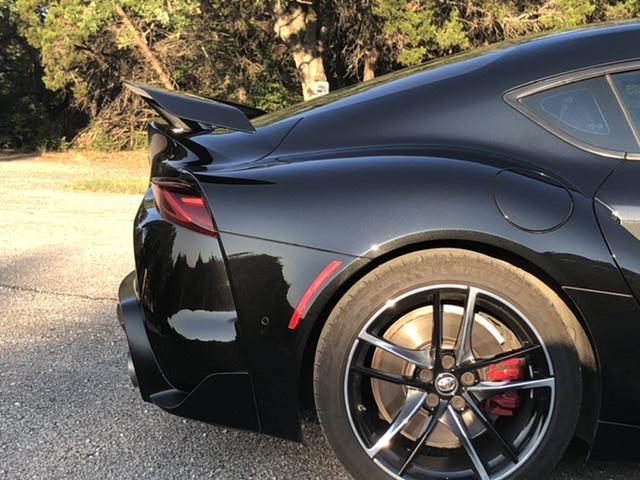

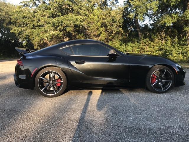

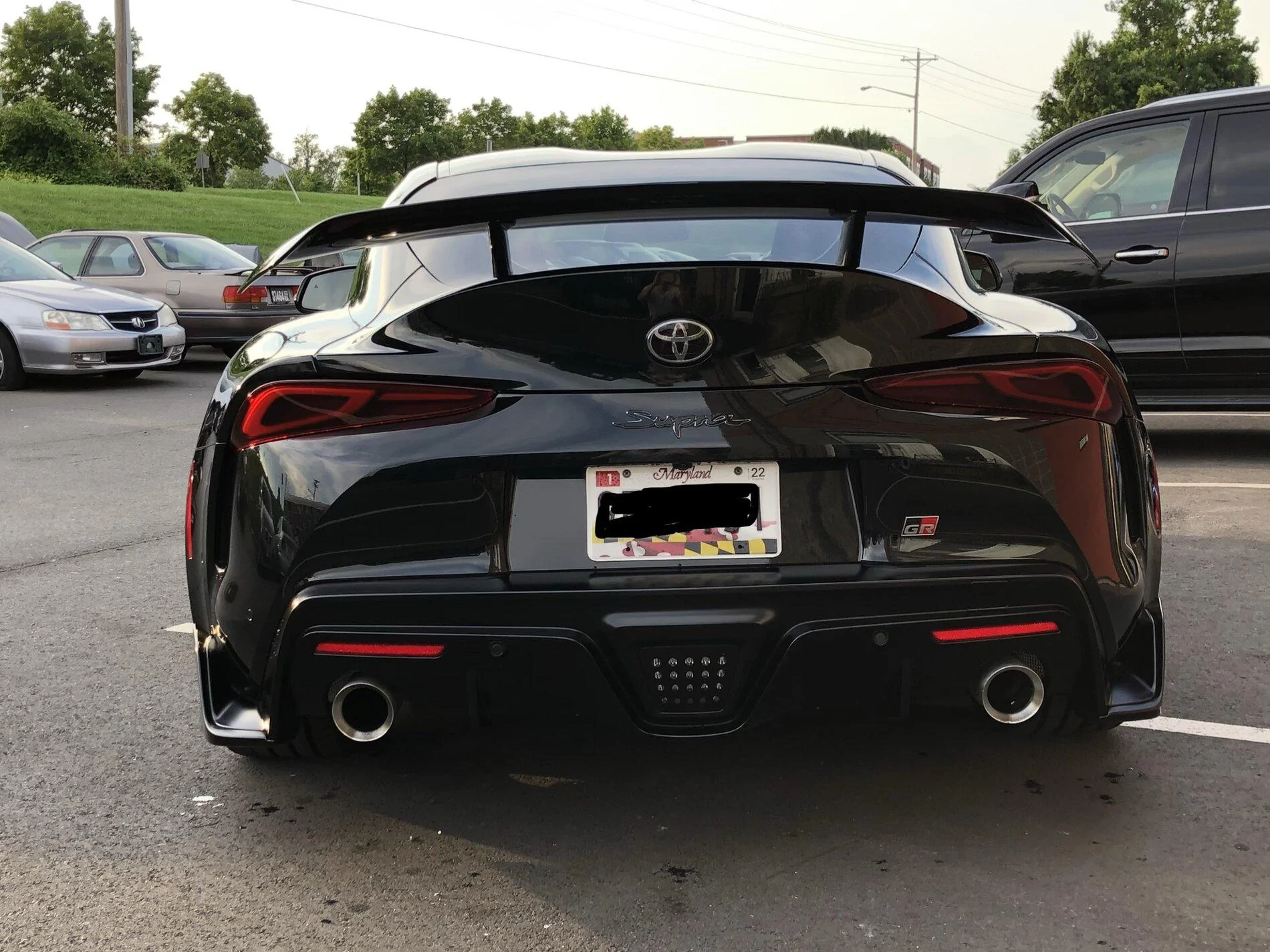

Had the AIMGAIN wing put on:
looks great I’m still waiting for mine to show up. Should be here this month!! How difficult was the install? We’re you able to get the interior trim off on the underside of the hatch to hide the hardware? Or did you end up going through the trim pieces.
AustinGRSupra
Aug 17, 2019
740
1,054
Austin, TX
2020 GR Supra
very easy; the template is great. Did not go through the trim. I recommend using bigger washers than those supplied. And drill the holes to 5.5 mm not 7mm as it says.

Any tips on how to get the trim off?

Wow! That Aimgain wing looks great!. Not too big and follows the lines of the vehicle nicely! Spectacular!

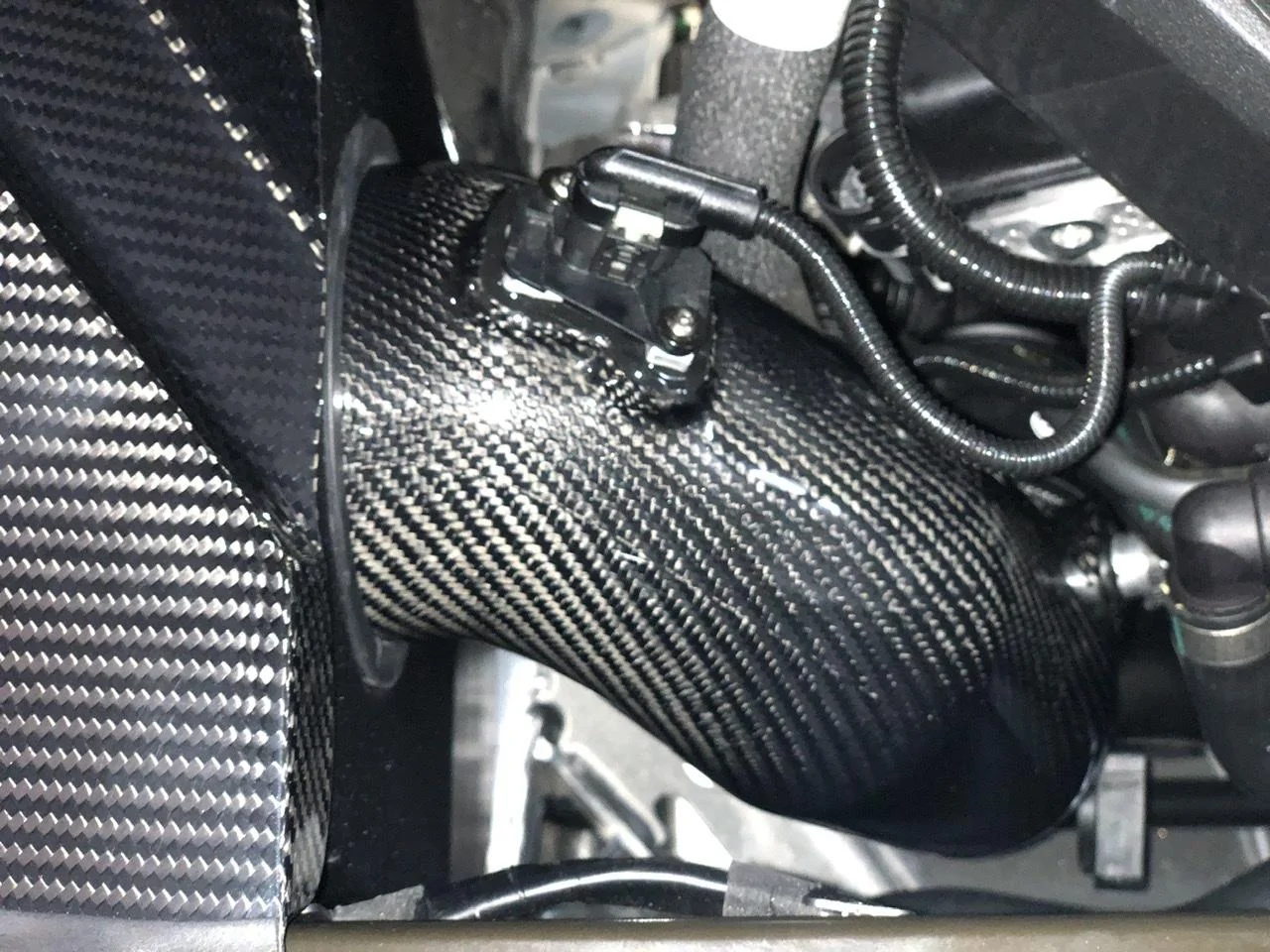

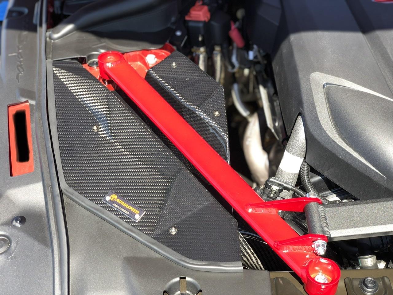

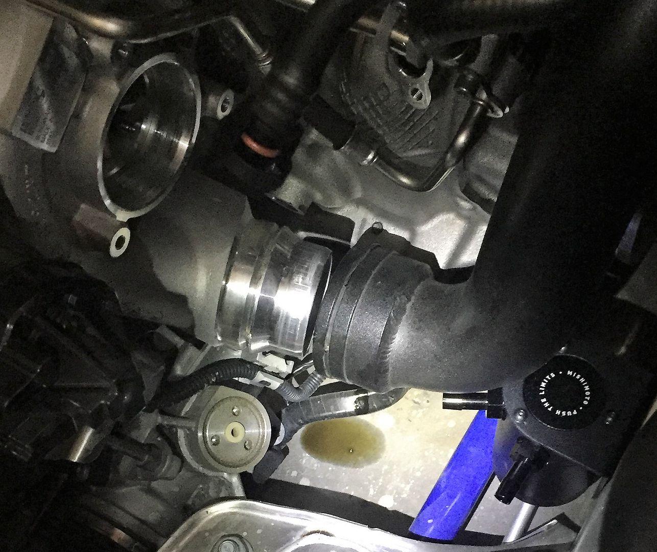

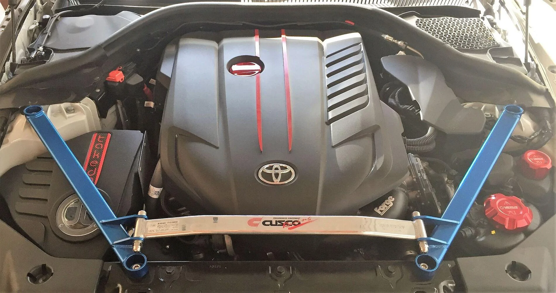

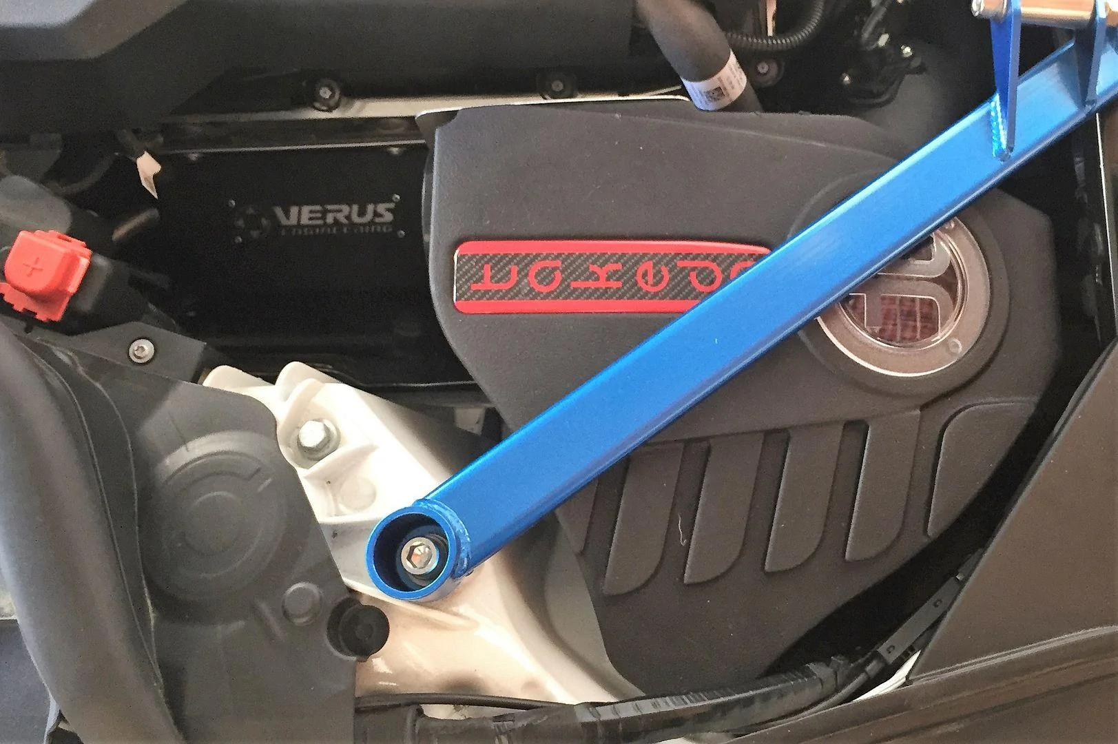

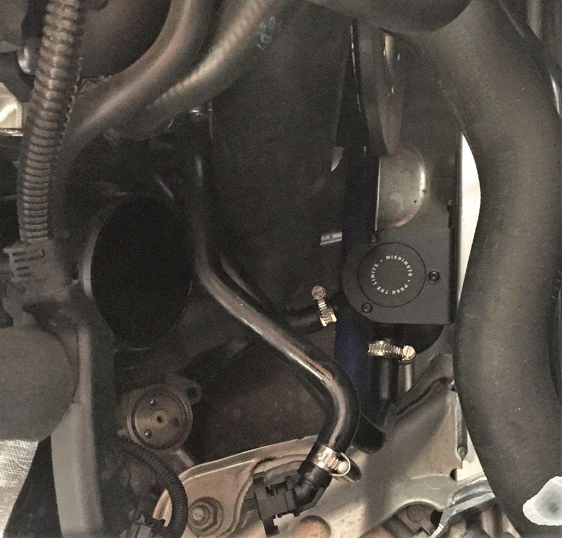

Installed my Versus heat shield, AFE intake & Mishimoto catch can
They didn't all hold hands or play nicely together, but in true Kiwi fashion I got it sorted :)

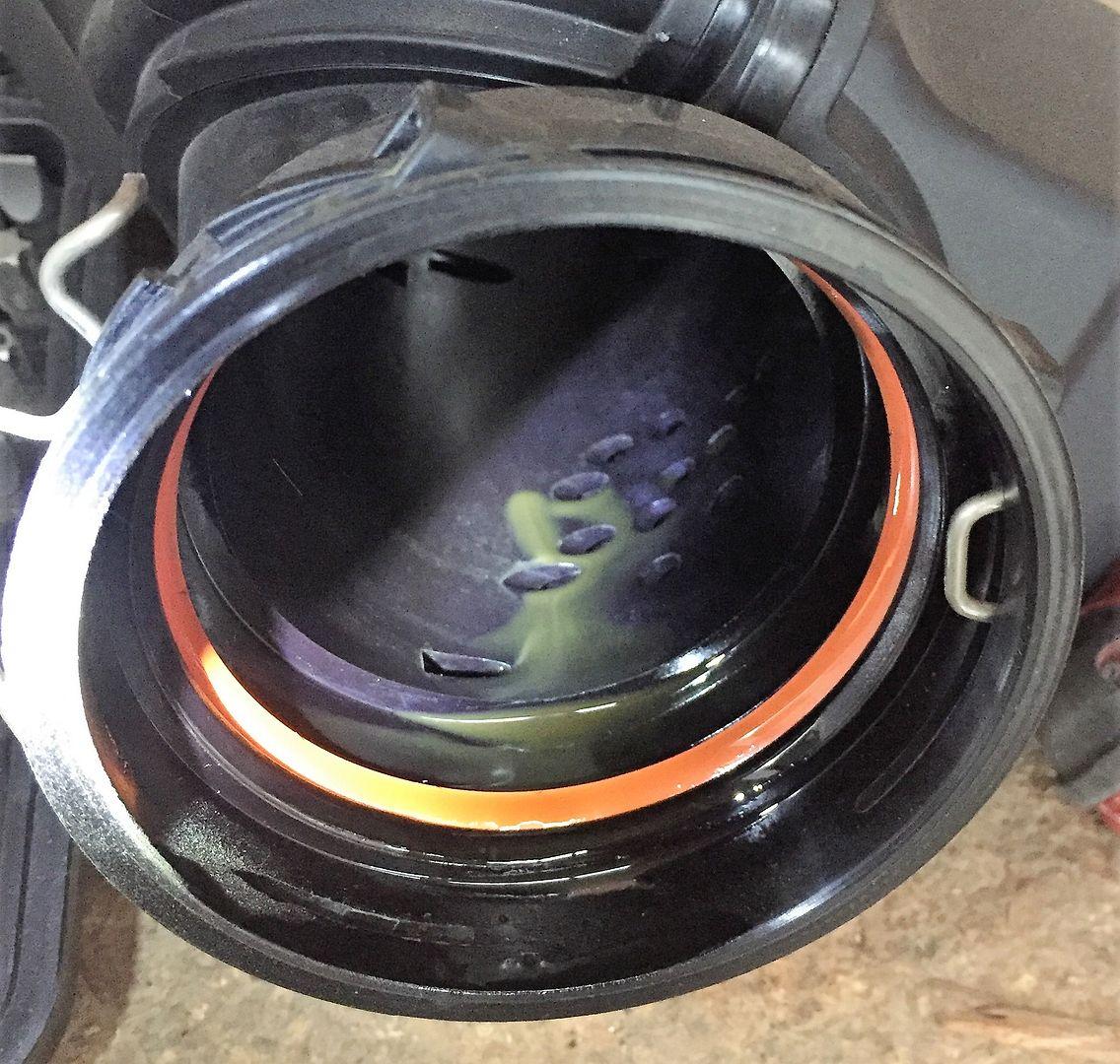

The amount of oil in both the turbo inlet
& exit into charge pipe was surprising
Was a bit in the pipe that the catch can uses as well when I took it off
Seems to have a little more turbo noise than the MST intake

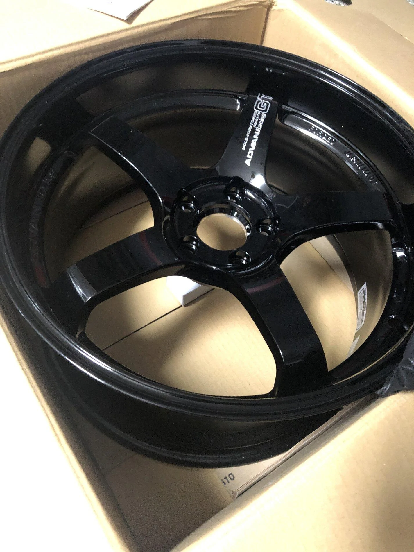

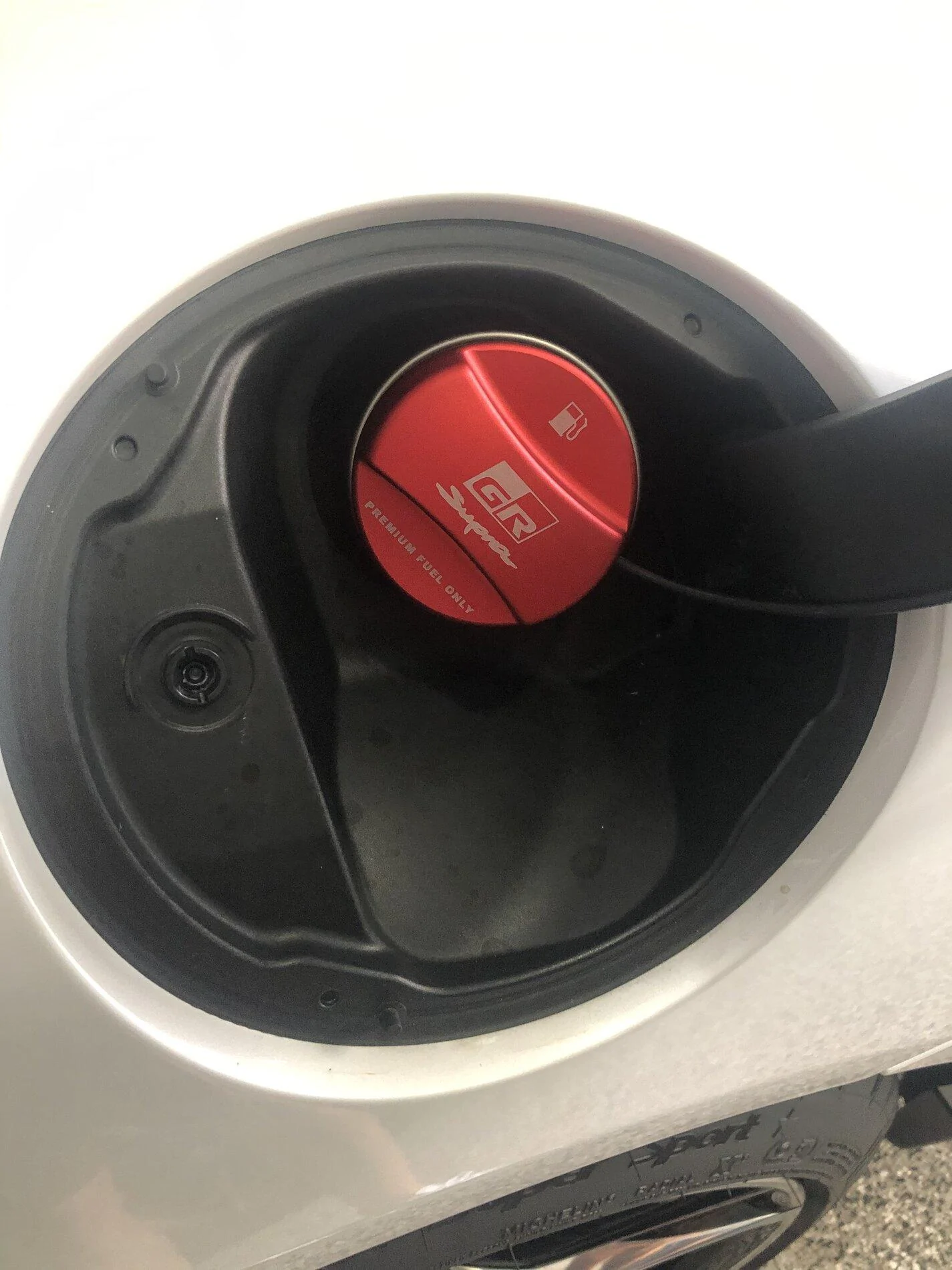

Just dropped off my advans to get ceramic coated and tires mounted and balanced. Was a nightmare to get the rear tires as they’re on National backorder so I had to source the rears one by one. Went with 265/35/19 and 295/35/19. Also got this fuel cap anodized aluminum fuel cap cover while I’m waiting for more parts. Parts for the Supra might be just as hard to get as they were for my lotus exige s240. Still waiting for my Aimgain wing. Maxton v.1 side skirts and rear splitters. Blitz front strut bar. Hks intake. Advan full flat center caps. Once all the exterior. pieces go on I’ll get the hks springs and rsr cage installed. and then we wait for some break in miles then stage 2 or just go straight to the pure turbo upgrade. Hopefully I can get everything done before my diesel wrangler shows up then starts another build.

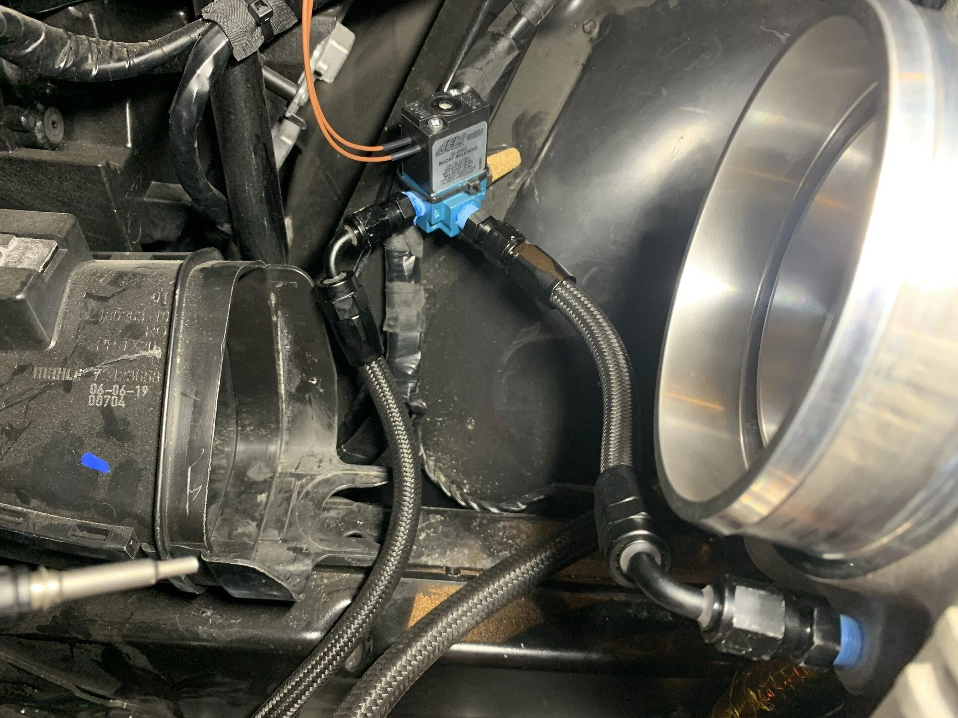

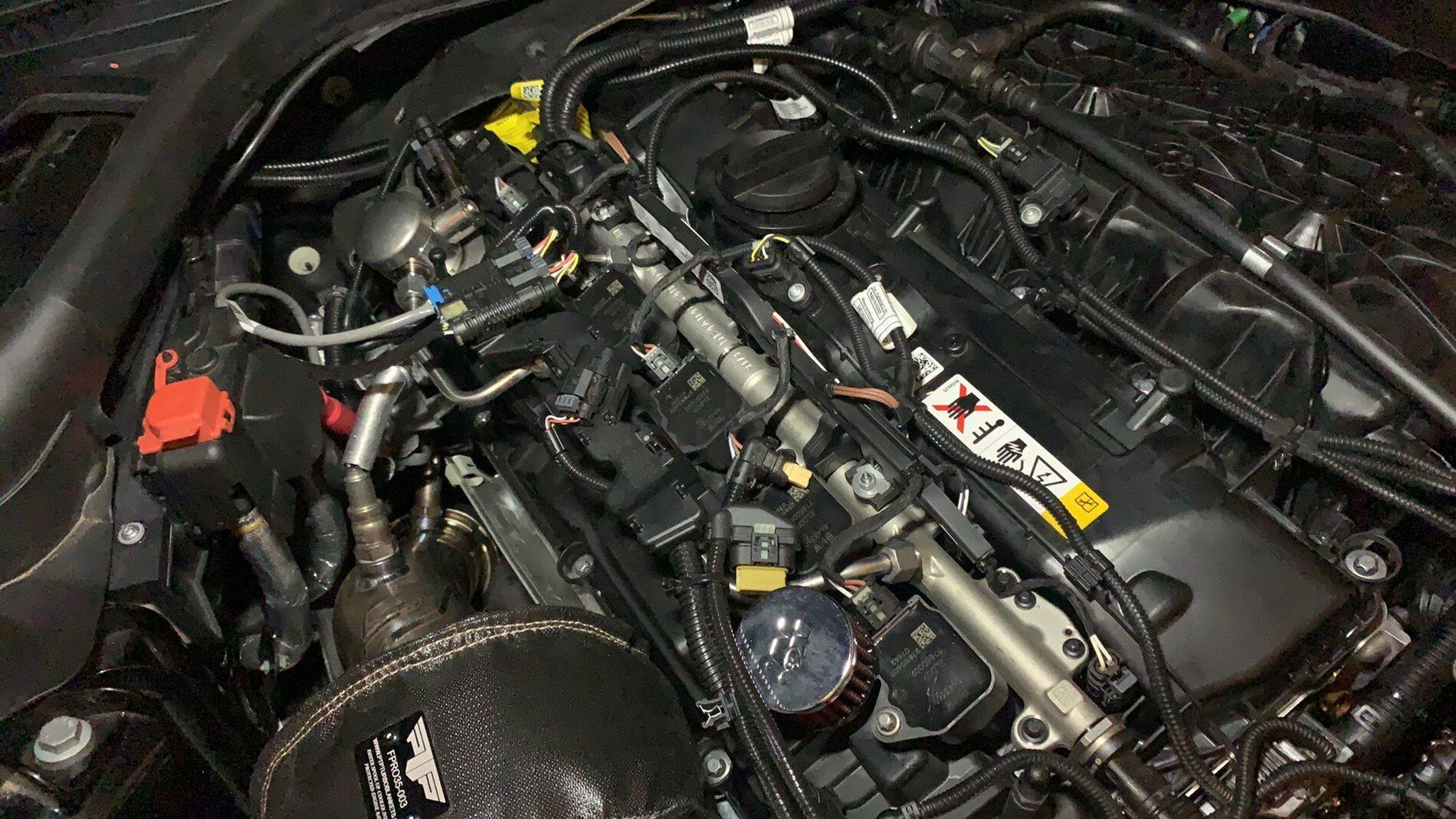

Added evolution of speed port injection - 1000cc injectors.
not like you can see it in the pictures.
also added Ortiz custom gauge pod, along with an AEM truboost boost controller.

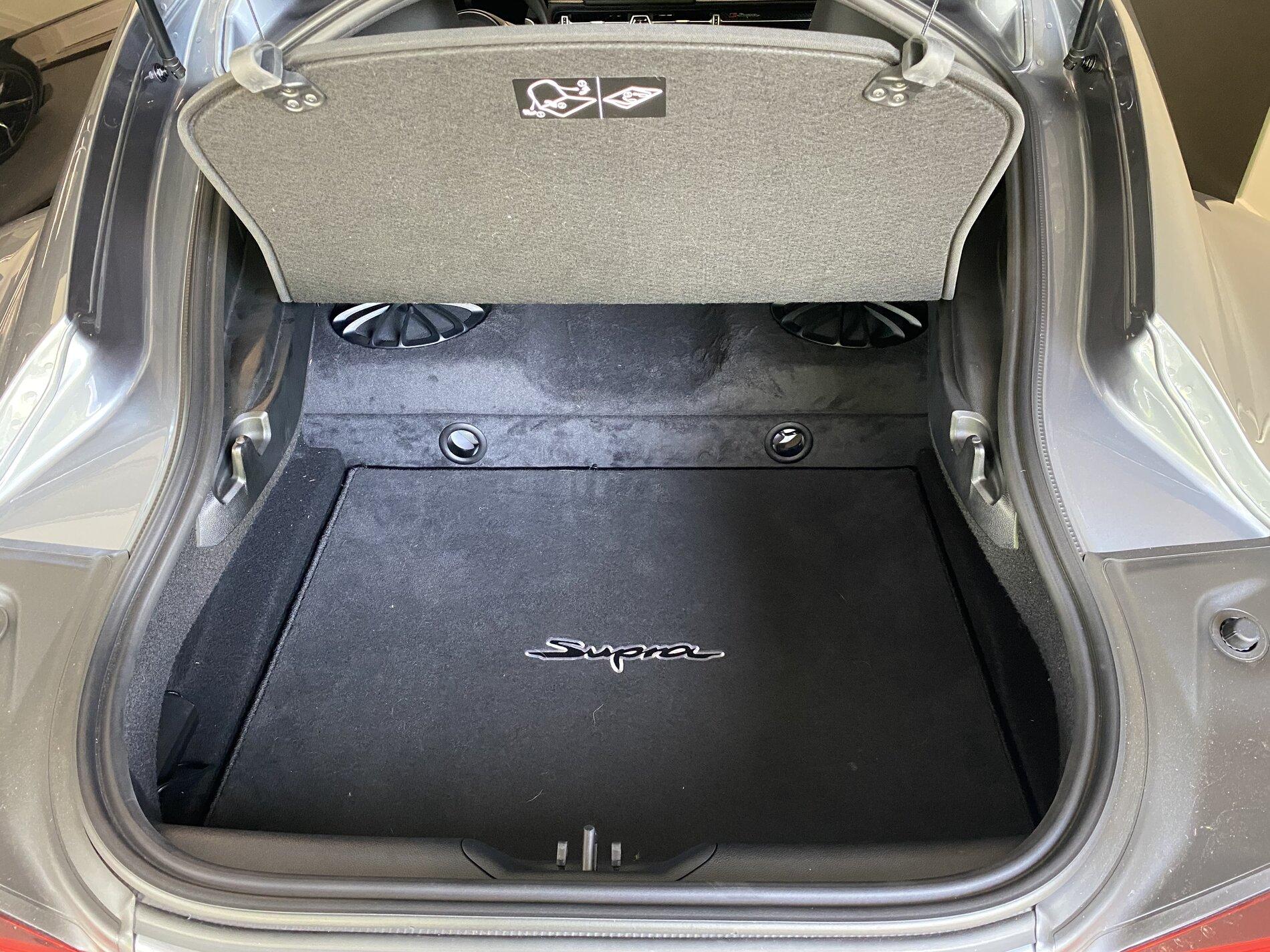

I completed the subwoofer port modification today. Thanks Tadda for the excellent write up on here! I am stunned how well the audio system sounds now.
