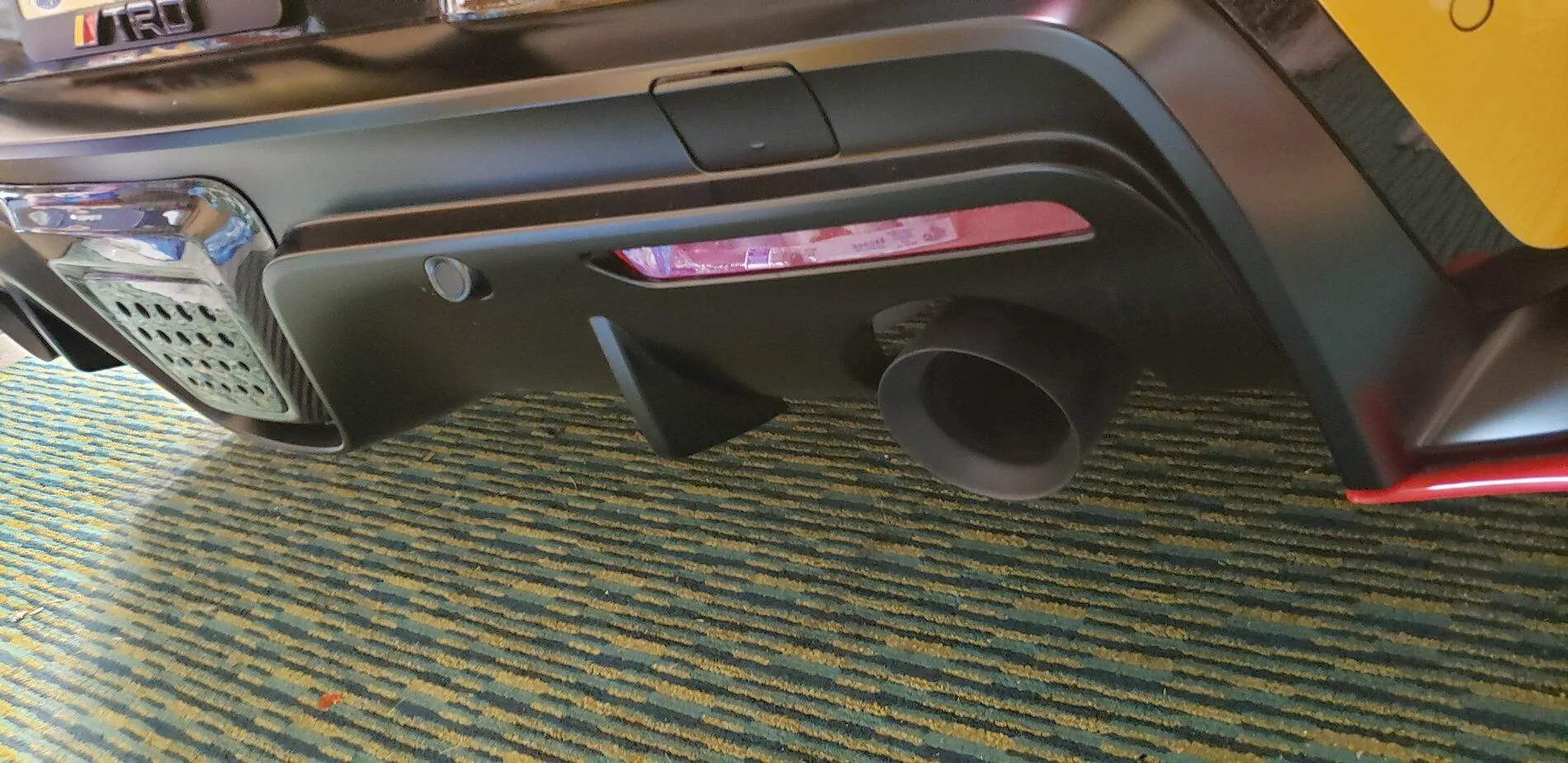

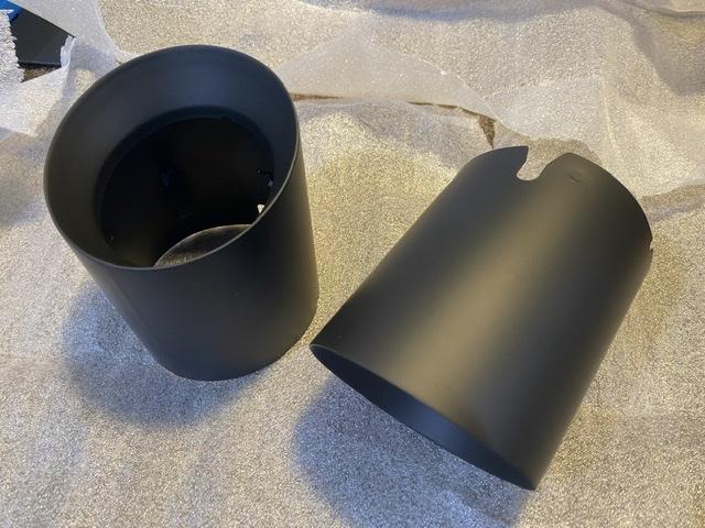

Ceramic painted my exhaust tips black. Was looking into powder coating them, but not sure how hot the tips got, so I went ceramic with a 2000 degree threshold. That should be enough. Lol. Ended up costing about $60 to coat them which was much more affordable to me than buying already blacked out tips.
Too bad my car is still away getting the ppf, powder coated rims and ceramic coating treatment. This post is “just the tip(s)”
Does anyone make any nice titanium tips we could replace these with?

^^^Didn't realize you could remove them.
You can wack them off with a rubber mallet
Also if you can find an exhaust tip w/ 3" intlet and 4" -4.5" out and up it "should" fit the car.

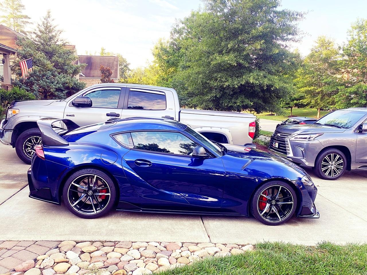

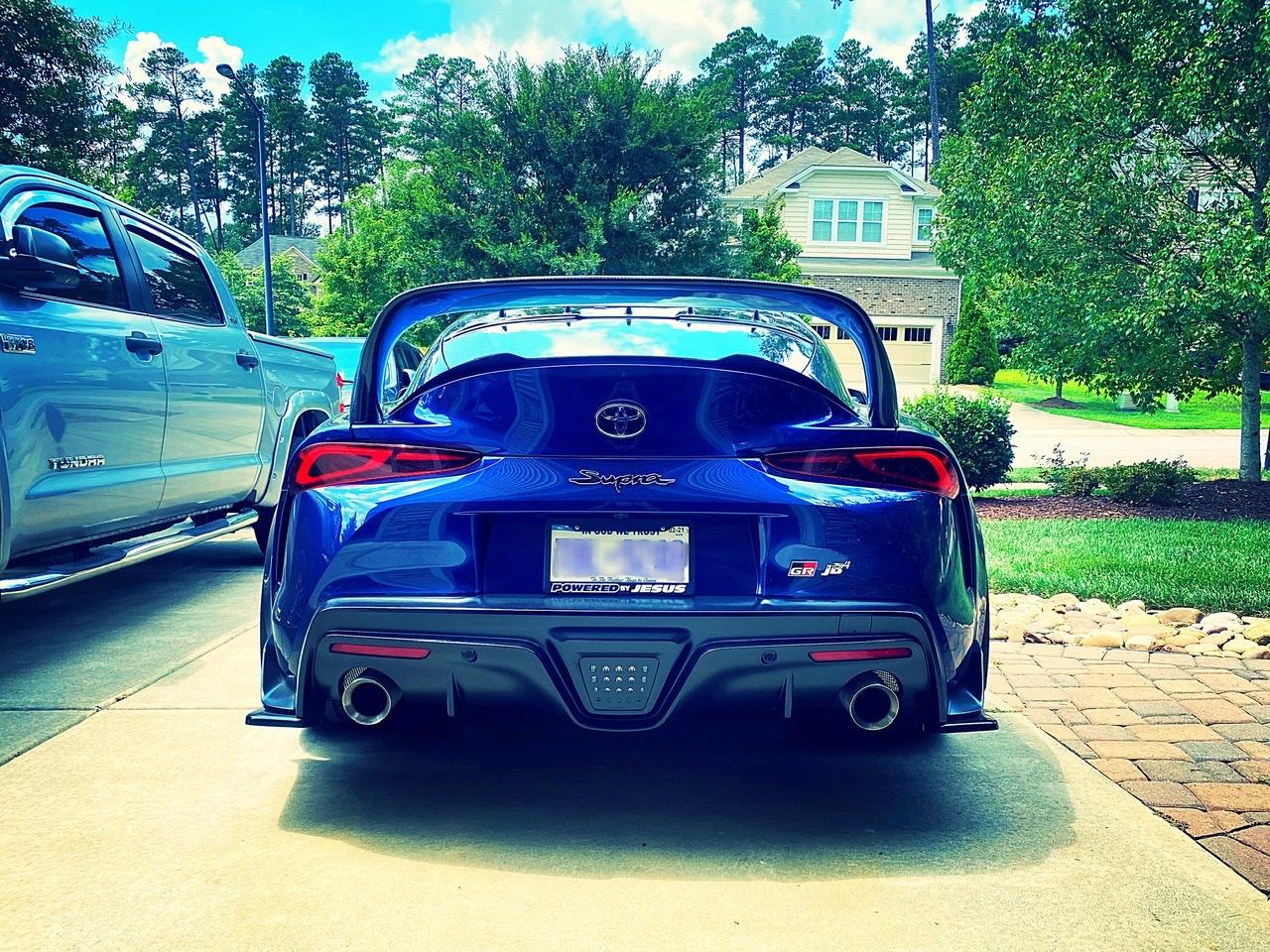

Installed my Seibon spoiler the other day... I‘m also running the Maxton spoiler too... Waiting for my carbon fiber mirror caps to come in... Rims are next on the agenda... Either powder coat the oem wheels or go aftermarket...
Also if you can find an exhaust tip w/ 2.5" intlet and 4" out and up it "should" fit the car.
How sure are you about those inlet measurements? I haven’t removed mine to measure but I found these on eBay and I think they look pretty cool. The measurements are 60mm on the inside diameter of the inlet, 63mm on the outer diameter of the inlet and 101mm for the outlet.
https://www.ebay.com/itm/173895647464

If you installed as-is, the tips would stick out pretty far past the diffuser. The stock exhaust tips are more of a sleeve over the exhaust pipe rather than an extension.
Even if that sizing was correct (I don't have my car here to measure), you might have to cut back the existing piping an inch or 2 to make it look right.
You can check really fast though...the tips are easy to pop on and off with a mallet. They are tension spring mounted
I was going to get this..but then i just plastidip the tip with 6 dollars can
I've done the same thing. ;) but my plastidip costed me $10! :eek:
It works perfectly on normal/street use but after track days, it burns off. I just need to re-dip it. ;)

Nice....cheap and effective for the short term. I didn't want the hassle of redoing them over and over so I sent them to get ceramic coated (the paint they use for headers and exhaust systems) for $60 and called it a day.

.... I didn't want the hassle of redoing them over and over so I sent them to get ceramic coated (the paint they use for headers and exhaust systems) for $60 and called it a day.
^This is the way to do this right....
I cringed when I read those guys are applying plasti-dip to an exhaust tip :eek:...And surprised to hear it even held up during normal travel use...but for how long? I wouldn't want the hassle of having to redo it multiple times..
Personally, I wouldn't cheap out and also get the tips ceramic coated in black....
