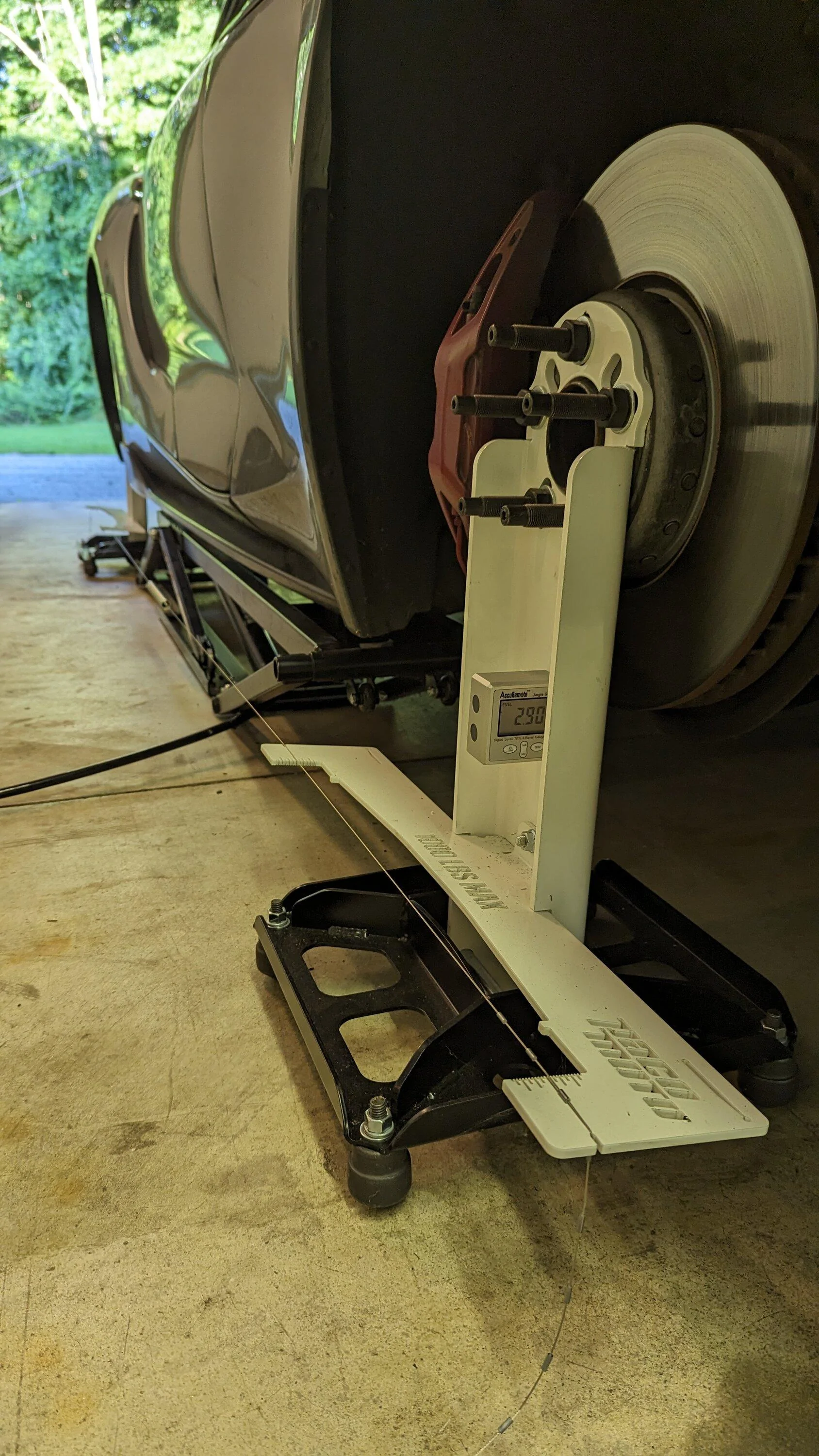

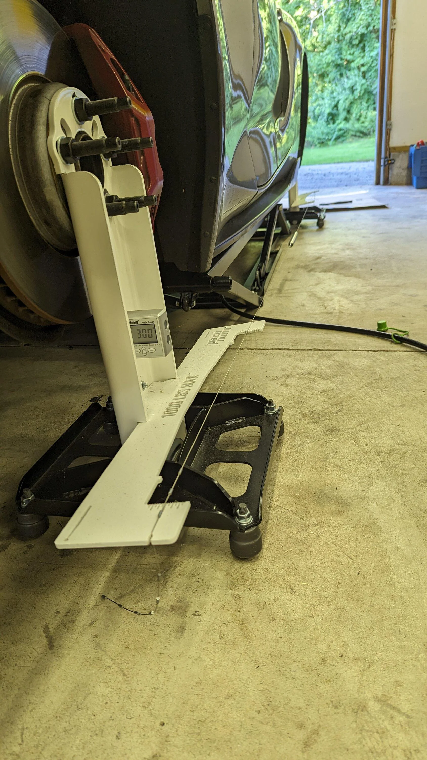

Checked and corrected my alignment with my hubstands preparing for Watkins Glen next week. Ended up with 1/32" (1mm) toe-in each rear wheel, zero toe up front, and -3.2 degrees of negative camber.

How level does the floor have to be for those hub stands? I like the idea of them but my garage floor has a slight slope to it
decodeddiesel
Wes
Feb 28, 2021
798
1,085
Southern New England
Honestly it has to be pretty flat and level to work right. The instructions don't really give a tolerance.
You could reach out to Paco Motorsports. They're really friendly and I'm sure they'd have a better answer.
The main thing they talk about in the instructions is the car rolling away lol.
Yeah that’s what I’m worried about, if I leave my creeper unattended and don’t put a wrench or something behind one of the wheels it’ll definitely roll itself out into the street
I chuckled at the thought of my dumb ass chasing my car on hubstands rolling into the street...but clearly that would really suck lmfao
Lol, I could definitely see myself trying to jump in and hit the breaks to try to stop it too. I’ll reach out to Paco and see what they say, thanks
