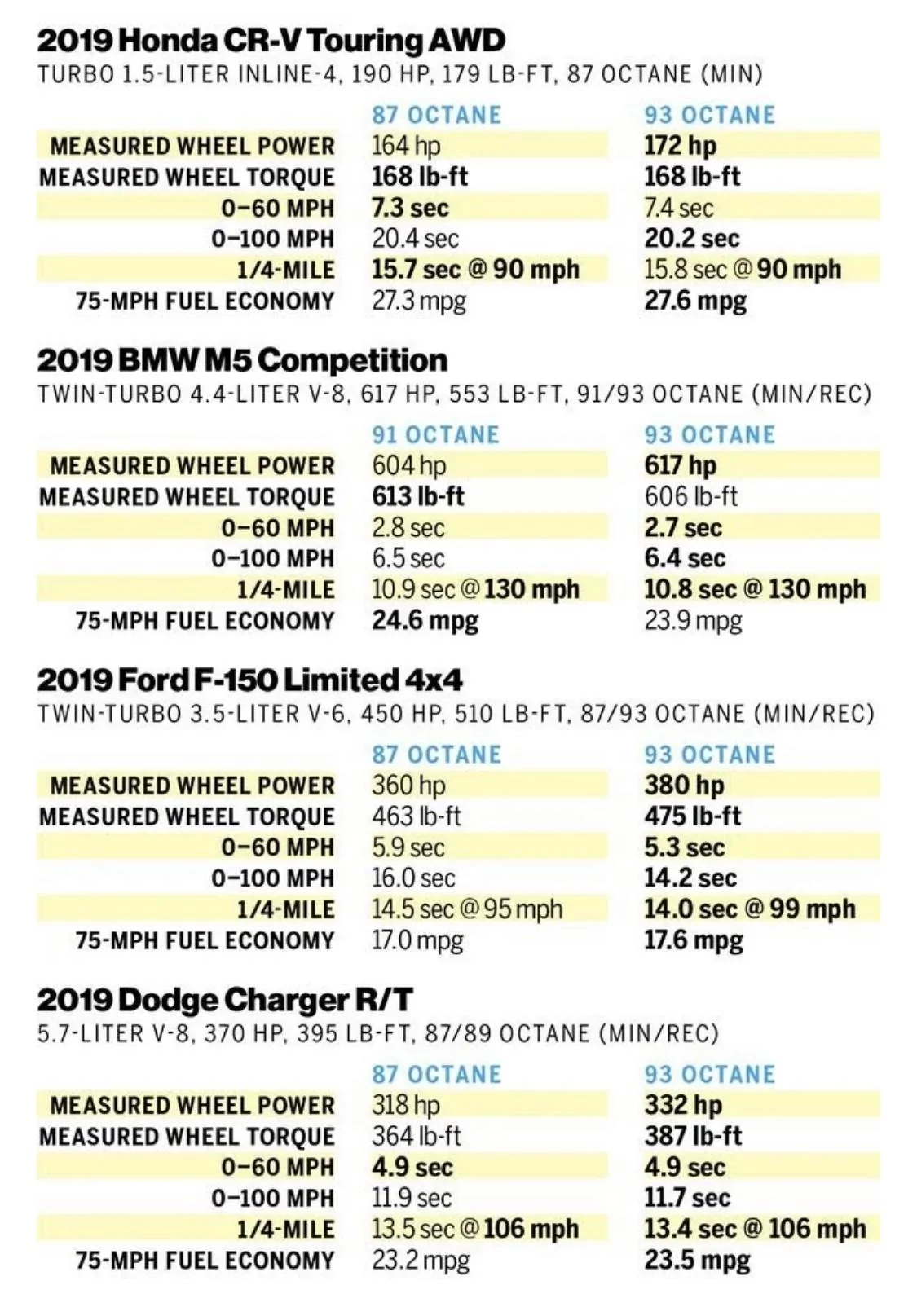

Snorlax27
JR
Sep 7, 2020
183
178
2020 GR Supra, 1995 E36 M3
Here was a little snippet from a car and driver’s article that tested various octane gas in multiple vehicles.
Not entirely shocking. Settling for lower octane fuel for a vehicle calling for higher octane leaves performance on the table. This is not a moot point. Likewise, putting higher octane in a vehicle that doesn’t call for it is essentially “burning money”- hehe.
There are other considerations to take into account like fuel economy or gas savings buying lower grade fuel. All things considered, it’s your vehicle and it’s your decision what fuel you dump in it. You can find the entire article here:
