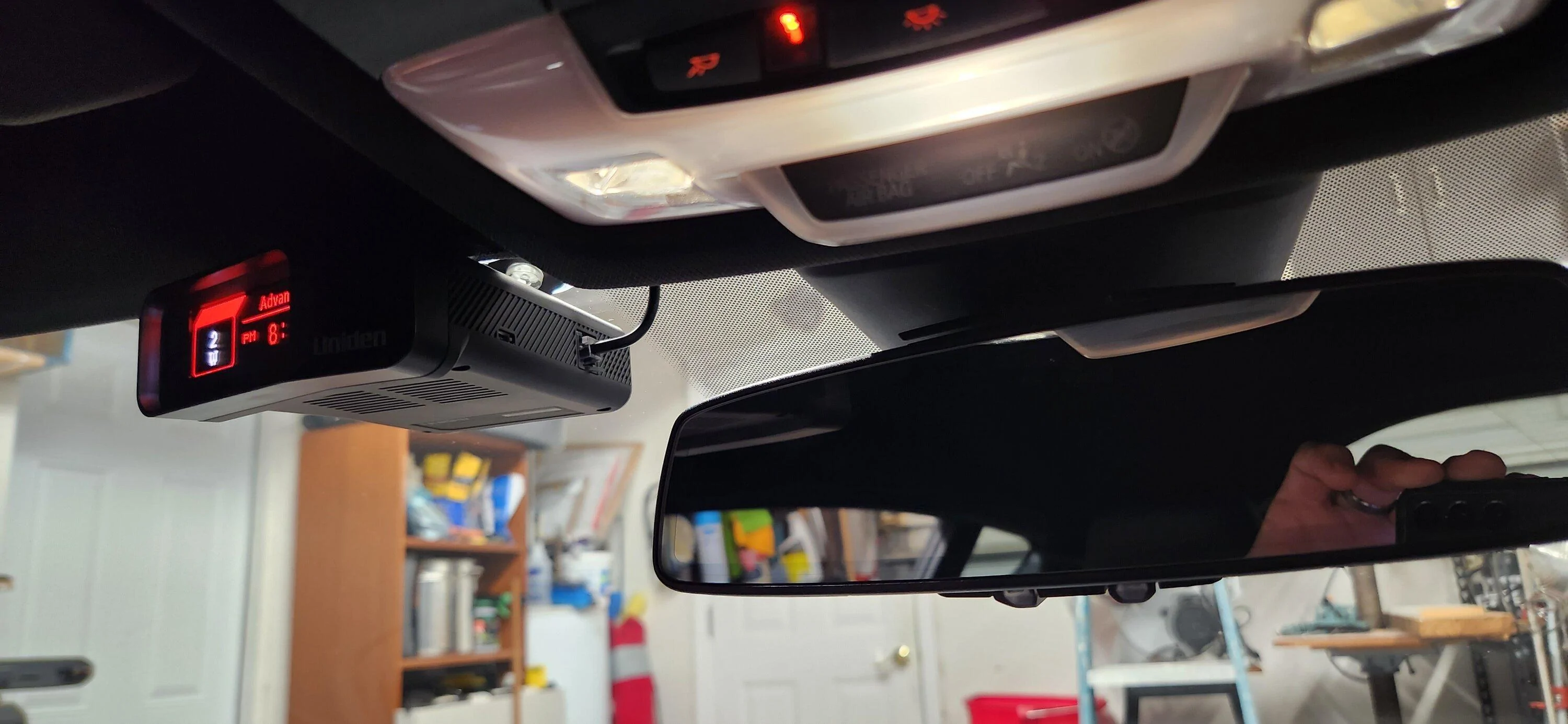

This obviously doesn't answer your question I'm just curious why to go this route I have blendmount + uniden r8 which doesn't bother me in terms of vision at all and I know the valentine is a bit sleeker/smaller.

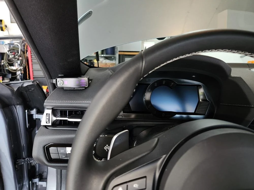

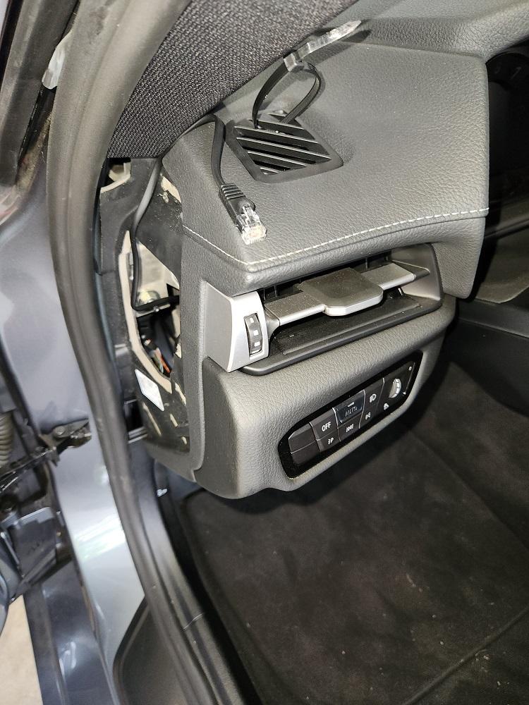

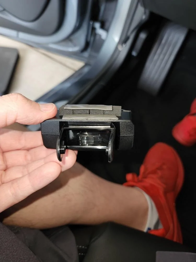

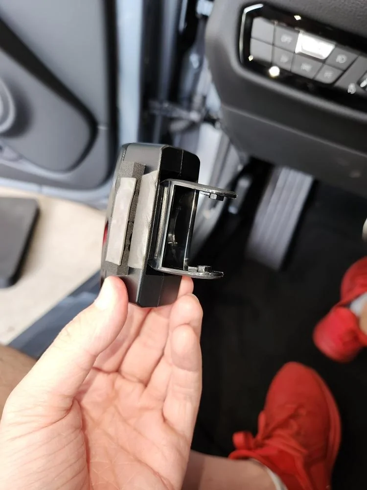

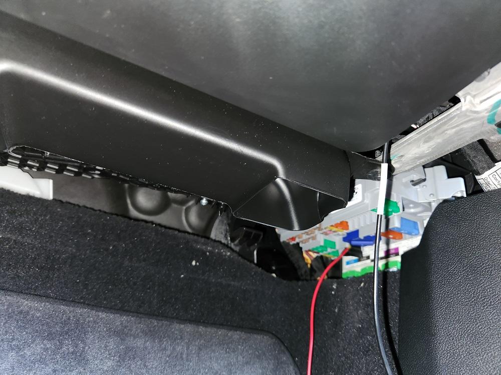

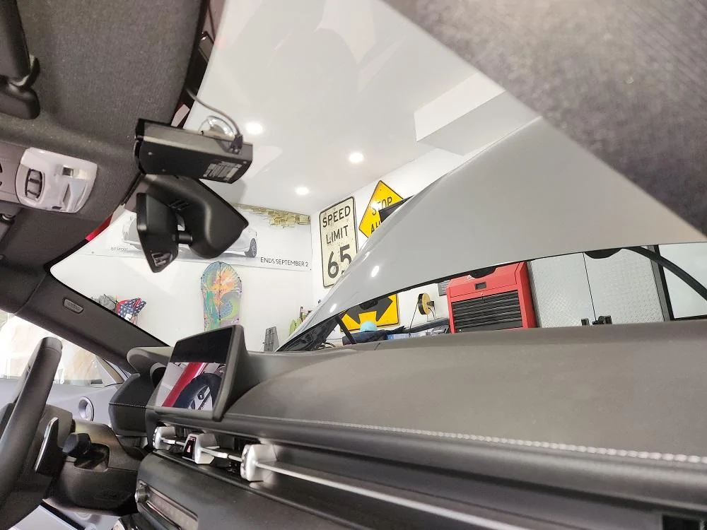

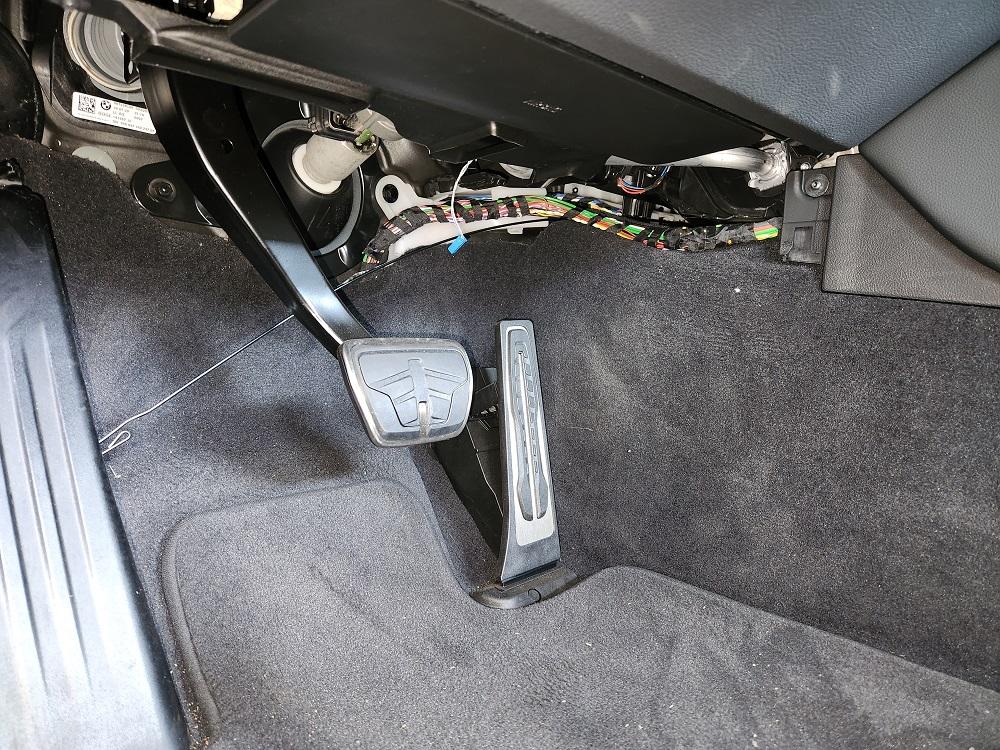

I finally installed mine today.
I used instructions from this thread:
https://www.supramkv.com/threads/radar-detector-laser-jammer-installation.2040/page-4#post-73858

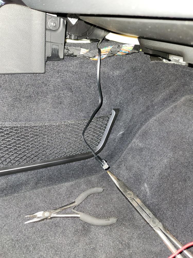

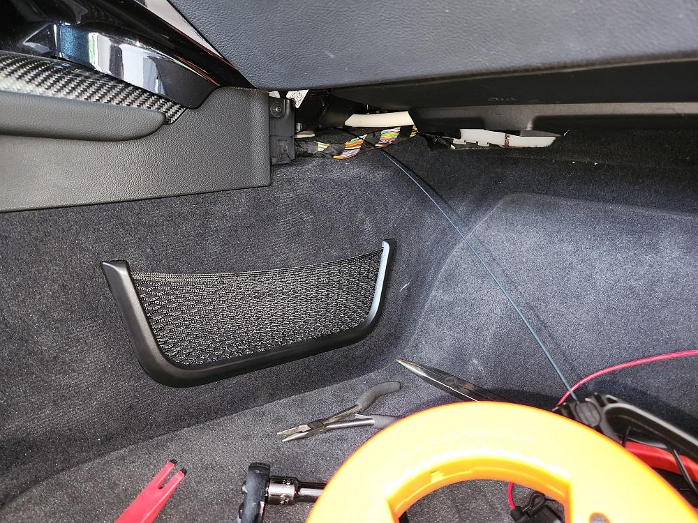

I didn't buy a tape a fuse, I just got a new fuse for the empty 47 slow and wrapped the positive wire around the fuse terminal - did this in my other cars and has worked for years.

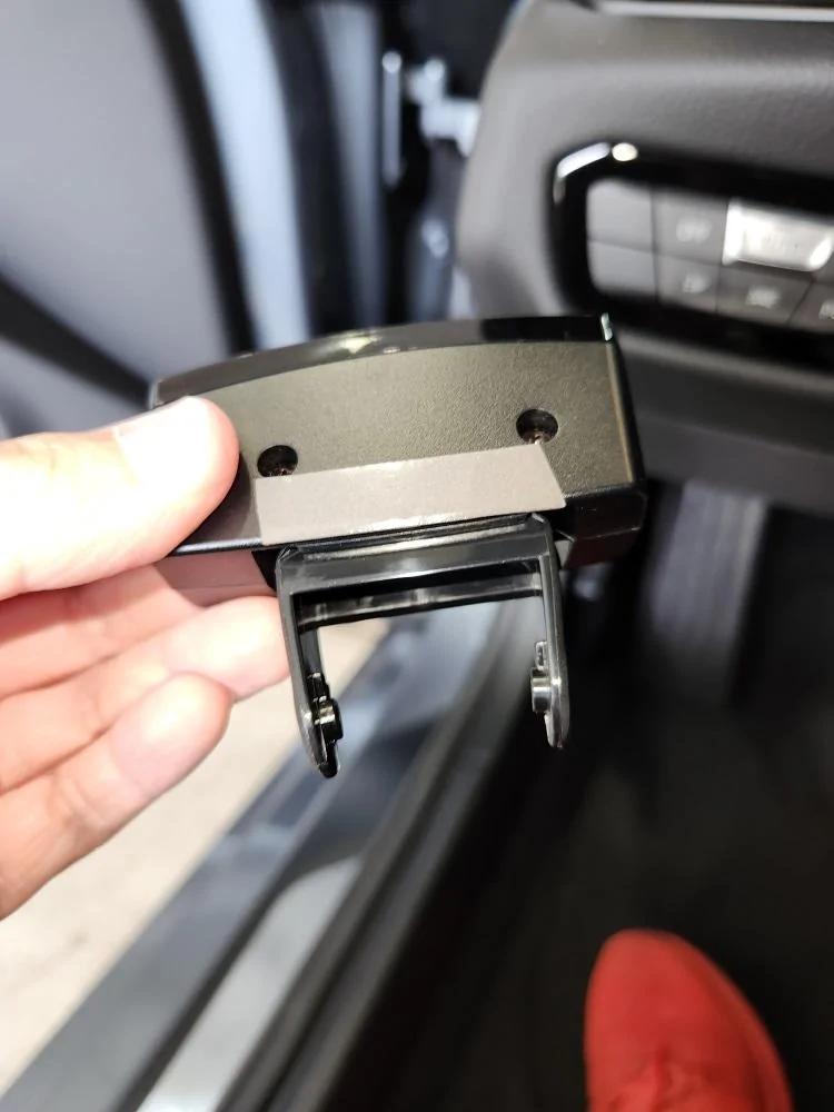

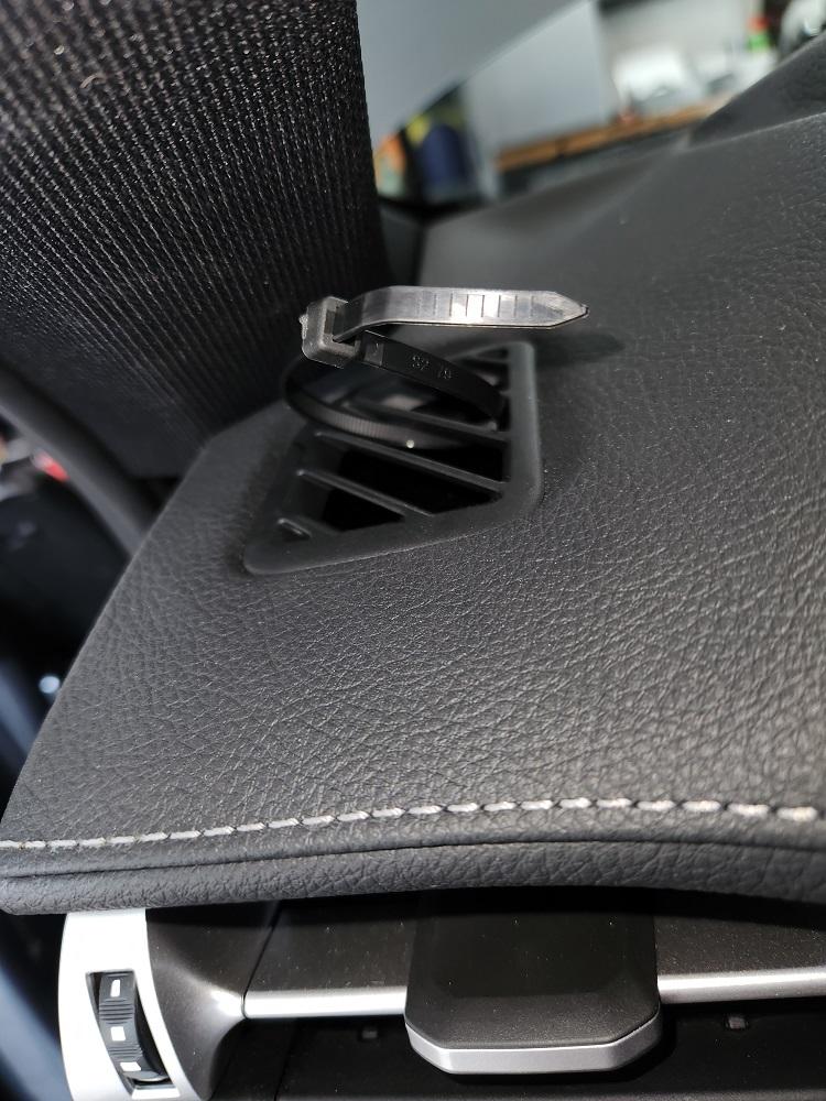

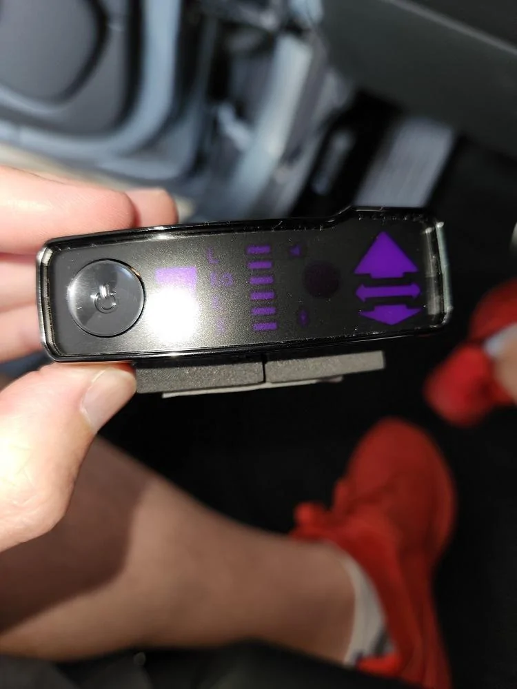

Just ran wire to the detector and then the other wire for the concealed display down across bottom of car and mounted the display to the vent - if the vent gets messed up I can buy another one - they are cheap.
I used foam and double sided tape along with a zip tie. I put some small foam against the interior trim A pillar -I was thinking it might rub, and didn't want to see it damaged.
I like the concealed display because your detector goes dark and you can shut it up or change modes on it from the display - This is how it is mounted in my other car so the continuity of use is great.
I hope this helps someone..pics below.

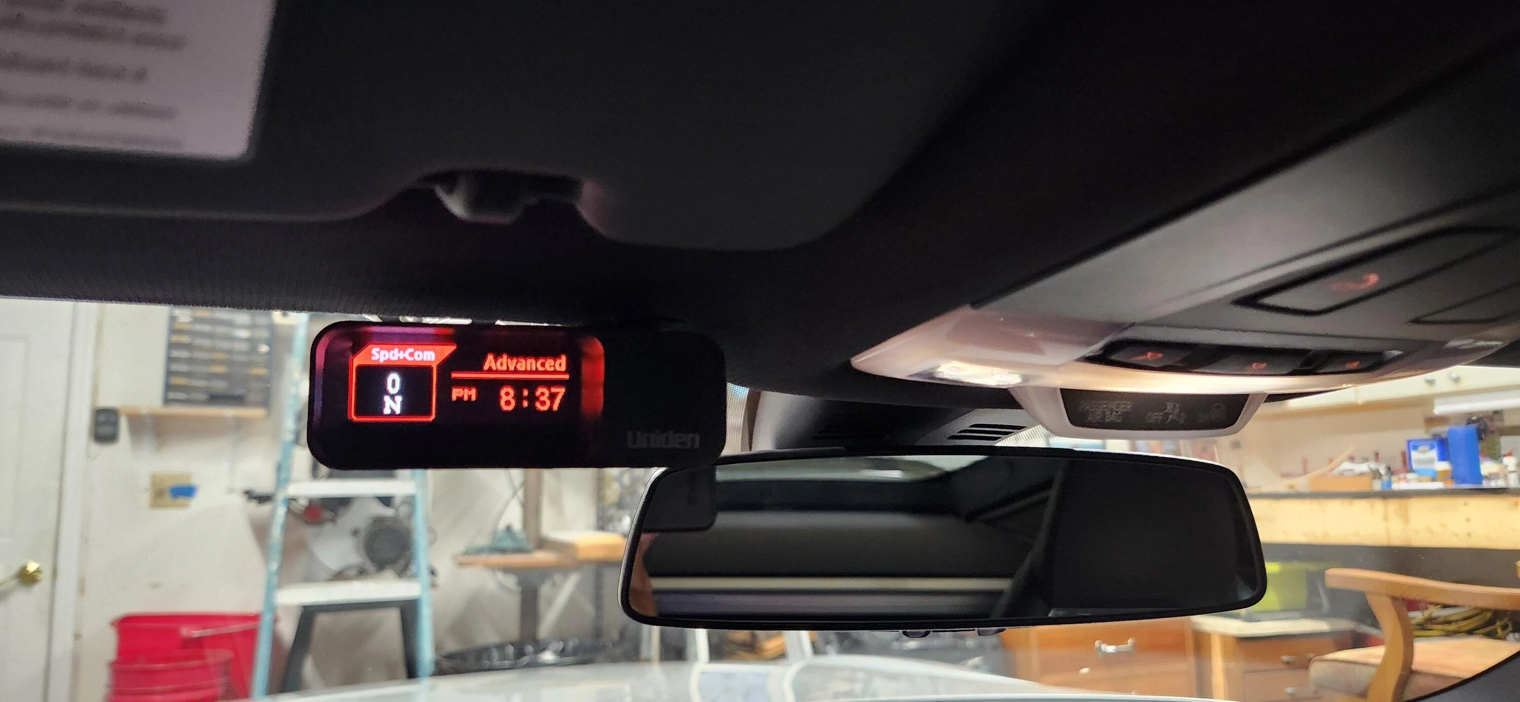

My Uniden R7 mounted quite nicely thanks to the help from kind members of this forum. I purchased the hard wire kit and wired to the 47 spot in the passenger fuse box.
No worries here in "free" Florida with law enforcement as detectors are legal.
