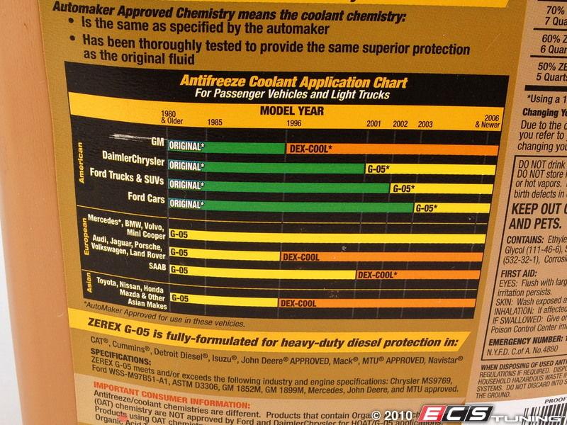

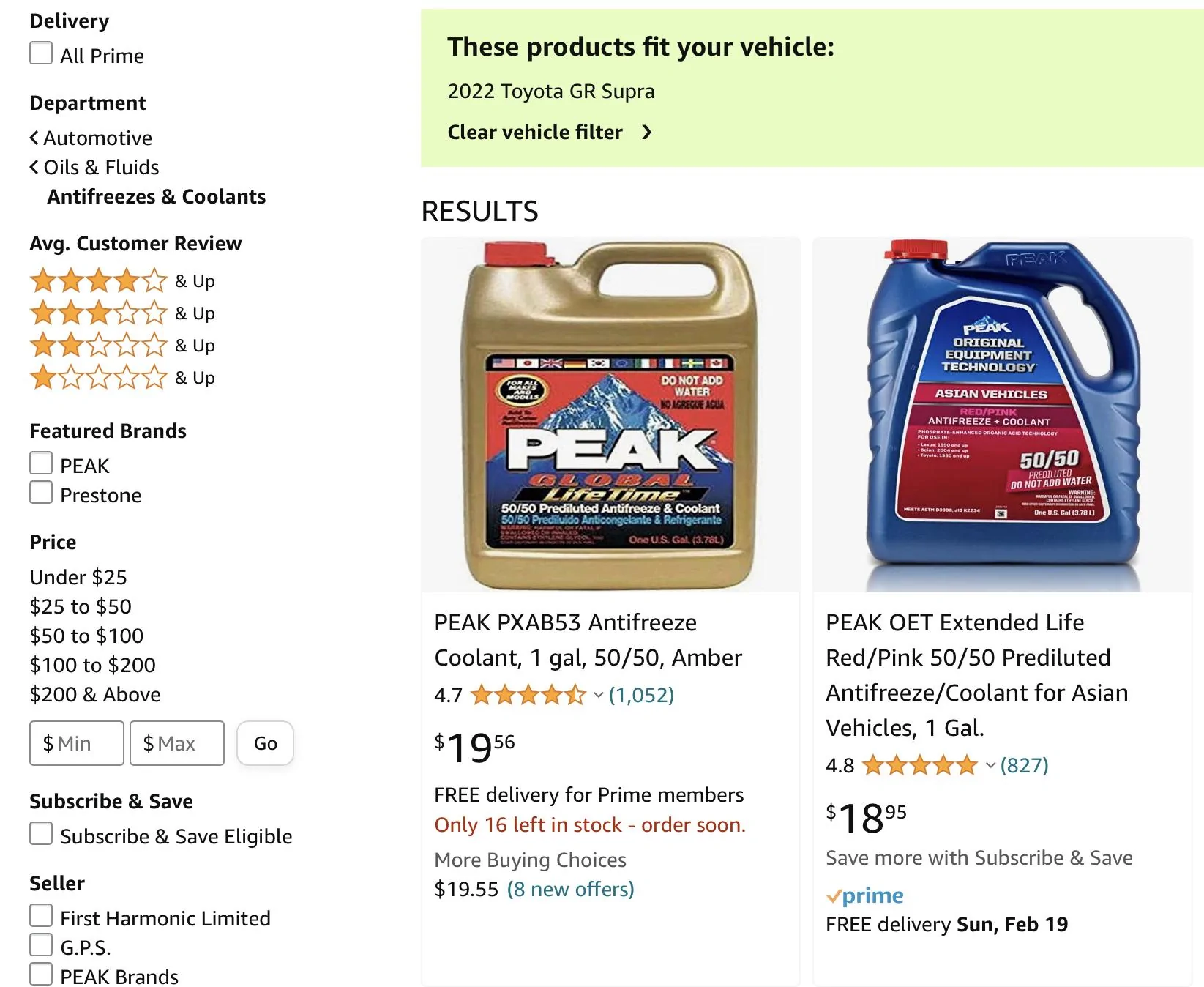

I’d use either one of these and call it a day:
https://spirecar.com/troubleshootin...ant-and-their-colors-dont-use-the-wrong-type/
Coolant types listed above ☝ and further explanation below ?
https://irontite.com/a/26-understanding-the-different-antifreeze-types-for-your-car
Most brands come with an easy chart to follow, depending on the brand you want to buy.
Bmw Specific Coolant Details:
